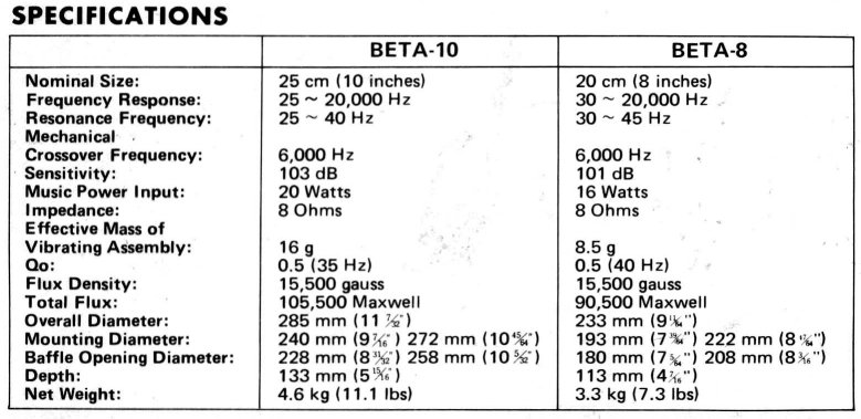

As my driver is no longer in production, the T/S parameters are hard to find. But I have managed to find 2 sources, however, they are slightly different. One one them is in the attached file, the other is listed below:
Impedance: 8 ohms
Max input power (music): 35W
resonant frequency: 37Hz
frequency range: 37-20khz
SPL: 95db/w-m
flux density: 15,500 gauss
total flux: 90,500 maxwell
weight 3.3kg
effective cone radius (a): 8.3cm
Mo: 8.5g
Qo: 0.5
I have a feeling the measurement parameters may be different...

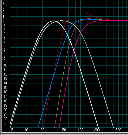

Ok managed to sim in WinISD (although it was a bit tricky to deal with parameters and they are probably not 100% correct).
What you have now is a box tuned to 47 Hz which gives you a big bump in the response (red). If you block one vent, it tunes closer to 30 Hz and you get a better looking response. This is shown in orange with an 80 Hz highpass.
The Rythmik kit is shown in white and grey with different xo point.
Blue is sealed with no filter
Magenta is sealed with 100 Hz high pass

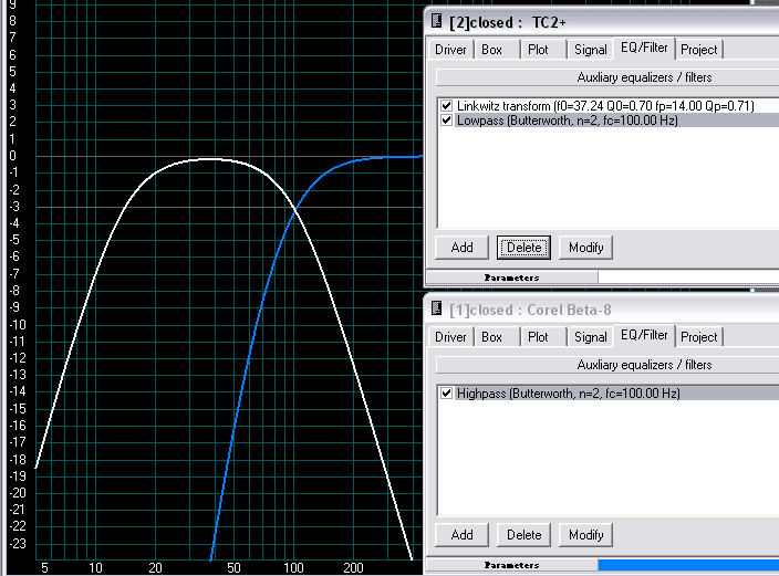

pengboon, are you using the pro version of WinISD? That allows you to add filters and see their effect, and compare multiple setups.
Leave Q value blank for filters
This is what it should look like (see attached)
For the Rythmik, just take a driver like TC2+ and put a linkwitz transform and a lowpass filter on it.
Given that this is a 2nd order xo, you should cross where both HP and LP filters are at -3 db. This should be 100 Hz.
