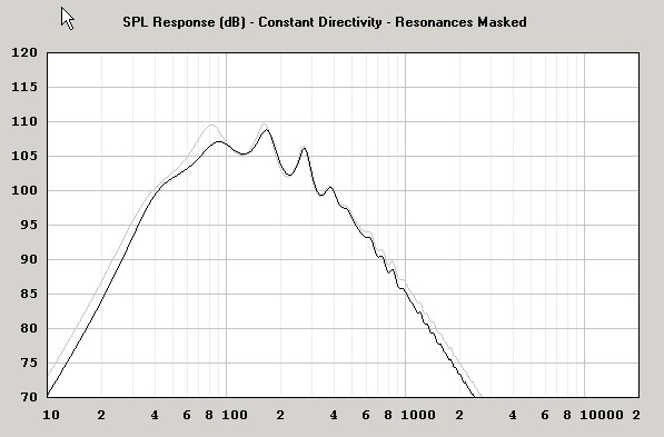

RT-2 Horn sub, the result
According to the simulation I've done, there's plenty of headroom with regards to max excursion all the way down. Currently I don't even have the amp power available to take me near the damage excursion limit.
And no sir, the rear chamber is 100% tight, the carpentry work was at least one thing I got reasonably right with this project so far! :D
Now, If I can just get that SEAS woofer in there...:smash:
.. And in it went...
Well, that was a remarkable difference, suddenly the basement was back in the music!
Allthough there is probably still some room for improvement with proper equalisation and X-over adjustments (and perhaps an inductor), the Horn now seems to go just as deep as the old BR woofer, so that proves that I screwed up on woofer selection and that the horn has true potential given the right driver.
Too bat in a way, that Eminence driver was just soo sexy looking with that big fat magnet and everything! :)
Enclosed is a hornresp sim based on the horn profile provided by Bjorno was kind enough to share. The gray curve is the result with the 27 Hz Fs SEAS woofer.
http://www.seas.no/images/stories/vintage/pdfdataheet/h172_and_179_33f-wb_and_dd.pdf
The graph shows a somewhat improved low end response, but the audible result was certainly more dramatic than what the simulation plot suggests.
So, goodbye High Fs PA midwoofer and welcome lo Fs HiFi Sub!
but then there is a new problem, the main speaker will want it's woofer back, and I need to find something equaly, or even better, performing to go in the horn...
there are a number of super-low Fs monster woofers out there (a lot of them with very poor efficiency it must be said).
What worries me a bit is that most of these woofers have very heavy cones.
The original article warned against using woofers with heavy cones just like it advised the use of low Fs drivers..
Hmmm..
but now that I've got an improved hornresp model and have performed some practical experimentation correlating simulations with real life results, this tool might be a bit more usefull for selecting a new woofer.
I must however change my conclusion from "disappointing" to "really promising" :cheerful:

Nice to hear we were on the right track, and you have done good work to prove it, makes it meaningfull to be here
One reason your Seas works subjectively better but really dont measure that much different could, besides the lower Fs, be due to different and higher Qts
A 10" SB Acoustic may be a good choice, but its not the cheapest, 212 EUR from IntertechniK
They also sell the US Dayton, and the 10" RS270S cost only 99 EUR and is said to be real good value
The Dayton has 12mm Xmax which is ok, unless you play exstremely loud
The SB Acoustic is a real performer in terms of Fs and Xmax
I have never heard any of them, just fore inspiration
This thread has certainly been useful so far!
One thing is theorizing and discussing, but the real fun part is to do some practical experiments! :)
Some of those drivers look interesting, but I'm more on the lookout for a 12" driver as this is what the horn is dimensioned for.
Just did some more hornresp sims, and I the general trend seems to be that low Fs woofers with heavy cones generate very uneven responses.
Having said that, the low end extension seem to be better, so it might be that there is an inevitable inherent compromise there.

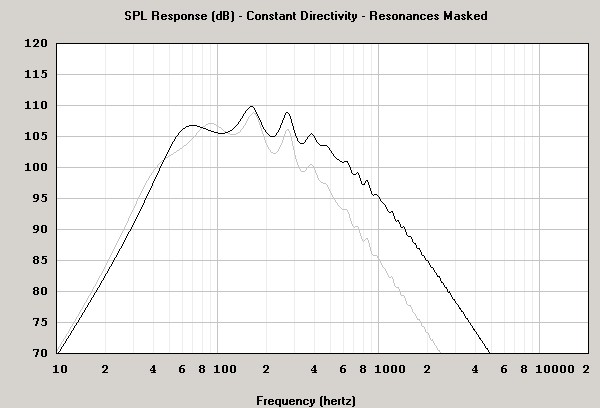

Seems like this is transforming in to yet another driver selection thread..
As I started searching for low Fs/ low Mms drivers, I came across A Visaton Driver called W300S..
http://www.visaton.com/en/chassis_zubehoer/tiefton/w300s_4.html
Again, I tried a Hornresp sim, and the frequency plot seems to suggest an improved low frequency response over the SEAS 13" (se enclosed image)
I also compared it against the response curve for the gamma, and it performed even better than that.
Anyway, what I do notice when I look at all the plots, are all the ripple sin the response, which to me suggests that the horn is acting more like some sort of quarter wave conical horn (voight) or a transmission line than a true horn.. But still, the efficiency numbers are quite high, at least compared to direct radiating drivers in closed or BR enclosures..
