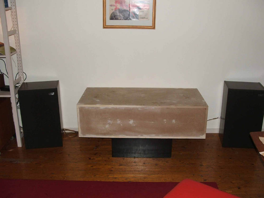

Unfortunately, I don't have any means of making any measurements, so all I can do is to listen and compare with my old sub..
Regarding extending the horn physically..
In the articles published in this sort of horn in 1973 (then with 10" driver), there was an illustration showing the horn flanked by two furniture sections standing on legs at the same height as that of the horn floor.
This was said to extend the low end response noticeably. Would be interesting to try..

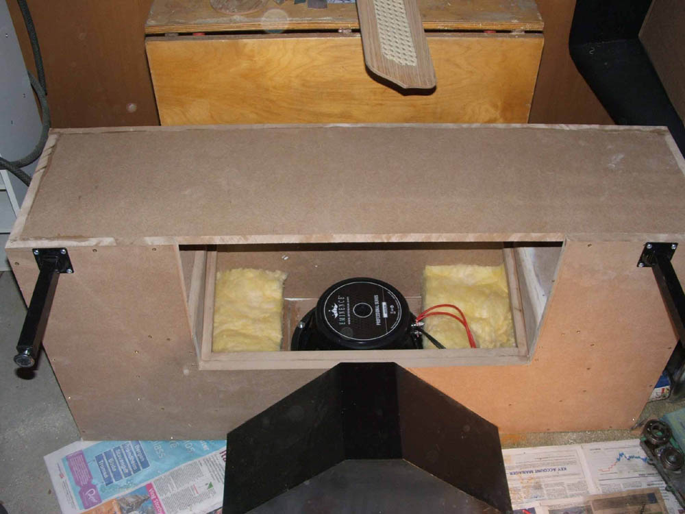

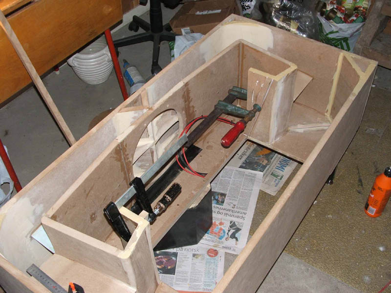

Well, I'm keeping the horn, and since, after reconsidering driver selection philosophy, it turned out to be great sounding. (been listening through some records now..), the next step is to fit the driver properly and give the thing a nice veneered finish.
And since it was eventually sucessfull, I'll post some construction pic's for the benefit of any other that might wish to give it a go! :)
