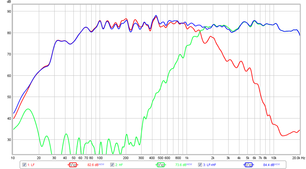

miniDSP Tests
Here is a first cut with a miniDSP. I am using electrical LR2 at 1500Hz low pass on woofer and 1700Hz high pass on tweeter. Strange that there is no cancellation dip - probably because the acoustic shape is not textbook symmetric LR2. A -11dB padding was applied to the tweeter in the waveguide to level match the RS180P. I am using the 4-way advanced plugin, some mild EQ (negative cut only) was applied for shelf and notch filters in a few places.
XO plot:

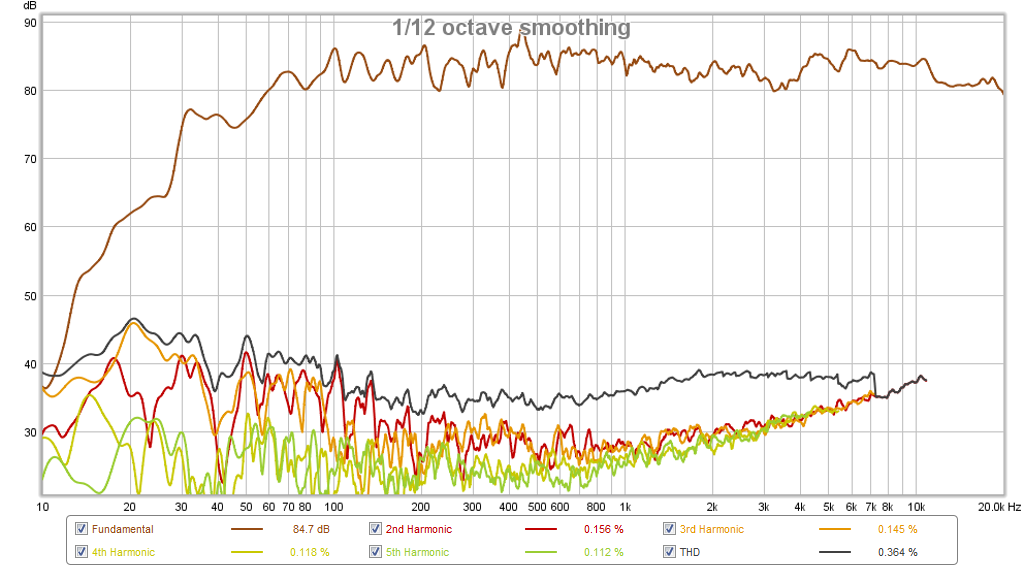

HD plot (2kHz bump is not so bad):
XO plot:

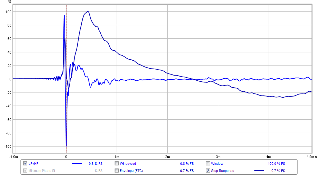

Impulse and Step:

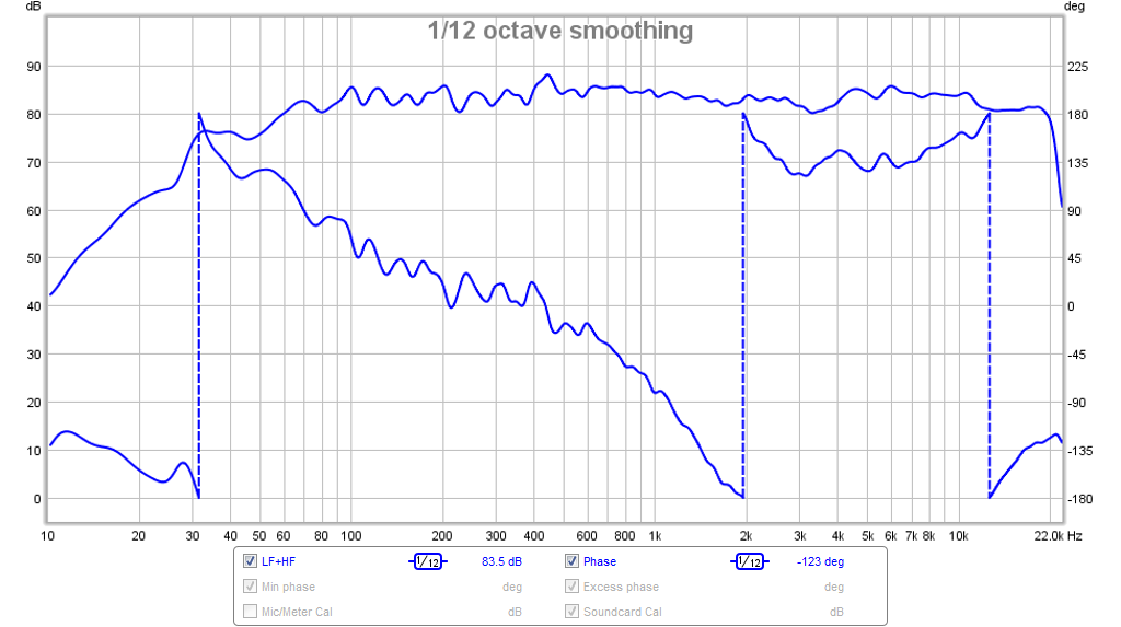

Phase:

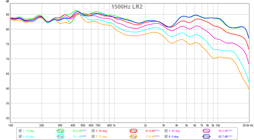

Here is a very rough polar from 0 deg to 75 deg at 0.5m with the above XO. Data presented with 6-cycle frequency dependent window gating (FDW) to remove effects of reflections:

That explains why there is no cancellation hole at the xo point. It's going to be important to build the xo following a textbook LR2 overlay.
I don't understand that this. Just use the filters that give you the acoustic response you want.
The reason to follow a textbook LR2 is so that a hole can be filled by the mid perfectly - at least the math works out like that. It's quite elegant anytime you can show that a complex set of math equations with a solution that equals 1.
More here:
http://www.diyaudio.com/forums/multi-way/88135-filler-driver-ala-b-o-3.html#post4376492
But the results you show don't follow a "textbook" LR2 response in any way I can see. So I'm not sure whether you're referring to the electric filter or the final acoustic response. The final response is all that matters, so since you don't have that, one of us is confused on how to make the filler driver work. BTW where is the filler driver going to go, I only see a 2-way speaker?
What I am saying is that since all I did was apply an *electrical* LR2. The acoustic crossover may be closer to third or fourth order, hence there was no cancellation for two positive phase drivers. To do the hole filler properly, you need to apply an electrical filter such that the acoustic crossover follows an LR2. That's why I said I will need a textbook function overlay to tweak the minidsp electrical function.
I haven't built the mid hole filler upper baffle and rear chamber yet. It's mounted externally and can be added once I demonstrate a symmetric LR2with cancellation dip. My 3D printer is down and I need it in order to make the waveguide and baffle for the mid.

Thanks for that. Several members (Byrtt and others) are doing precisely this, using LR4 and the FIR to correct for phase wrap to end up with transient perfect response. I am using IIR DSP to test out conventional causal filters and then implement in hardware via passive coils/caps/resistors.
I have similar procedure: flatten native response for 2 octaves above and below xo point. Then apply electrical filter to get actual acoustic response to match textbook curve like LR2 or BW2 etc. smooth wide strokes, leave narrow dips alone (can't do anything in passive). Aim for flat minimum phase.

I have spent a few hours listening to this speaker as an active 2-way with minidsp as the XO and I must say it sounds quite nice despite the higher than desired H3 at 2kHz. As can be seen earlier the H3 at 2kHz doesn't really show up in the measurement when a crossover is implemented.
