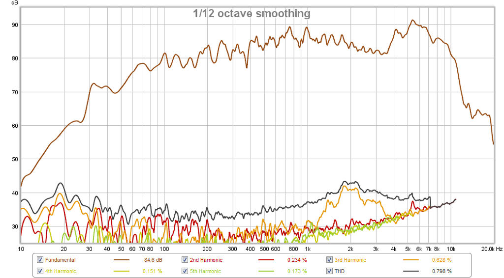

Thanks for trying to help me understand this guys. But, I am still not quite getting it. A breakup mode at 6kHz occurs at 6kHz an not before. How is the shape of the breakup at 6kHz (which hasn't happened yet), mirrored in the distortion products from excitation at 2kHz? I am going to have to read up on this but it's not ever been apparent in my other drivers. RS225-8 doesn't exhibit this. I mean this is low level 1v rms - shouldn't be seeing anything.
It's not a sub-harmonic, it's straight-forward HD. If you have a fundamental tone at 2KHz, your 3rd harmonic will be at 3KHz. Now if you have a peak in your response at 3KHz, you will correspondingly have a peak in HD3. This is exactly what we are seeing. HD is a function of frequency response, and other things too of course.
Try going over to Zaph's place and comparing frequency response with HD3 and HD5 for various drivers. Some show it very clearly, others less so.
There's no error in your setup. To get round this problem, you can either cross very low, or apply some sort of cone/surround damping to ameliorate the break-up.
Shouldn't this read 6 KHz instead of 3 KHz? The 3rd harmonic of 2 KHz is 6 KHz, right?
Like this plot shows:

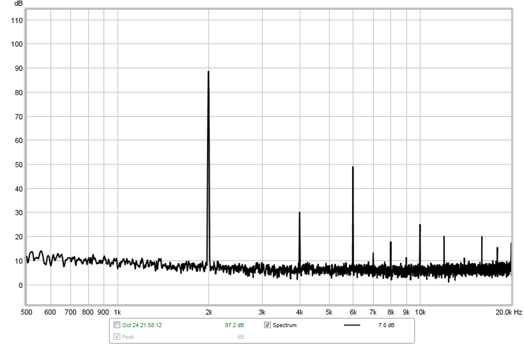

Exciting 2 KHz, gives a small 2nd harmonic peak at 4 KHz, and a big 3rd harmonic at 6 KHz.

It isn't occurring at 6 KHz. Each time this driver plays a 2 KHz note, the cone "sings" at 6 KHz. That's what your IMD plot shows as well. REW shows you the normal FR plus the note "sung" by the cone at 6 KHz (which was a by-product of the 2 KHz note it played). REW just adds it in the plot, that's why the peak in FR mimics the 3rd order distortion.
So as long as you excite 2 KHz, it will play a pretty loud note at 6 KHz simultaneously.
It is happening because the HD3 of 2KHz is a 6KHz signal.

I get it now - the cone generates (or sings) content at 4kHz and 6kHz when excited at 2kHz just like the RTA plot shows.

My measurements of the RS100 show a spike in 3rd harmonic distortion at 5khz which corresponds to the peak at 15khz. X, I don't remember what your distortion plot looks like for that driver but I imagine you must have found something similar...
I will have to take a look at that data again but missed it the first time. If you saw it then I guess this is common.

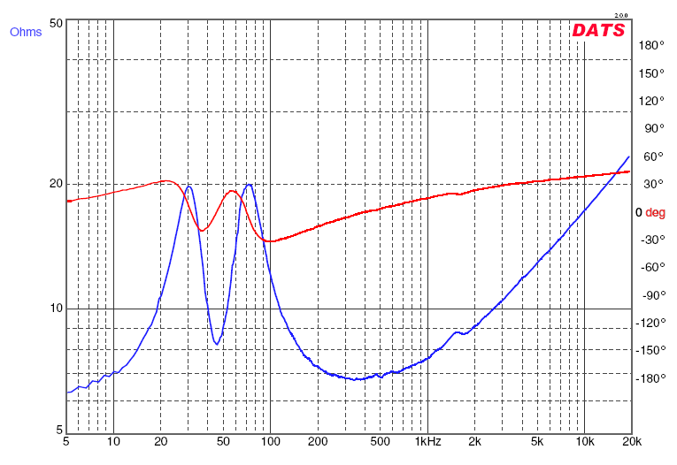

Impedance measurement of RS180P and PR
Using DATS I get the passive radiator tuning frequency as 45Hz, very close to the simulated prediction of 44Hz. There is a squiggle right near 1.7khz, probably the transition of the cone from pistonic to bending modes.

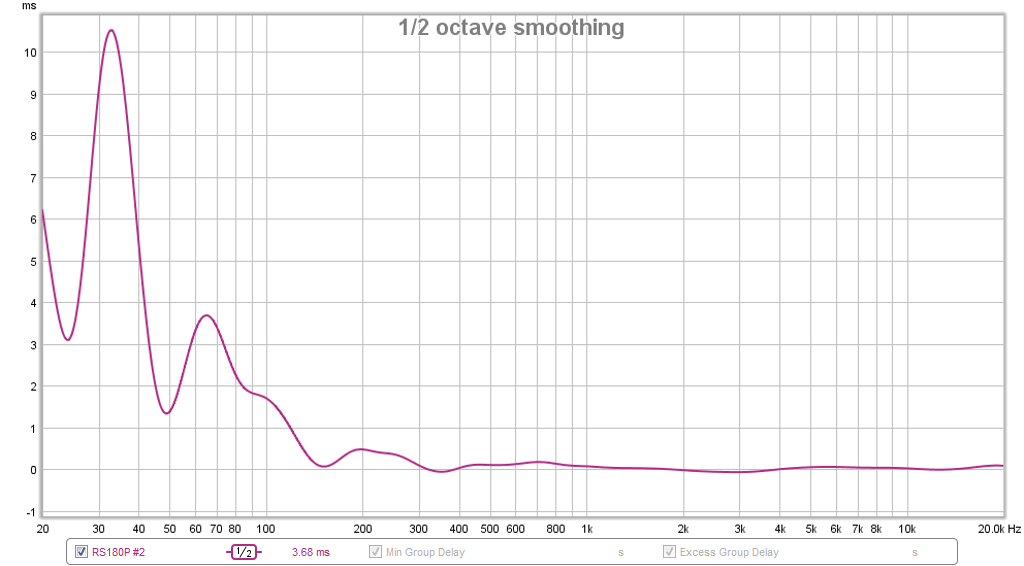

And here is the measured group delay (1/2 oct smoothing) showing a very nice result - although climbs near 30Hz, not much output at the frequency:

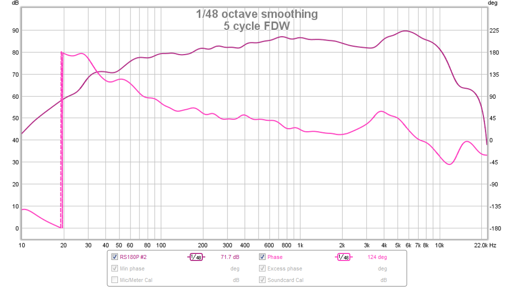

And here is the measured phase with 5 cycles FDW applied:
The wiggle in the impedance is almost exactly where the peak of the distortion spike is.
Be careful of the very hard paper cones as they act just like metal and have very pronounced breakup. Look at the difference in crossover troels used on the SB61 speakers for the different cones. 4th order was needed to suppress the breakup on the hard cones.
I know you are designing for passive but for a test use your minidsp to try a few crossovers points and slopes and measure the distortion with the crossover in place if you can drop that area by 6dB then it is likely that it will almost go below the overall distortion curve. It might look much better then.
