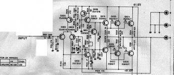

Redrawn Schematic Rotel RB850
Here is a redrawn schematic of the Rotel RB850 and part list:

gni said:I recently contacted Rotel about a schematic for the RB-850 and
they sent me one. . . let me know if anybody needs it. . .about 4MB.pdf
Hi Chris,
Very kind, you have mail.
New Bias Resistor and trimpot
Against anatech's advice (sorry) I did install the multi-turn bias pot.
For the 'reason' that the amount of DC current in the circuit through
R619+VR601 is very small. The measurement across these two
devices is the same points as the voltage of (be).
Left Channel:R619+VR601
Right Channel:R620+VR602
Left DC offset: +31.8mV
Right DC offset: +24.4mV
The old circuit path was R619 = 2.7kohms.
The new cirucit path is R619 = 3.58kohms.
The old VR601 was a 2.2kohm single turn.
The new VR601 is a 500 ohm multi-turn.
Spec is at 4mV across the 0.22ohm output resistor for 18.2mA.
Left
R619+VR601=3989ohms with 154.2microamps (615mV)
VR601=408.6ohms
Right
R620+VR602=3872ohms with 157.8microamps (611mV)
VR602=291.5ohms
Spec+8mV = 12mV across the 0.22ohm output resistor for 54.5mA
Left
R619+VR601=3752ohms with 162.6microamps (610mV)
VR601=172ohms
Right
R620+VR602=3670ohms with 165.9microamps (604mV)
VR602=90.4ohms

hi
i did the 100uf bypass caps on the diodes and i got 6db rms improvement on noise floor.
and yes higher thump noise on startup but not big deal.
few years ago i did recap, ufast diodes ,non magnetic resistor ,bourns bias pots.
now this mod and little higher bias gives big improvement in sound stage.
thanks all.
e.g the mods is on rotel rb960bx the amp almost identical to rb850.
