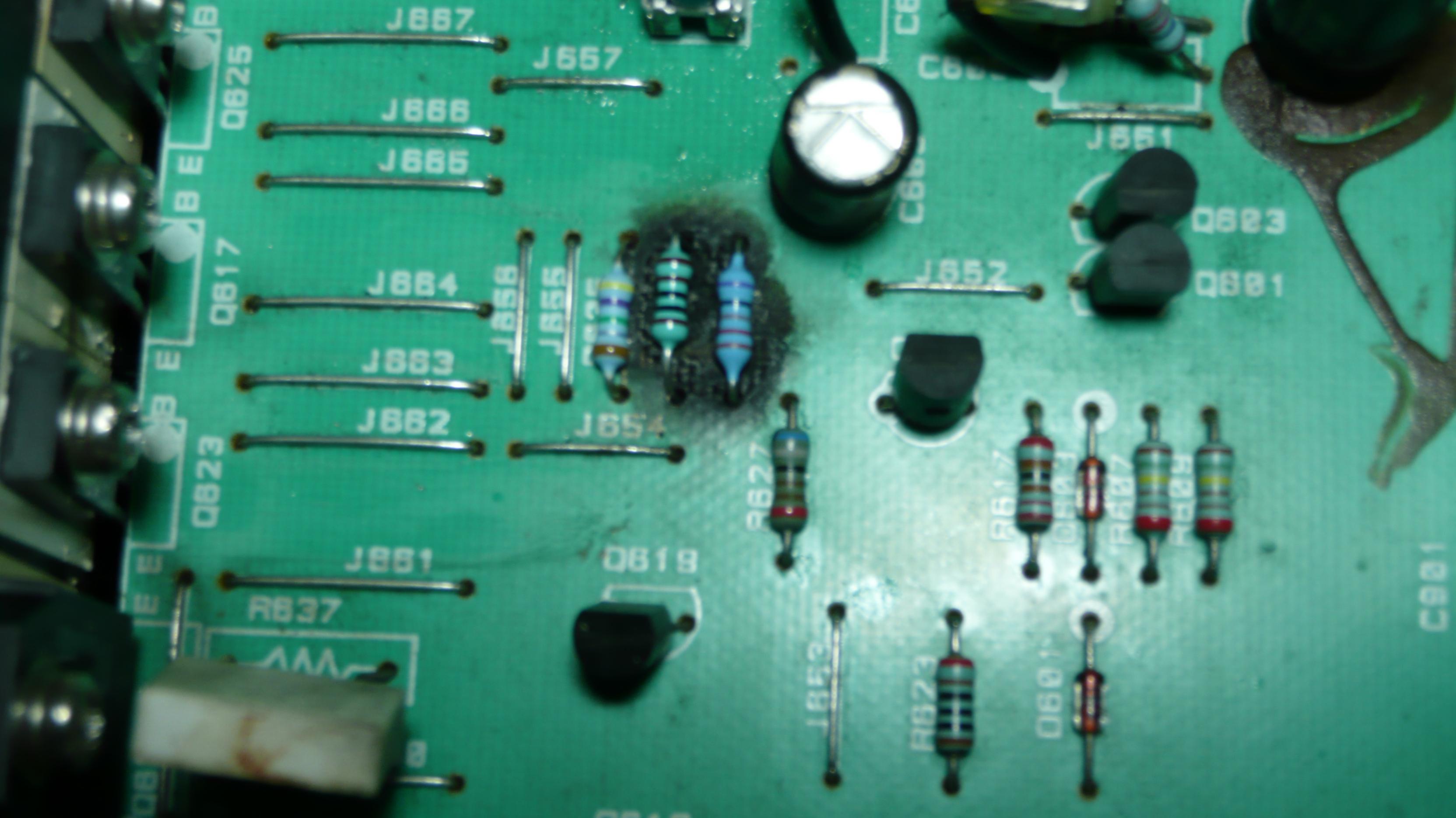

Another question. When I was given this amp I put a low value 2a fuse (8a is the normal fuse)in the right hand side in a naive attempt to test it. This side had no visibly burned components unlike the left channel which had the burned resisitors but it blew straight away. Does this mean anything for the diagnosis?

If you talk about F981 and F982 from the power supply, and if you did this check you described above, then it's normal that the fuses blew. These fuses are protecting both power supplies, left and right channel. After you repaired the burned channel, this would be a good test if both channel work now. For this test you should use a slow-blow fuse at nearly the requested rating of 8A, since you have to charge 4x 8200µF in the power supplies and simply the inrush current can make the fuse blow.
Since you have dismount the board from the chassis, why not check the power transistors and the driver transistor from the other channel inboard for working pn-junctions (0,4-0,7 v voltage drop).

Fitted the new transistors on the left side only and replaced the resistors. Not soldered them in yet. Will do that tomorrow. Don't want to worry about it before I go to bed if it goes bang!
The blood on the white resistors is mine. I had cut my finger on a broken light bulb!

Q617 is the bias transistor, connected to Q613 and Q615. You will have to check these transistors,from there til the power transistors again and usuallly all other parts in this area on the schematics. Check also for shortage of the solder joints of the transistors , you already changed

The bias voltage transistor (Vbe multiplier) is a shunt regulator that sets the bias voltage to <<5V
It should never blow up.
Except if the transistors linking it to the supply rails have shorted.
You need to thoroughly check all the other transistors, BEFORE you next power ON via a Mains Bulb Tester.
