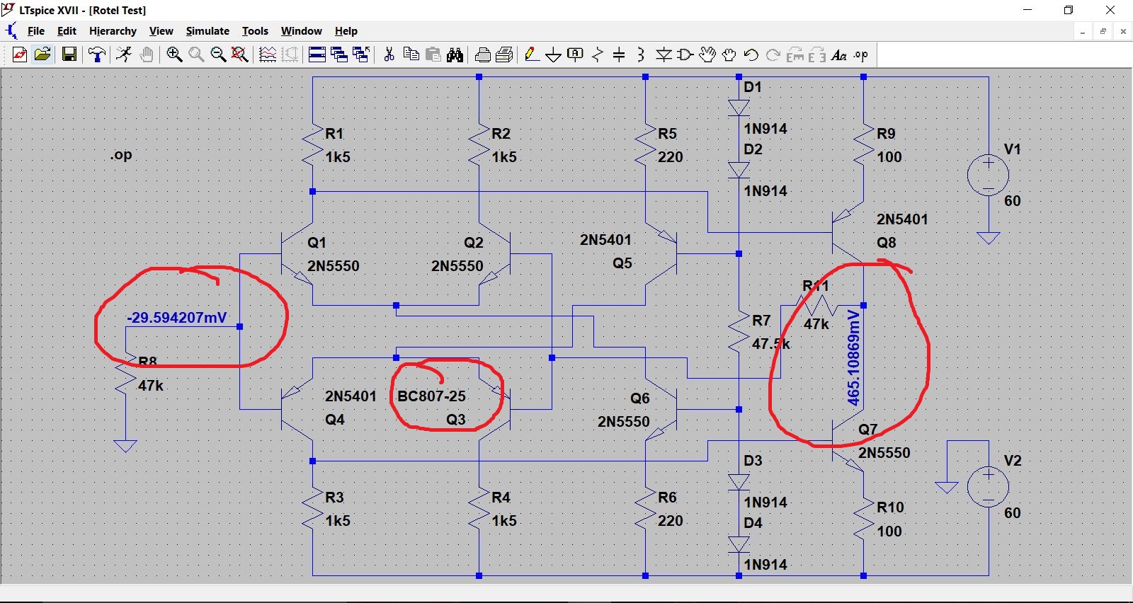

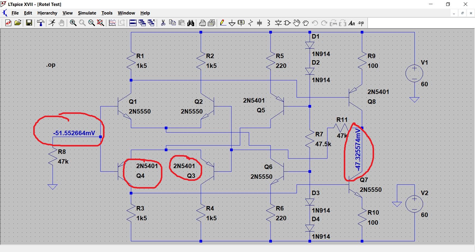

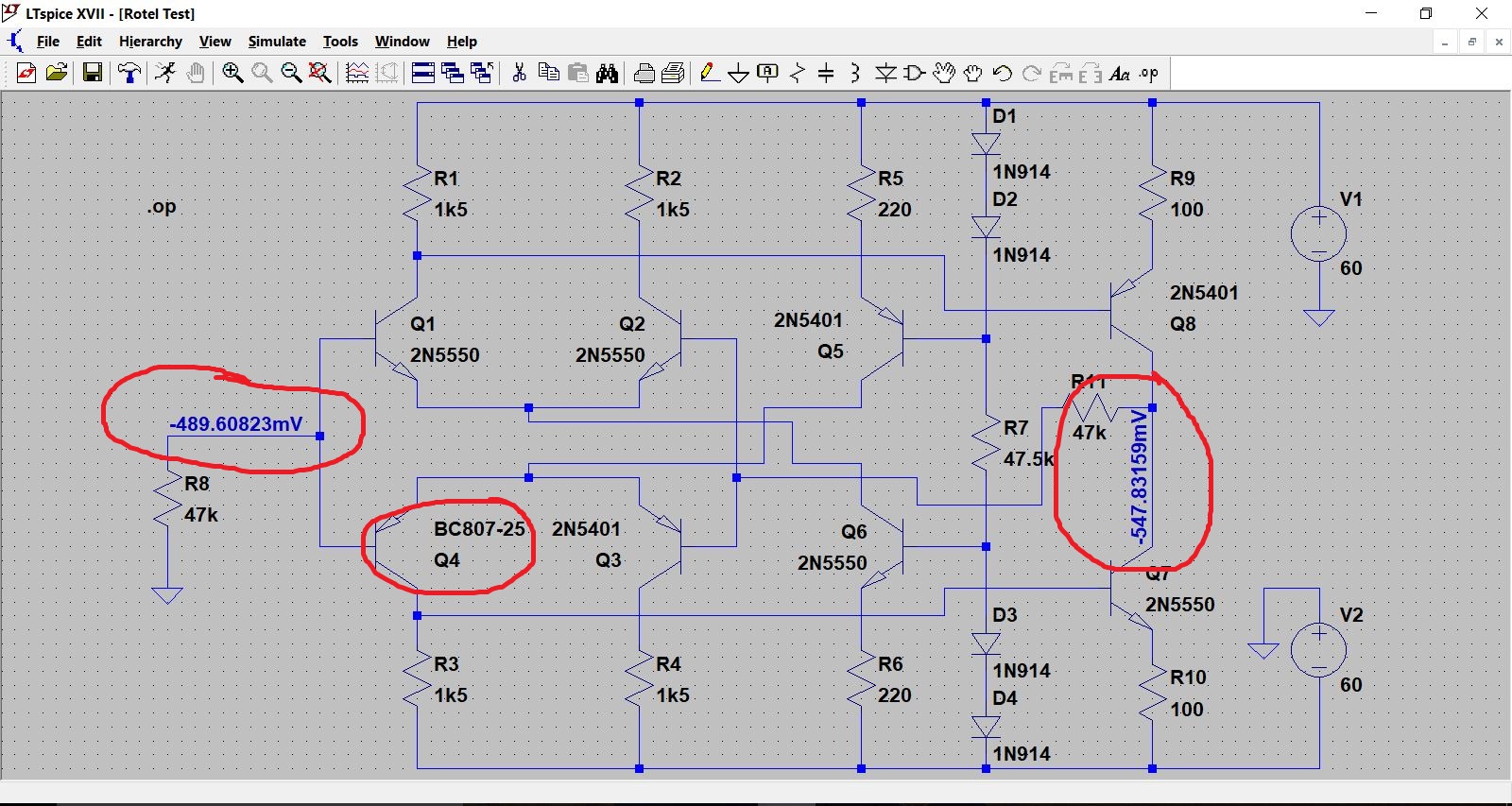

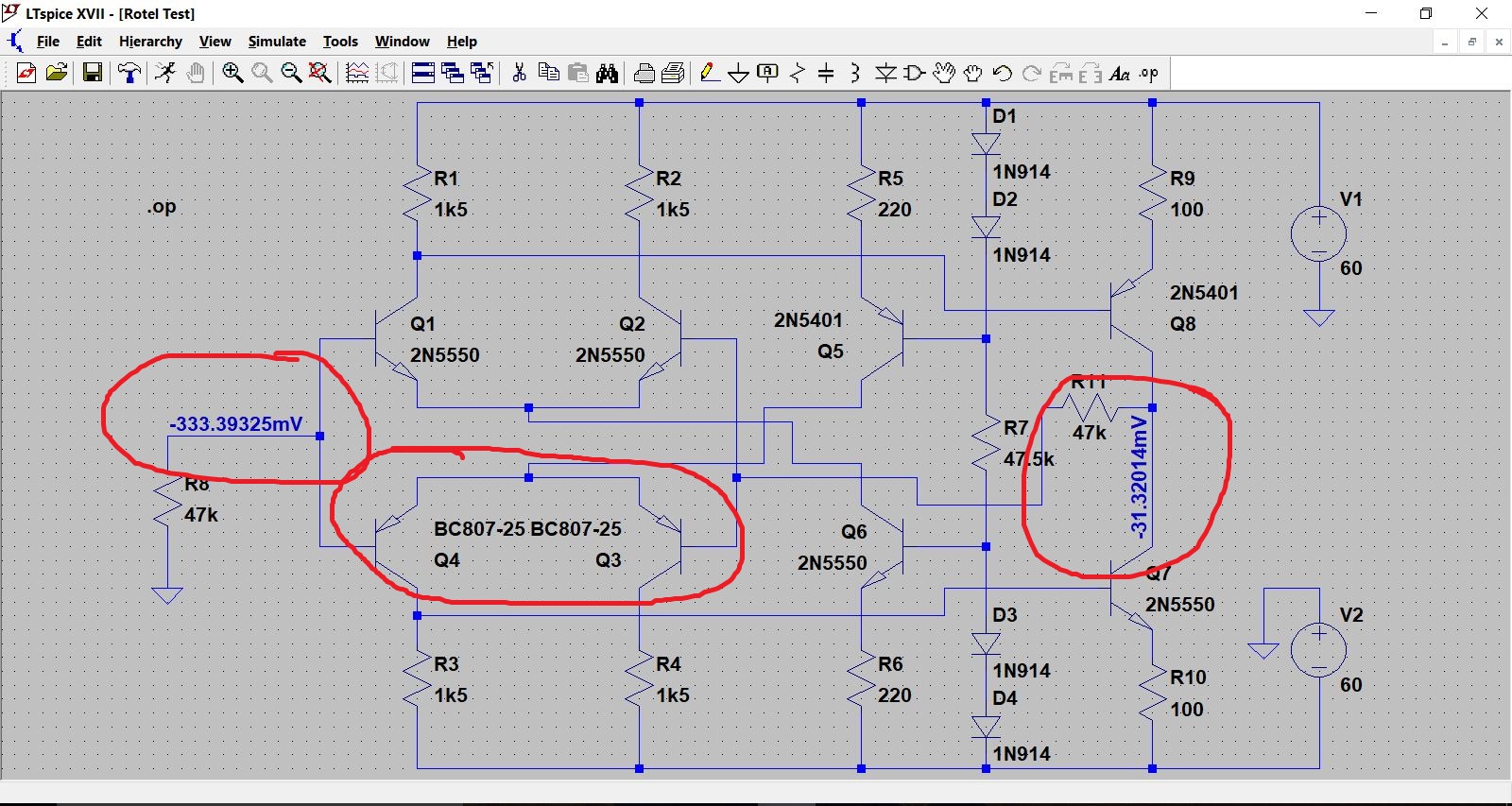

This is a similar front end from an old simulation. Look at the offset voltage and its polarity as the transistors are changed in just one of the pairs. In simulation, any device of the same number is identical to every other of the same type. 100% matched in every possible way.
Ideally this amp needs a manual method of tweaking the offset or a DC servo adding.

The two sets of long tailed pairs (the left hand four transistors). You could try swapping the two in a pair over and see if that gives a lower offset. If it does then see if it can be improved again by swapping the other pair as well.
Mooly, what do you mean by this? Which Q's?
