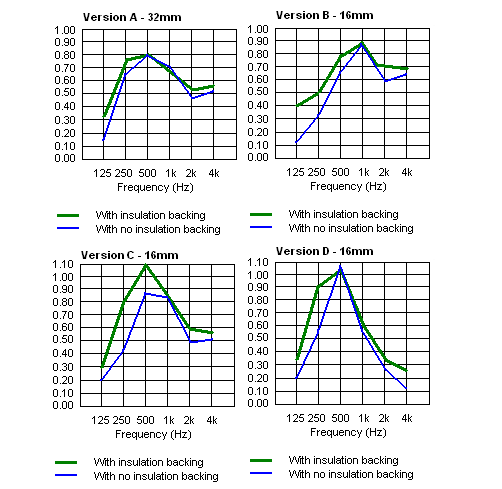

Want to panel a wall and make the paneling be a trap? Version A has a nice behavior for sucking out everything 250Hz-1kHz

That's one style. Another is just a box panel filled with some fiberglass with the front plywood acting as a drum can be an LF absorber.
