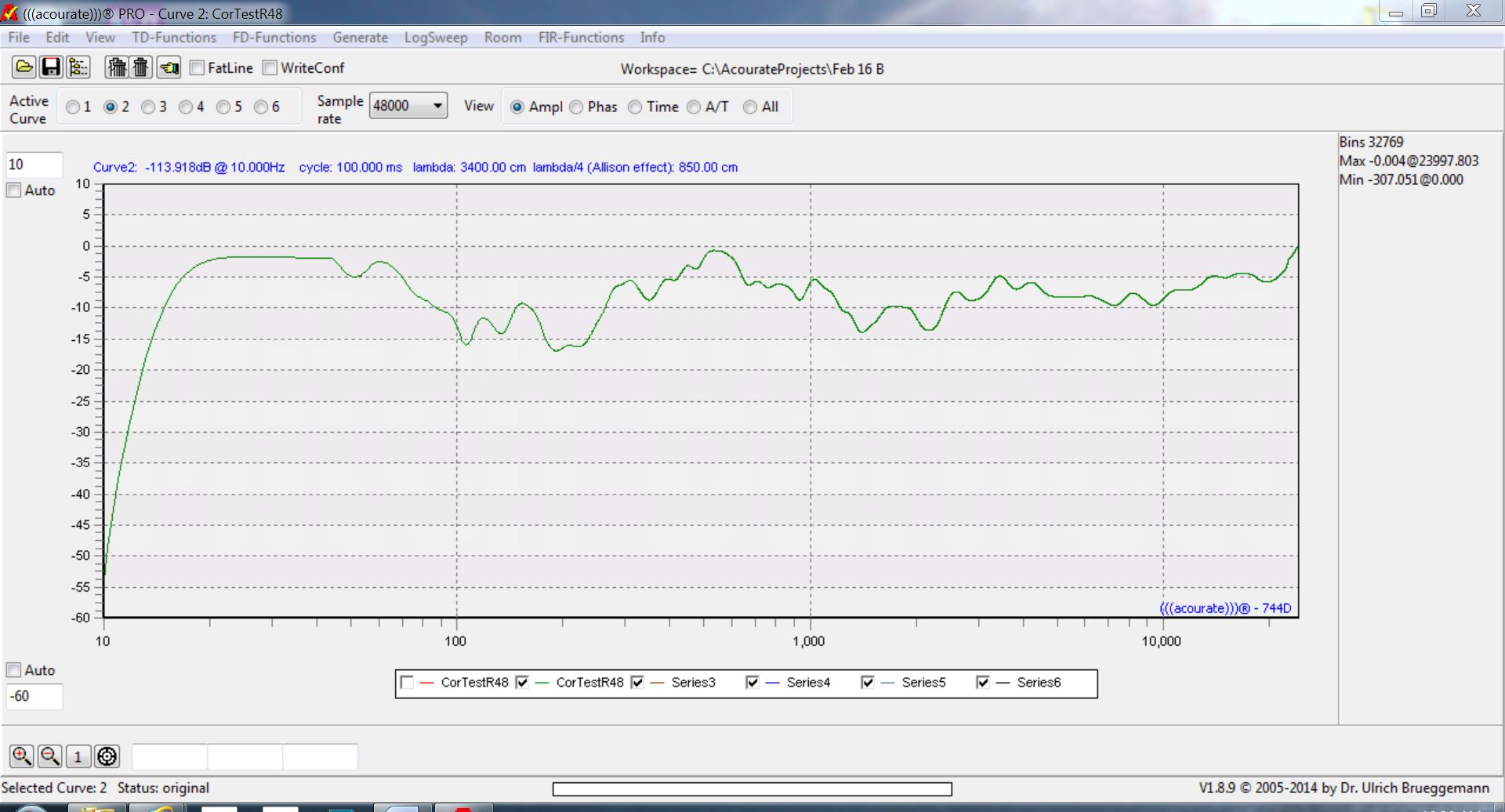

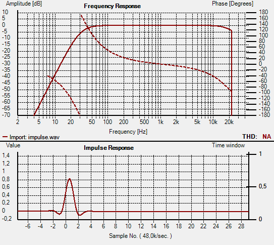

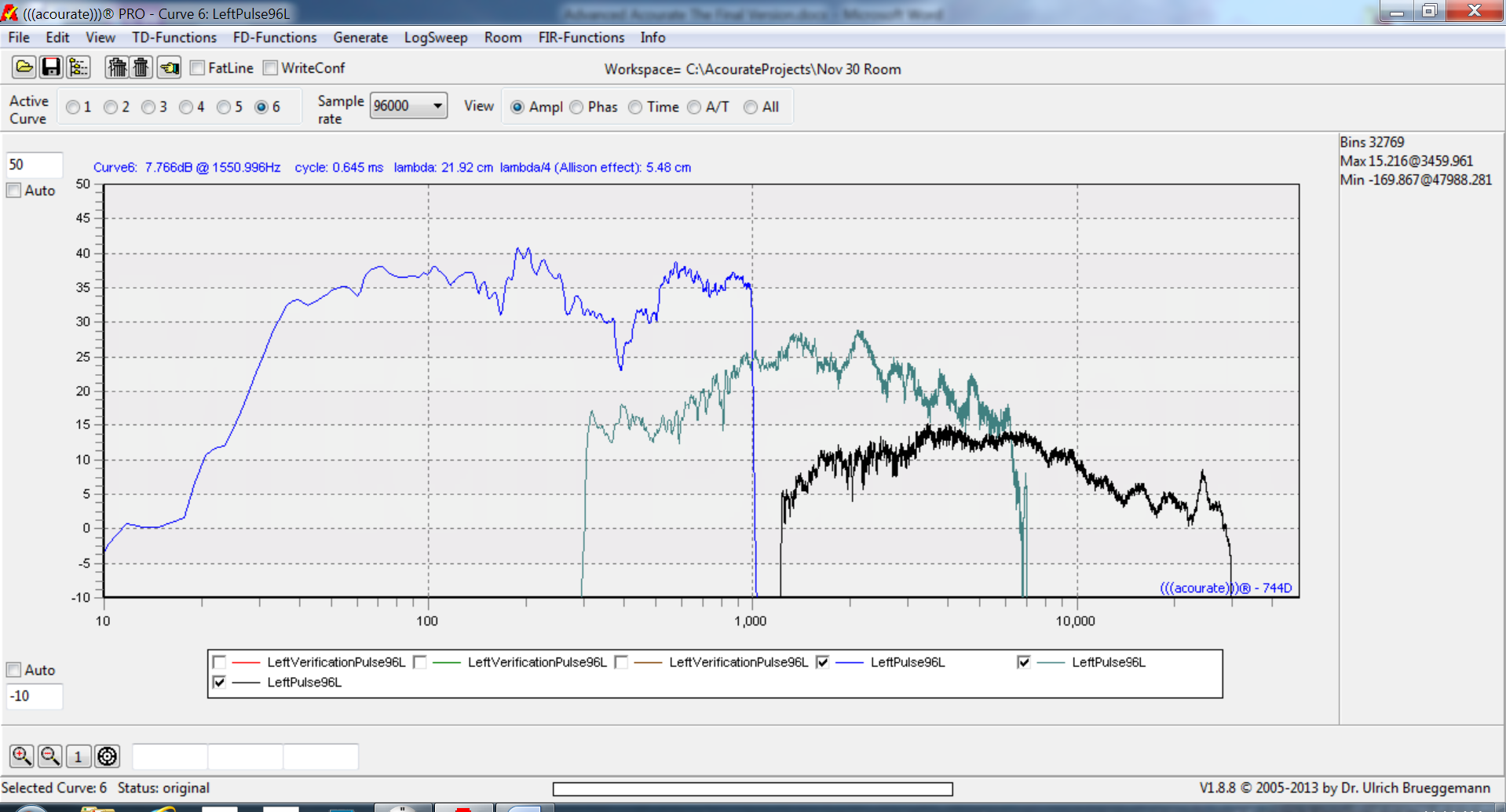

Those are two linear phase digital FIR *correction* filters generated by the Acourate design software after Acourate analyzes the measured acoustic impulse response of my speaker system. The green curve is with a 15 Hz subsonic digital filter applied.
There is much more to this which is why I linked to two articles that documents the basic and advanced step by step procedures. Reading the articles, one can see how Acourate works.
The linear phase digital FIR correction filter (green curve) is hosted in a software based runtime convolution engine (i.e. JRiver).

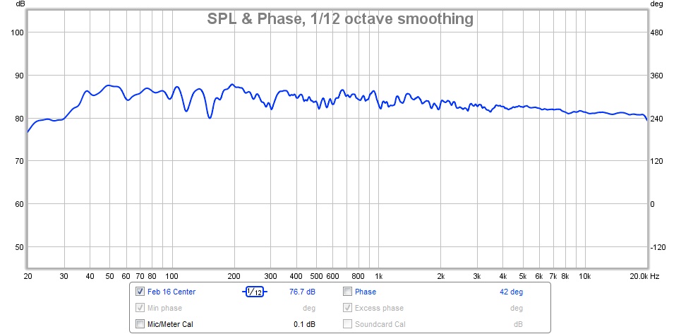

To see the acoustic result of the applied digital FIR correction filter, I used REW, with the mic setup at the LP, in which the swept sine wave is convolved in real-time with the linear phase FIR correction filter (the green curve) which yields the attached measured acoustic frequency and impulse responses (the blue curves) of my right speaker. My previous post documents the measurement chain. The REW mdat acoustic measurement file is here.
Reading the linked step by step guides walks through the process of measuring the speakers, designing the digital correction filters, which includes designing a 3 way digital XO, time aligning the drivers, and designing the room correction, generating the digital correction filters, and running a test convolution to see the predicted results. All in the digital domain.

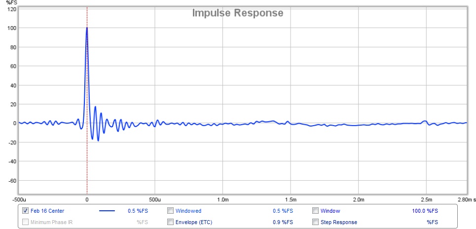

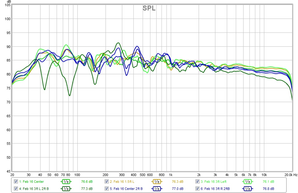

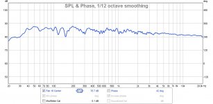

The REW acoustic measure of the right speaker (blue curves), with the digital correction filter (green curve) in the measurement path, confirms the correction filter is working as designed. And working quite well over multiple mic positions as I measured 6 locations covering a 6' x 2' (couch) area - overlay attached.
Following the step by step guides, anyone with the right gear can achieve very similar results to what I have posted. Or see how Acourate works and how I achieved these results.

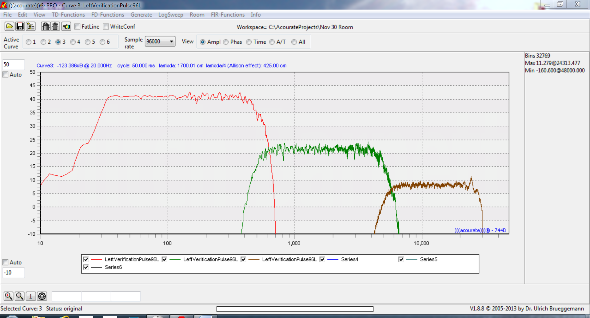

The correction filter shown contains the 3 way digital XO, time alignment, and room correction. It does not contain the individual driver linearization's yet as I am experimenting with a new HF waveguide.
After individual driver linearization, I am expecting better results like the before and after driver linearization's attached from my advanced Acourate article linked above. Measured at 30cm on axis for each driver, full resolution (no smoothing) response.

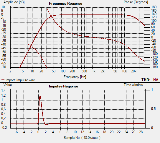

Its hard to argue with Pos post, with one caveat. What happens if there is a HF rolloff, as will always occur in real life? Your top end is a brick wall. That can't happen in reality. And what about a slower -12 dB / oct fall at a higher frequency - more like what I always see.
The brickwall is Nyquist's frequency (44.1kHz sampling rate)
Here is the same simulation with a Q=0.707 2nd order LP filter at 20kHz with a 44.1kHz sampling rate, and then 192kHz sampling rate.

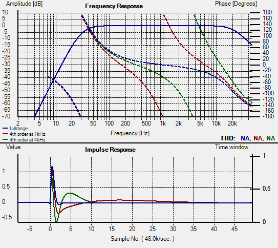

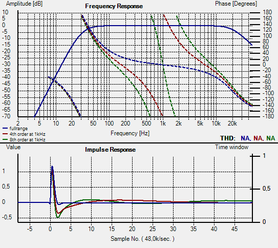

and as a final comparison, fullrange vs 4th order at 1kHz vs 4th order at 4kHz

Thank you very much for that very enlightening discussion.
I had not considered the effect of the crossovers group delay on the impulse response. The non-minimum phase aspect of the FIR filters can remove this group delay. I am not sure if that is a good thing or a bad thing or (most likely) not a significant aspect of the problem.
DSP is making many new concepts a reality. It now needs to be sorted out which ones are worth doing.

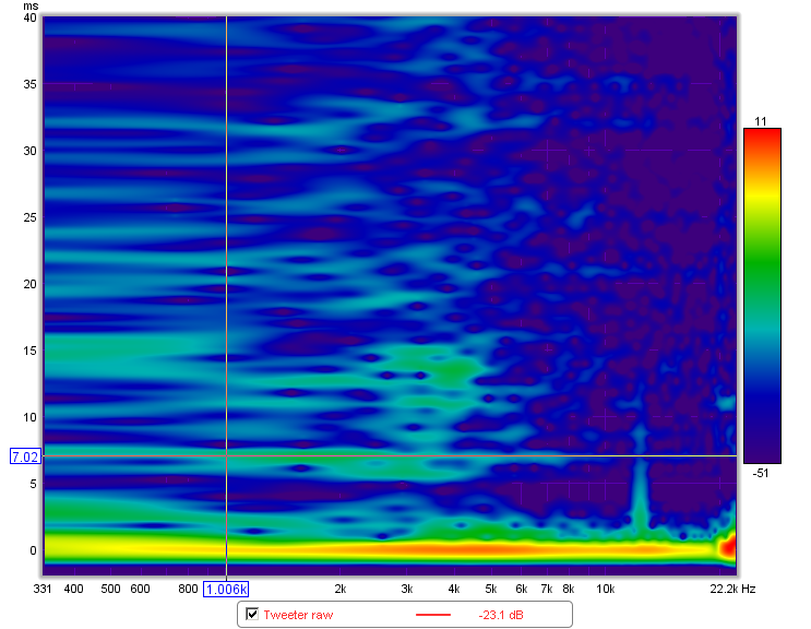

I don't get such clean results even when measuring so close. How close was the nearest boundary?
Is 23cm even outside your speaker's near field?
Raw results are not clean. Here are spectrograms, 40ms with 3ms windowing at 9" (23cm) reference to 0dB at 1kHz:
Raw tweeter:

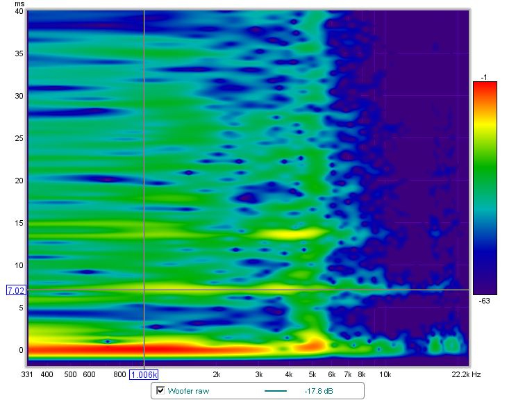

Raw woofer:

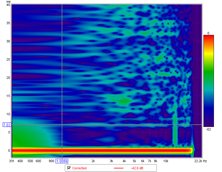

Corrected system:
For the corrected system, the temporal contributions are highly matched. Speaker and room are effectively corrected at the measurement point. All primary modes are driven at point of speaker and corrected at point that is fractional wavelength for all frequencies shorter than measurement distance. Thus primary room mode and low order modes are corrected for peaks throughout room.
Measurements are made with microphone about 1m above floor.

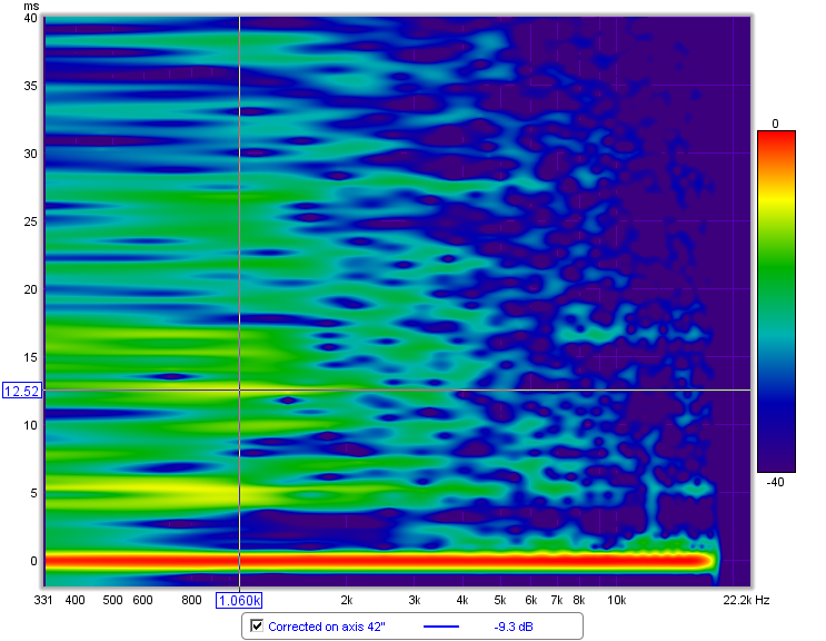

Spectrogram of corrected system at 42" on listening axis, my preferred listening distance for these speaker when spaced to be equidistant from side walls and each other, and located in vertical plane about midway between front wall and back wall reveals plenty of expected reflections. Strongest is about -9db, 12ms after direct sound. This is combination of side walls and back wall:
The above picture is quite telling of room power response and decay.
I find this listening setup provides detailed imaging, with recording reverberations dominant over listening room contribution. Sweet spot is quite large. Image depth of good symphonic recordings extends beyond front wall, and individual voices/instruments are resolved to <5 degrees of arc in horizontal plane. Specific recordings typically require small shifts in listening distance to achieve best image focus.
Integration with single sub placed between speakers fills in low end, and reduces IM distortion of speaker's 5.25" woofer.
Since woofer is pointed vertically and mounted in 6" highly damped pipe, there is no baffle step. Forward firing 2" tweeter mounted in 2" pipe crossed steeply (>200dB/oct) presents primary diffraction pattern that is stable throughout sweet spot. Measurement of this tweeter at 9" is effectively at boundary of near field response. Off axis measurements primarily reveal directivity of tweeter, and small variation in diffraction behavior below 4kHz, the upper bound of temporal cues.
