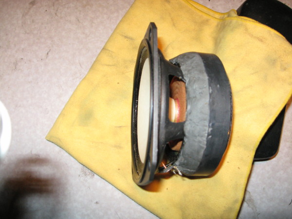

Another improvement: Ron commented about the ugly puck on the original drivers. I was too lazy to add the pucks on the new drivers, so now the cc is 2.2l, seems to be the right size.
FE126eN without “ugly pucks” makes my life even better.

Our A126 went off to a friend's house for use as "computer" speakers with his new 27" iMac. He has a small room that is particularily synergistic. Performance is staggering.
His are the green drivers with the new underpainting trick i've recently learned (picture doesn't do them justice).
dave
I'll get back on the other questions, but i do have DXFs of an iteration of Chad's drawings and have a CAD drawing started -- time for me to finish it.
dave
