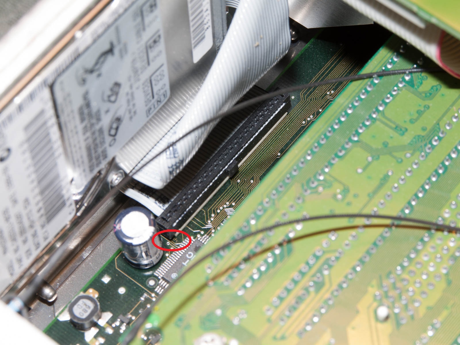

It's a tighter squeeze than what may appear since the IDE header is oriented in such a way that depending on what replacement drive you use (PATA vs SATA+adapter), you may find fitting it in a challenge. Also, please note the red circle around the Pin 44 marking. There is no socket to orient the cable so this would be important.
Good luck.

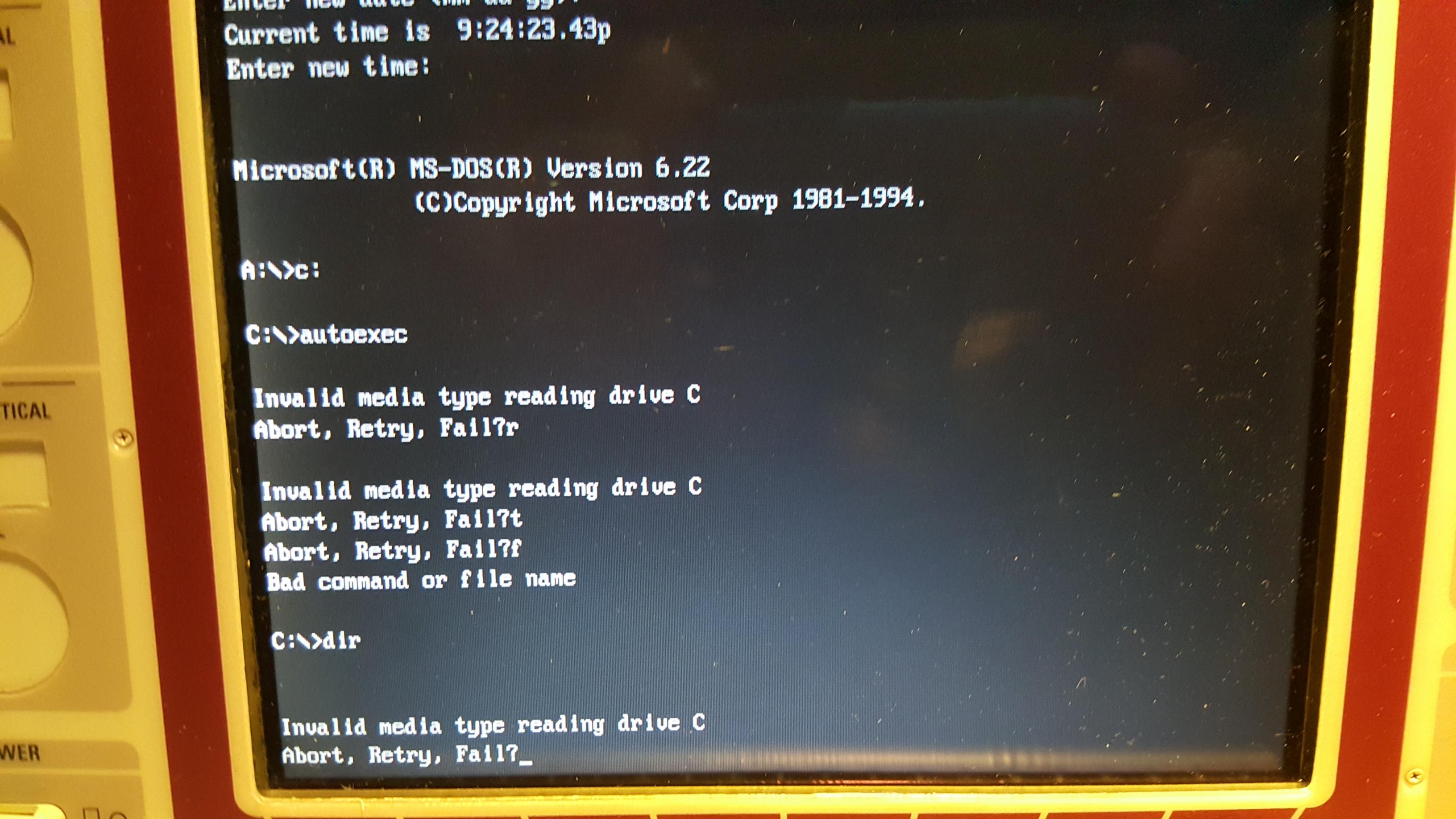

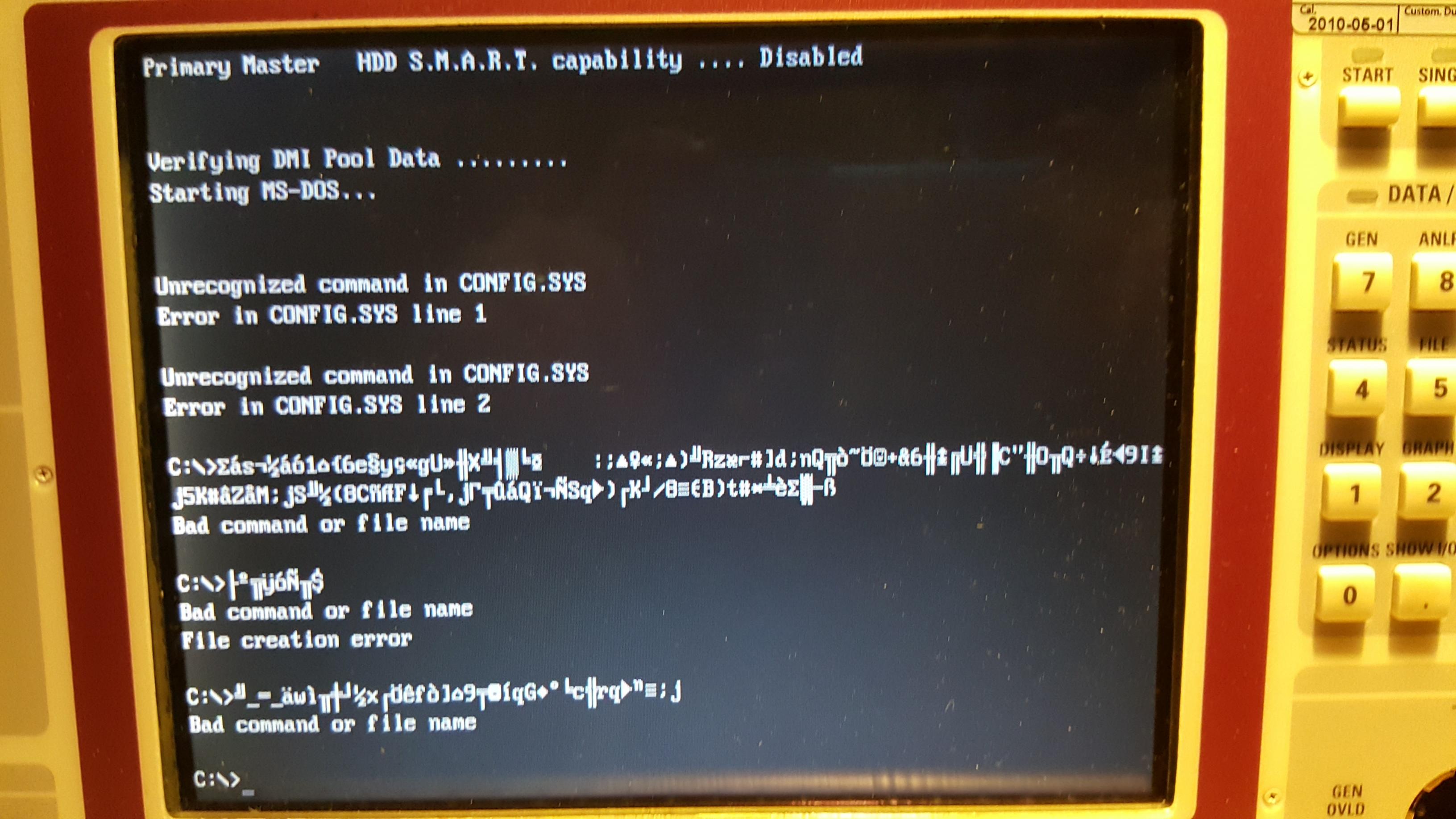

Does anyone have any idea why a cloned drive of the same model as the UPL drive produces a DISC BOOT FAILURE when swapped in for the original drive?
This happened two different times. The first was with building a new system disk. I did this by connecting my bare drive to an Inotek adapter on a Lenovo laptop and using disc mananger in Windows 7 to delete the 20GB partition and re create a 2GB partition that DOS could format. I formated it with a bootable DOS disc "format C: /S". Then I copied the rest of the UPL files to it.
That disc would not boot.

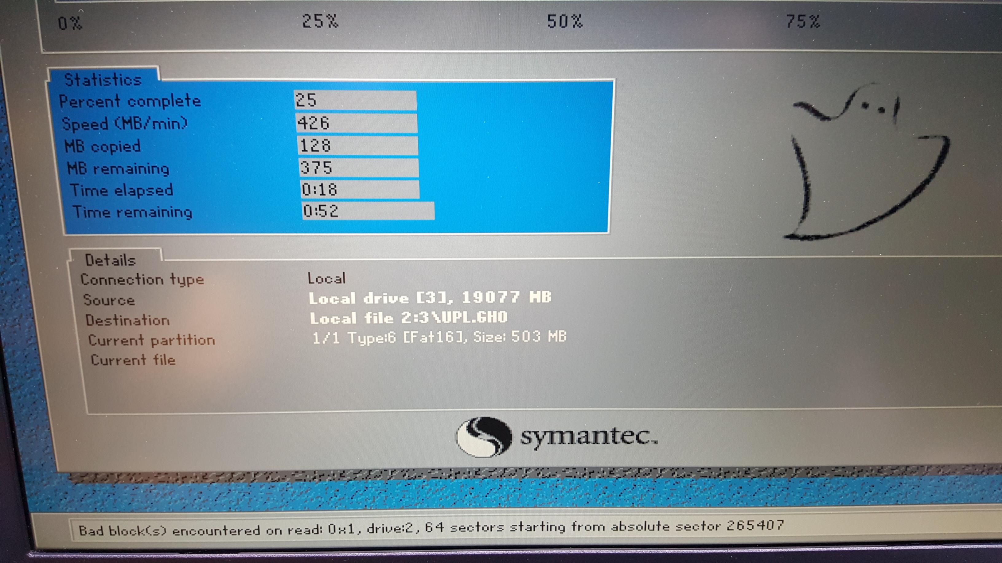

Second attempt was by doing an exact clone with Norton Ghost 2003. I copied the UPL drive to an image file on a 4GB USB thumb drive. Then I replaced the UPL drive with the blank Fujitsu 2020 drive and wrote the image back to this drive, overwriting the original partition made with DOS 6.22 earlier.
This disc would not boot either.
I've never seen a system that could discern a cloned drive as not valid before. Is there no way to make a PERFECT clone of the drive such that the UPL will not think it's a fake and issue a disc boot failure?
Part of the mystery is solved:
The disc was invalid media to the UPL and that turned out to be due to the software used to partition the drive.
I re partitioned the drive from a DOS boot disc and was able to get the UPL to boot to a C: prompt.
However, once I restored the Norton Ghost image of the original drive to this new Fujitsu 2020AT (same model as original), the UPL seemed to corrupt all the data, or the data appeared as gibberish.
See attached screen shots, showing the various stages of progress.
Note that Norton Ghost found bad blocks on the original UPL drive. When I showed these on computer forum full of DOS experts, I was told that this looks like software copy protection. "a number of tricks , some involving hiding data in clusters marked as bad, etc." and "that locked itself to the installation HD using (I presume) the HD's serial number."
After cloning the drive, sector by sector, I have a copy that is unreadable in the UPL, as shown by the gibberish characters when the system starts and tries to read the autoexec.bat and config.sys files.
However, if I move this drive to a Windows 7 laptop, these files become readable again.
For some reason, this particular Fujitsu drive seems incompatible with the UPL drive controller. Is there some sort of encryption between the controller and drive that is locked to a particular drive serial number?

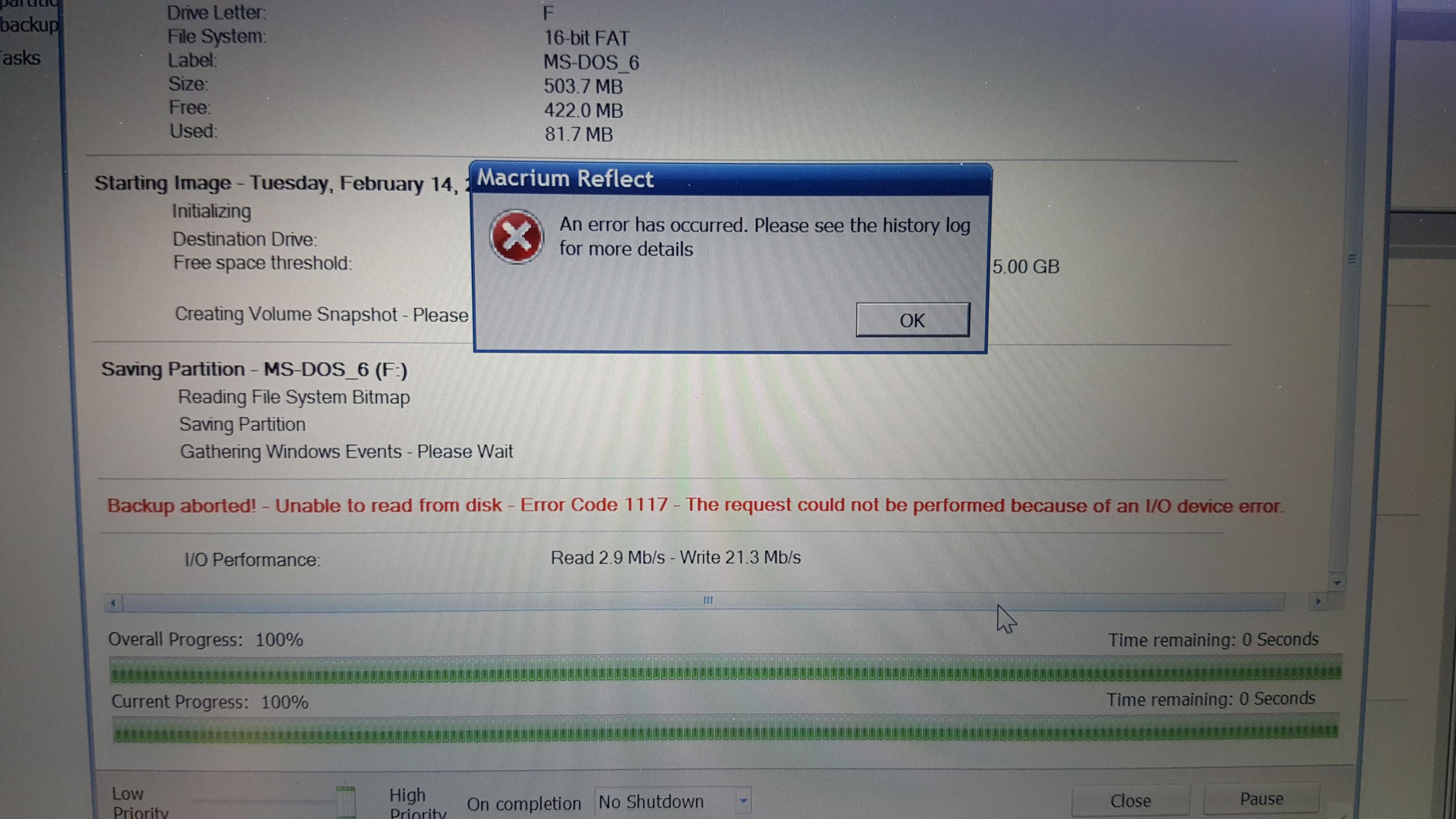

I found out there was a free version macrium reflect so I downloaded that. However it failed to make a backup of the disk.
http://www.diyaudio.com/forums/attachment.php?attachmentid=599339&stc=1&d=1487120087
I then ran ScanDisk from the Dos 6.2 to command prompt. I then removed to the disc from the UPL and installed it in the duplicator and I found that I was able to make a backup copy with macrium reflect in about six minutes.
I then copied that backup image to and identical Fujitsu Drive.

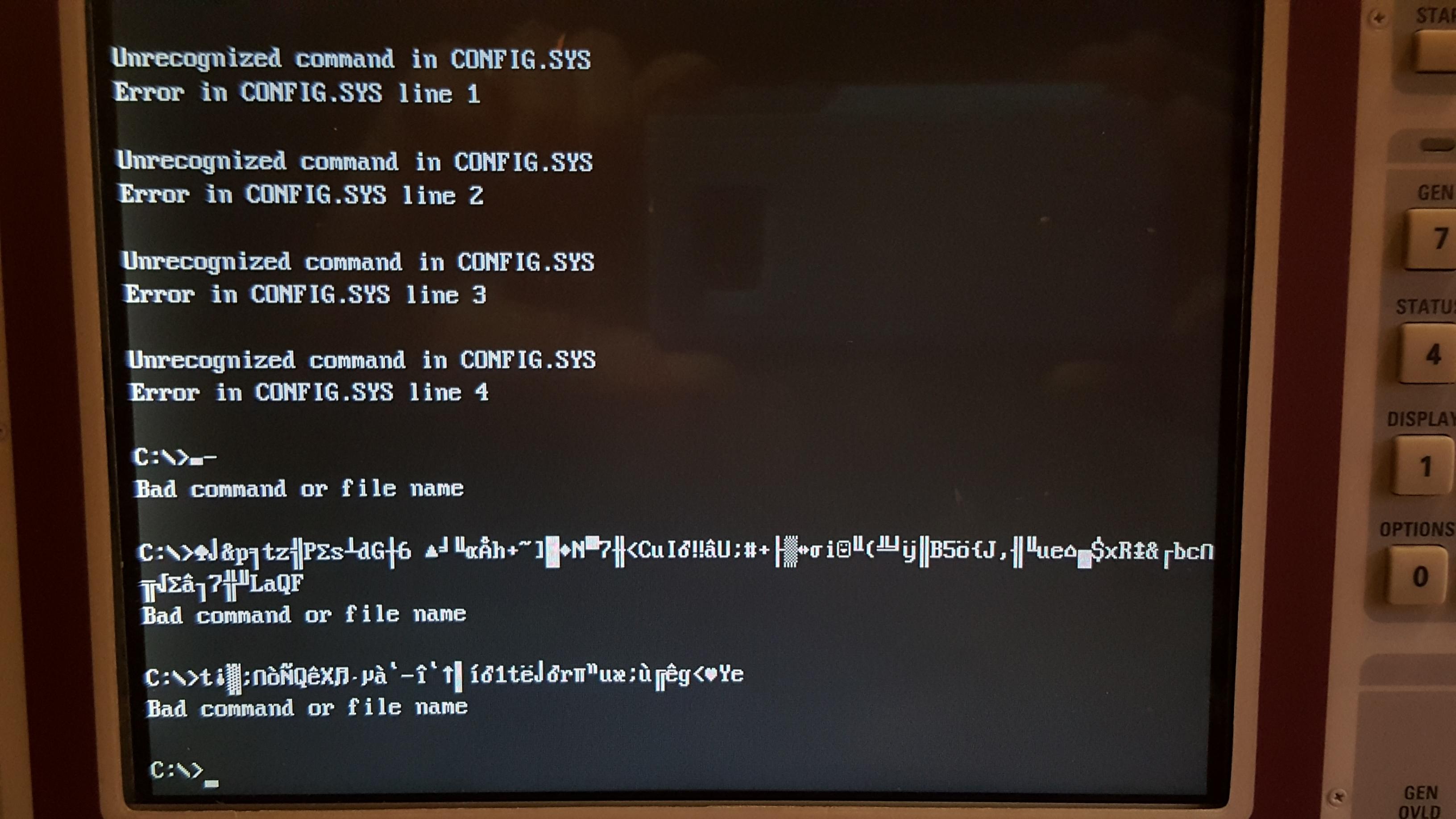

I eagerly installed that drive in the UPL however it will not boot and it produces all these junk characters that you see in the second picture.
http://www.diyaudio.com/forums/attachment.php?attachmentid=599340&stc=1&d=1487120087

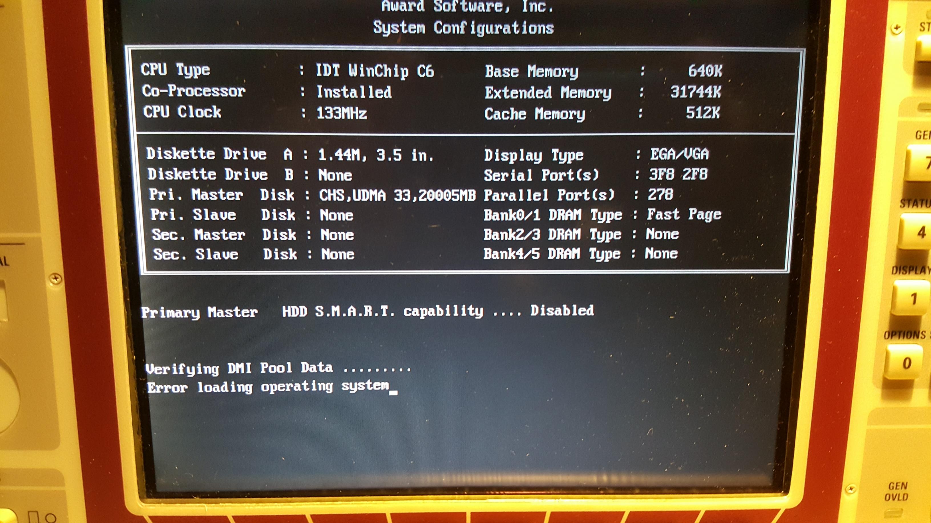

I started to suspect that some controller incompatibility between the UPL and the disk drive had to be at play here. After all, windows machines could read all of the files on the UPL drive without any evidence of corruption. But put the drive in the UPL and boot from dos and many of the folders are gibberish. I backed up and restored and made copies of the master hard drive multiple ways using Norton Ghost, macrium reflect, and even just doing straight DOS copies of folders. None of that stuff worked. So I took a closer look at the BIOS setup for the disk drive controller. And I noticed that one of the settings was normal I changed it to automatic. And then I tried booting from the cloned disk. Bingo that was it!
Of course the question Still Remains as to why the original Fujitsu Drive didn't care that this cmos option was set to normal and not Auto. You would think that and identical model Drive made an original copy from to a new Drive of the same model and make should result in a perfect copy indistinguishable from one another. But apparently not the case there must be some low-level Hardware differences between these two drives and the cmos can tell the difference. Anyway the problem seems to be resolved and I have successfully made a bootable and operational backup copy.

if the drive controller is sophiticated it will remap around bad sectors. If the drive has different sectors in use you run into this stuff. Back then you usually had to low level format the drive in the final box. I have not seen a utility for low level format in 15? years. This stuff is really obsolete. The auto workaround make sense. if you can use a DOM (disk on module) SSD even those they are expensive for what they are it will both be way faster and more reliable. Disks of that generation were pretty fragile with shock or power events.
