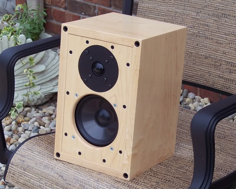

There are some nice examples out there but Im looking for one in particular that was discussed in a thread about a year ago, Im having no luck with search. I need help on the name. This kit went for around 300 and I would like to order one.

I suspect you are looking for the "Continuum" search on that.
If your not, check it out any way.
http://meniscusaudio.com/continuum-bare-bones-pair-p-1399.html

It's a variation of Jeff Bagby's Continuum with different drivers:
https://www.salksound.com/continuum%20-%20home.htm
There's a lot that is different from the BBC LS3/5A. At some point all these speakers become a sort of mere homage to the original.
A bigger cabinet makes sense with modern drivers. Jeff uses a metal tweeter too. Then you think, maybe reflex would be easier:

Funny. I have just finished my jeff bagby continuum.It's a variation of Jeff Bagby's Continuum with different drivers:
https://www.salksound.com/continuum - home.htm
Peerless HDS PPB 830860
they aer break in as we speak.
they sound really good right now, like amazingly good especially since they need to break in. they totally disapear, the highs are some of the best I heard. I'll add more details in a week!
