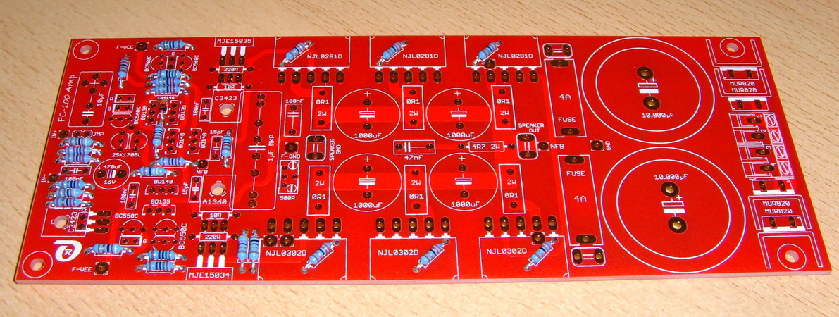

I have started doing the build today (see attached image) and will go on matching the small transistors (BC550C, BC560C, ...,
the HFe matching will be done using my DMM) and solder them tomorrow.
I have begun with the resistors, and as you can see: I am using standard metal resistors.
I will use "standard" components throughout this build, but I will use carefully matched input transistors (LSK170)
and closely (< 5% HFe, VBe) matched output transistors.
I will then try and prepare the heatsink.
This will be the biggest challenge for me: I am not a craftsman at all!

If I succeed with this AMP (designed by Mihai, the PCB being layouted by METAL and me), this thread will contain
all the information necessary to do it yourself.
I will keep you informed about my progress.
Best regards - Rudi_Ratlos

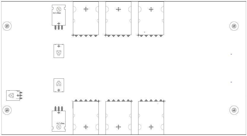

The size of the heatsink needs to be bigger than 104 x 191 mm (see the attached image of the drill-master).
A heatsink with a height of 100 mm may be a little bit short.
I will use an old 100 mm heatsink for the prototype as well.
I will not yet use the heatsink shown in post #140; I have to obtain some experience drilling and mounting the transistors beneath the PCB first.

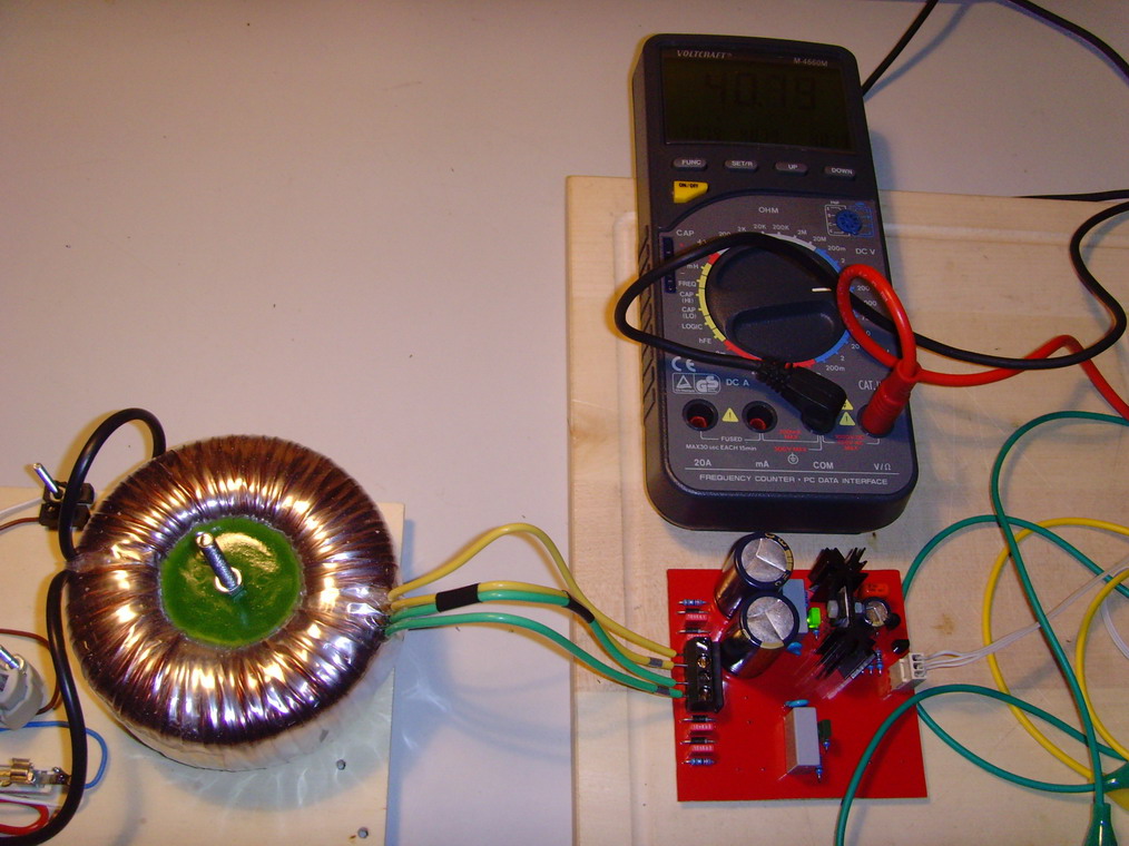

I received the prototype of Mihai's shunt PCB yesterday (the layout follows exactly the schematics in post #45 of the RMI FC-100 thread)
and built the positive regulator.
The transformer I use is 2 x 35VAC at 120 Watt.
I used a 2K2 resistor as load resulting in a current of about 19mA.
The good news: the shunt did not explode
The bad news: the output shows 40.5V (instead of 39V), and I wonder if it is as stable as it shall be.
The value that my DMM is showing changes rapidly between 40.3 VDC to 40.7 VDC).
I do not know the power requirement of the FC-100 frontend; I did not find it in the thread.
Maybe my assumption of about 20mA per rail is absolutely wrong.
Is there anybody who knows the exact current rating of the FC-100 - frontend?

Joe,
I played around with the load resistor's value for some time, and when I inserted a 1K I saw a very stable 39V for the first time.
1K @ 39V: this means that the frontend needs about 40mA current!
I know the AMPs of Carlos that need about 12-15mA.
I know Michael Bittner'S SYMASYM very well. This one needs 8mA!
But since Mihai has certainly matched the shunt to the frontend of his AMP, this value must be true.

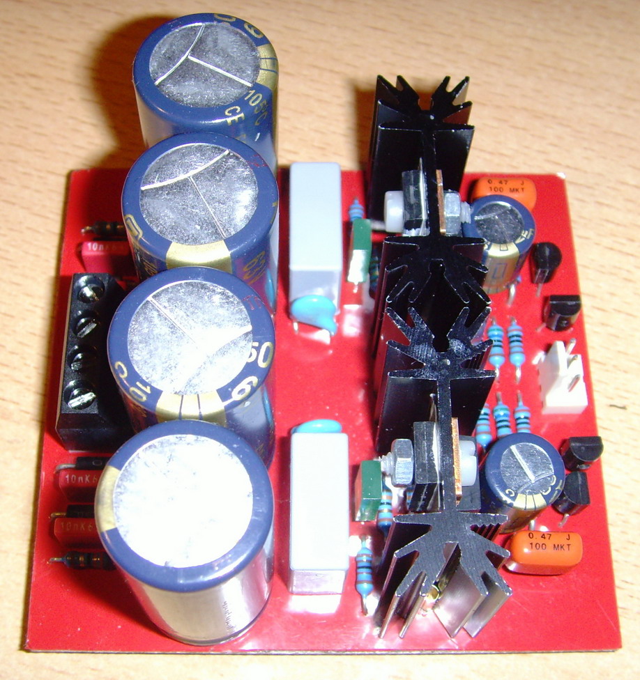

Find attached a picture of the prototype-shunt PCB.
I am thinking of including it on the left side of the AMP's PCB.
The distance from the AC-section of the shunt to the input and small signals is about 7 cm and there is a big power-plane between.
Therefore I do not think that the AC section will interfere with the small signals.
What is your opinion, Joe? May I?

rudi, I would suggest taking that beautiful scope of yours and look at the ripple content,at your load current of 40 ma. If you see any spikes in the waveform you can bypass c13 and c14 with a .1mfd cap to ground,,to prevent any noise pick-up from your zeners, it also may not be needed. And thank you for your kind words. Evette

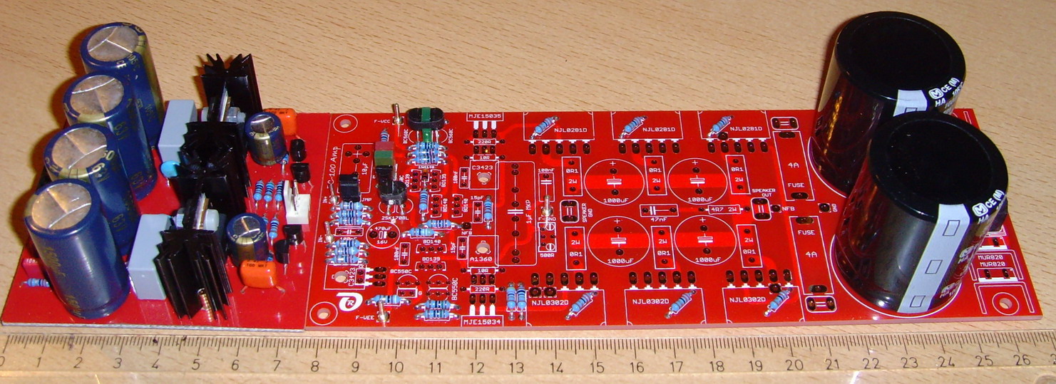

Joe,
this is what I am bearing in my mind to offer to you:
http://www.abload.de/img/shunt0126nuo3.jpg
A big "whale-PCB" (as Carlos would have said), containing the frontend-PSU on the left and the backend-PSU on the right side.
I will check the frontend-PSU with my oscilloscope tomorrow and will then go on with the AMP PCB.
Best regards - Rudi

I feel proud that you love our work, thank you very much for your nice words indeed, I hear them coming out of your heart :- ) This PCB took considerable amount of time and hence, effort to make it as is now.
Now we need to see how to complete this project, whether to put the shunt on the amplifier PCB or not, all inputs are welcome.
