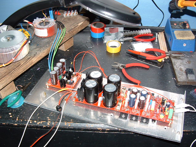

Hi I have built my fc-100 this time I have taken great care testing after fitting each part ,both boards look very neat.
Except i have a problem i can get 4 thermaltraks to work at 36 mv but when i try 5 with the pot at zero i power on it shoots to 40 + and would keep on going up,this is for both boards.
On reading back Rudi had this problem he used a bat42 to fix it ,However if i changed a pair of thermaltraks would this help ?
regards john

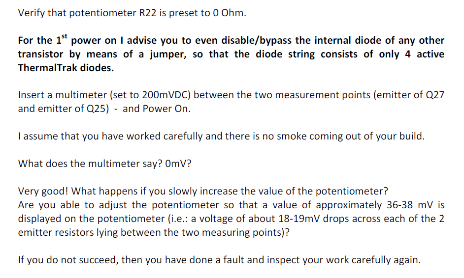

I have disabled each thermaltrak in turn I cannot get 5 to work they all act the same,so I fix in a bat42 as per the manual and it works ,its stable I am happy .
However I have a question I cannot find in the manual what do I set the pot to,i have so far set it to 21mv but should it be 36/38mv thanks john
