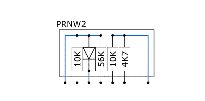

See attached. Check for leakage and confirm that all resistors are within tolerance.

Leaving the PRNW2 off the PCB indeed does allow the amp to power up - Not in protection.
Do you think there might be more leaking components inside the ANW7s? I still have the 8k2 resistors jumping the outer two detached pins on the PCB of each module.

I can do that. Just did it actually with sergical scissors. I verified with DVM that diode leg is detached; and of course I can put it back with a little solder when done.
Unfortunately the amp still goes right in to protection mode.
That disconnects the module from the rest of the over-current circuit so it appears that the module may have problems. Removing Q1/2 disconnected the module from the DC offset circuit and the amp still went into protect. Those are the only two protection circuits driving the module.
It's a simple circuit so I'd suggest that you reproduce it using discrete parts.
