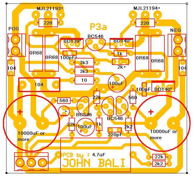

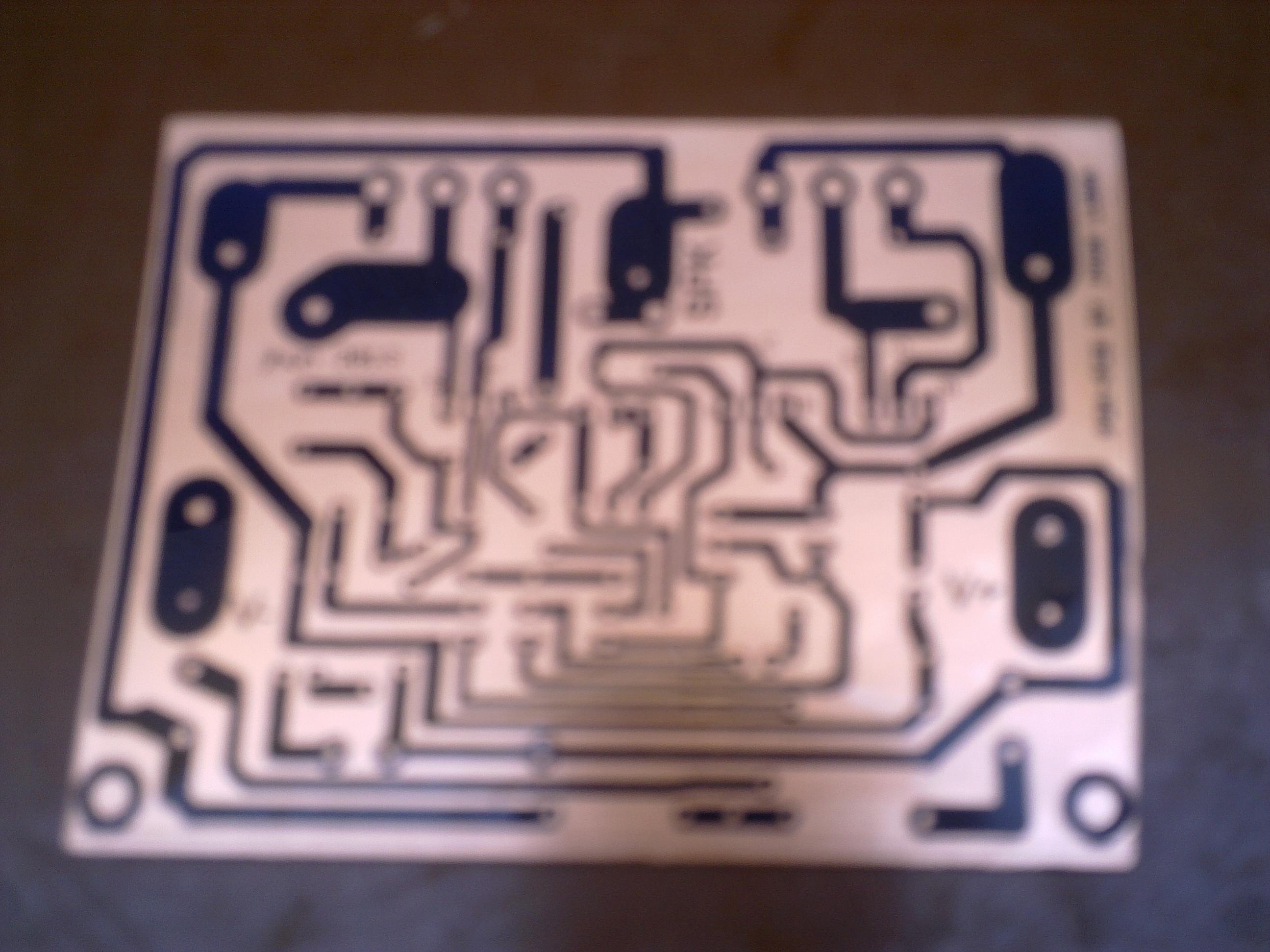

buddy,Hi all,
I'm new to this thread...!
This is my 1st amplifier layout. I've been working with small layouts earlier.But this one seems to be a BOMB!
Any Suggestions related to placement of components welcome!

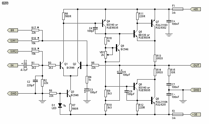

Good day sir Alex sir... sir pls. check my p3a amp if im mistake sir because not work i use +/- 24V DC rails..

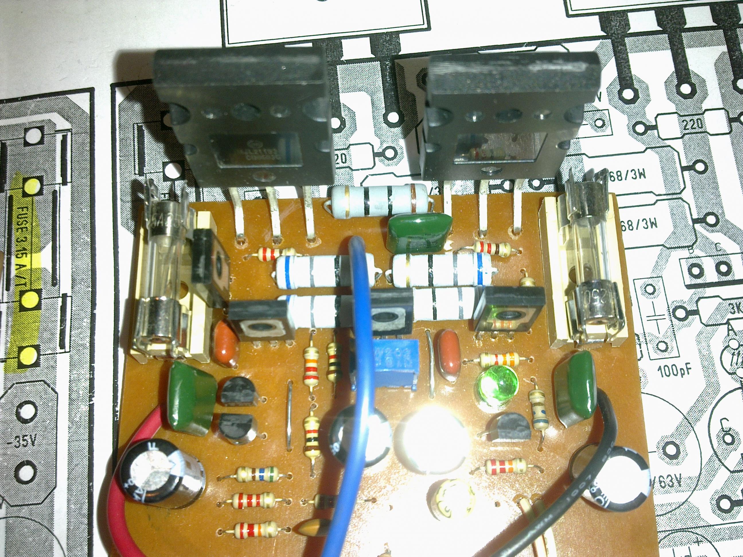

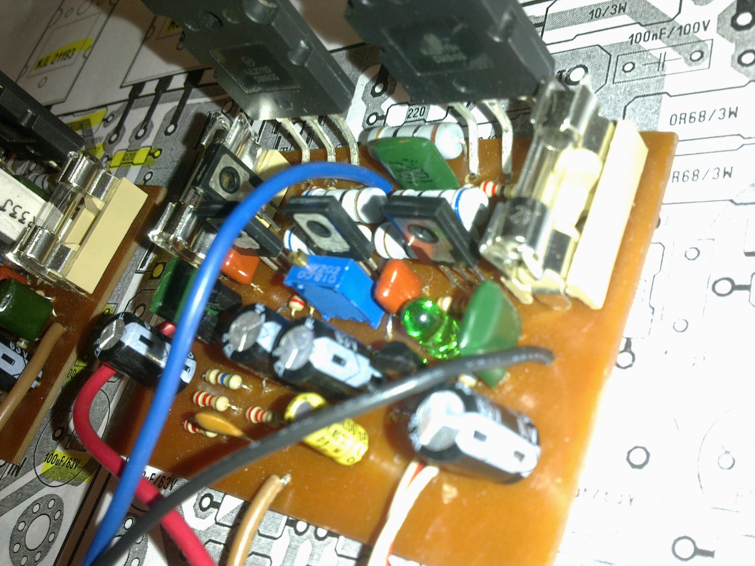

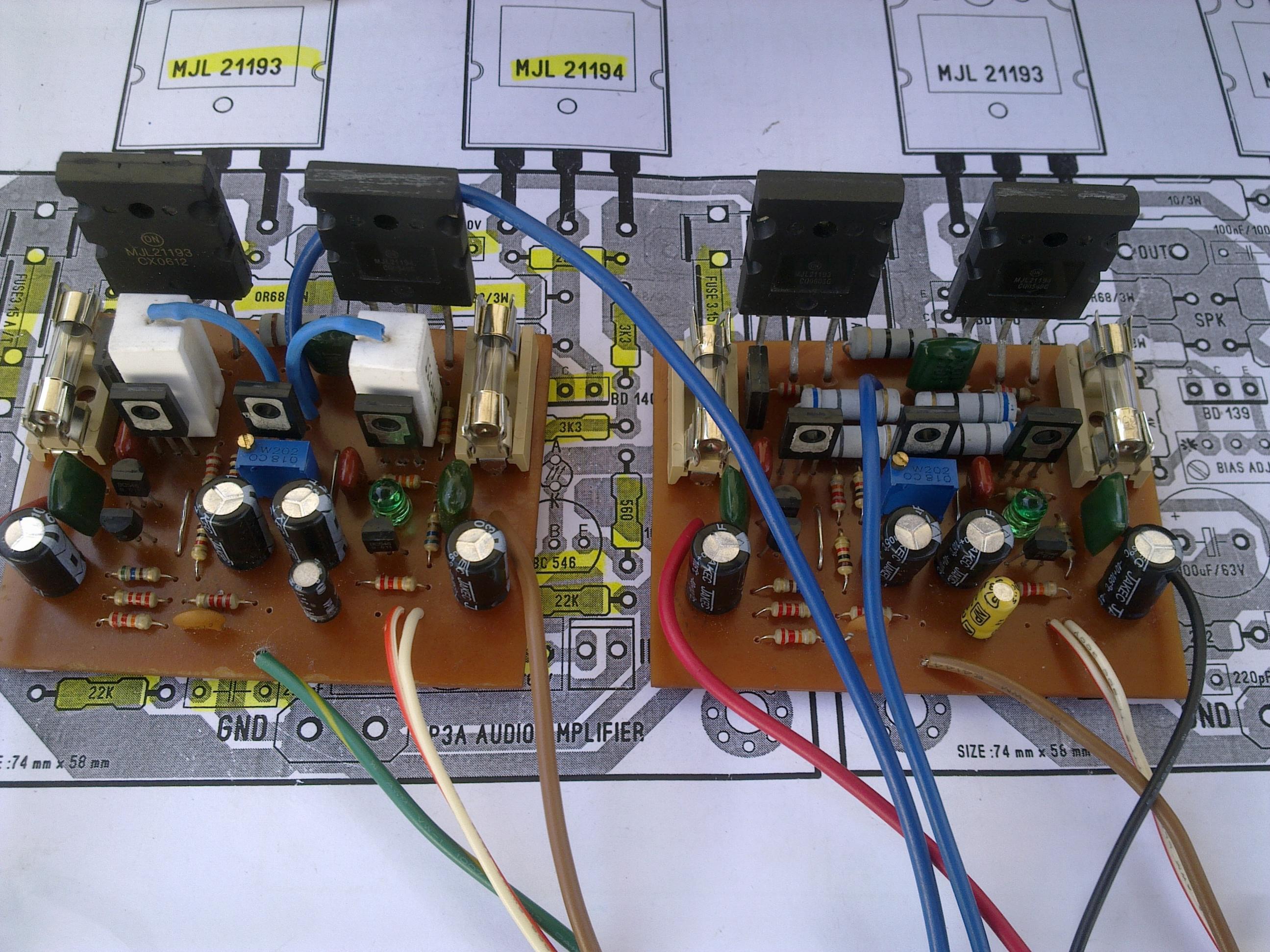

Check the pin orientation of the transistors you used...
"Not working" is a bit unhelpful. What are the symptoms ? Do you blow fuses ? Is there DC on the output ?
In the first picture, the amplifier on the left has a fake MJL21193. What other transistors have you used? Are you sure they are genuine parts?

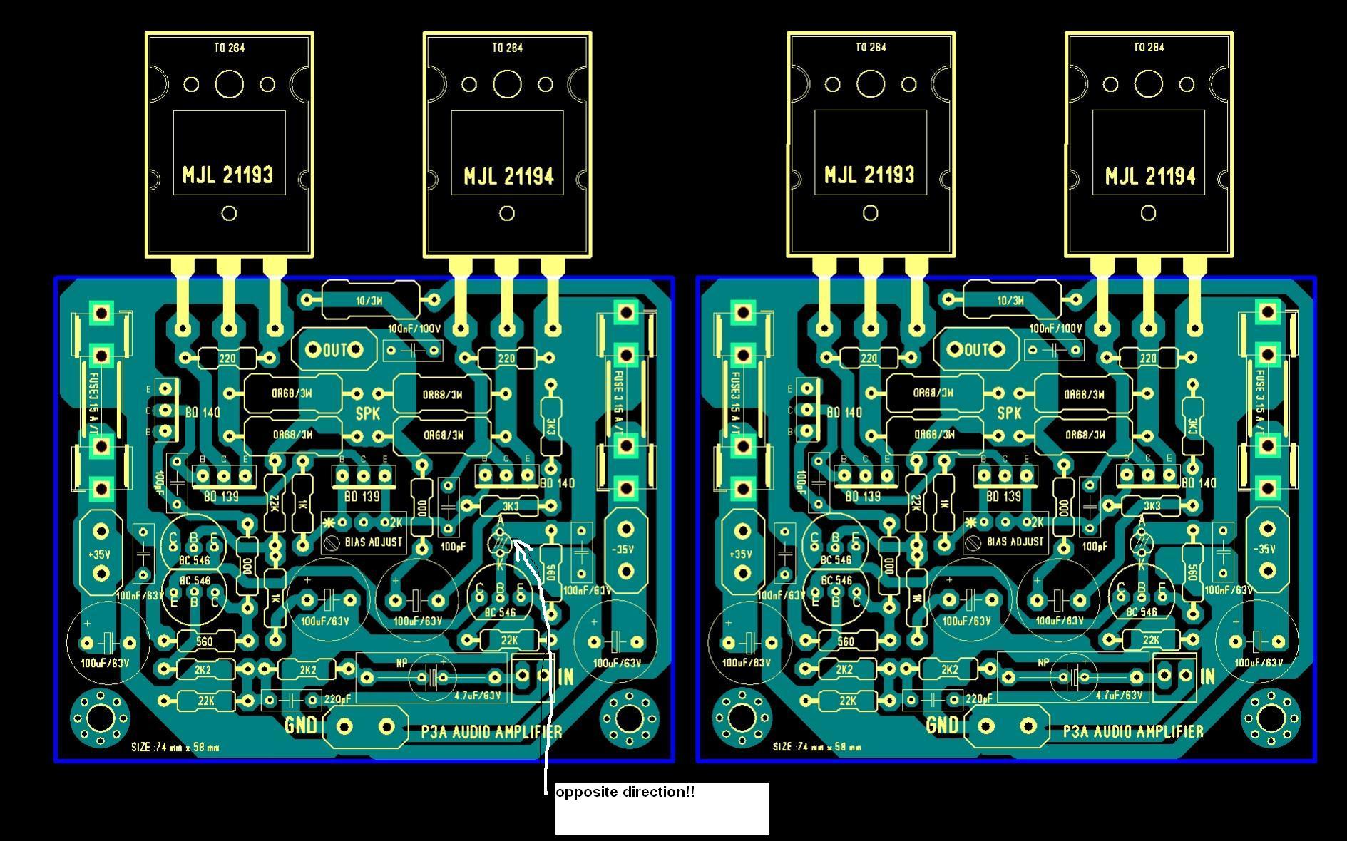

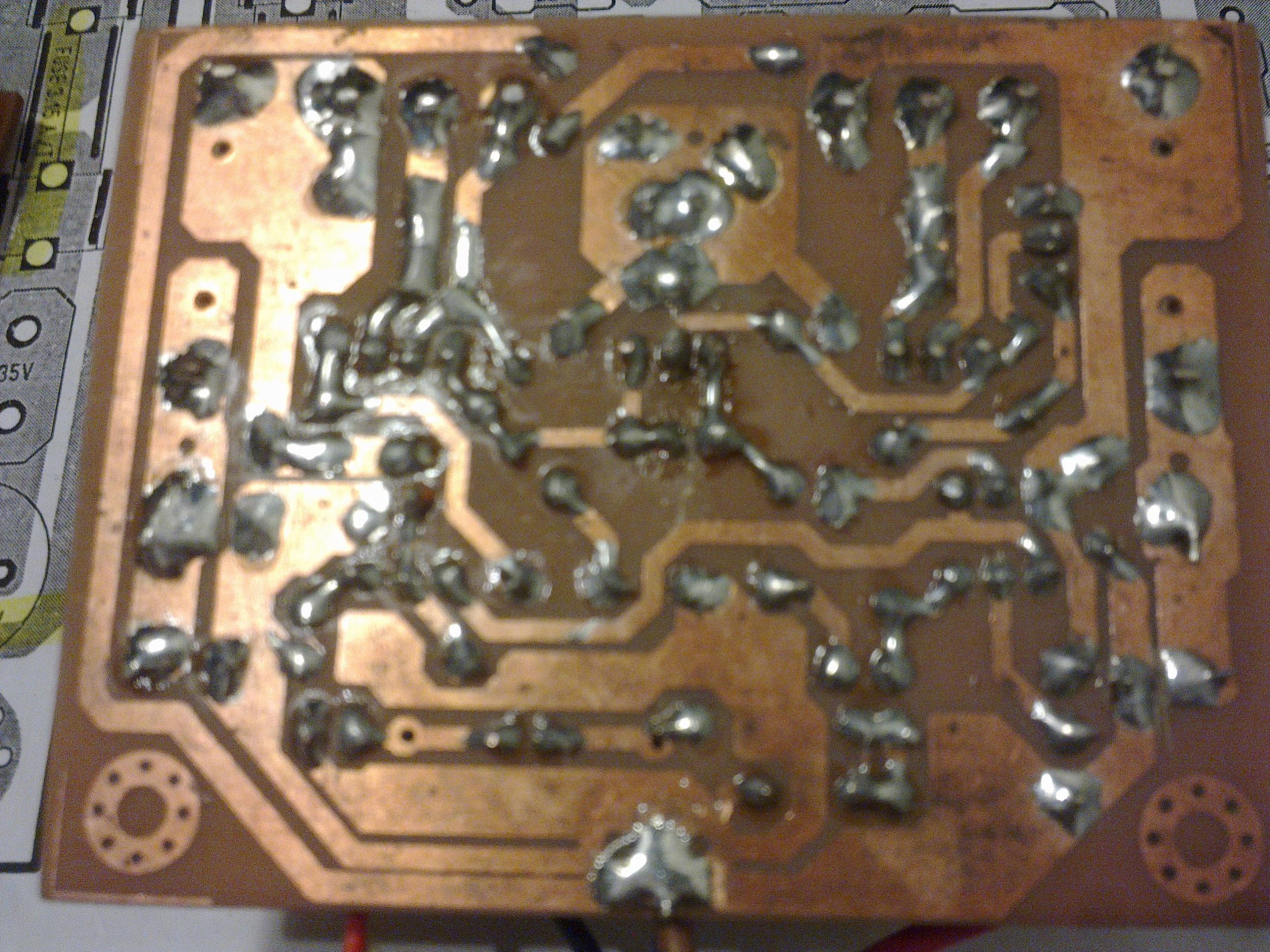

Hi desertstorm .
In this morning i had test this board.
Take a look on green led.
Anode(long pin) must be connected to base of bc546.
Pcb is wrong at this point at least.
I don't know for other mistakes .
Regards.
thanks sir Problem solve sir its a fake bd 140 and led pins orientation now woking fine sir i make also my own PCB sir based on sir eliiot p3a and circuit diagram by sir Davide Bucci works fine sir...

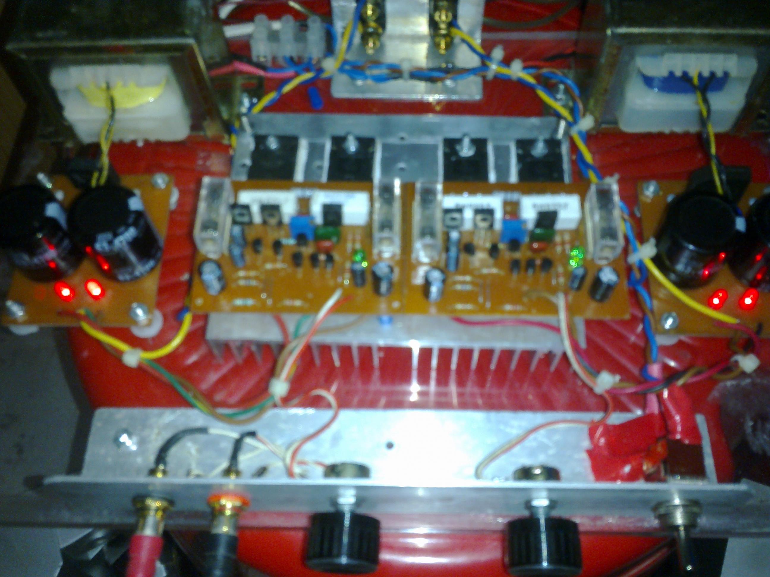

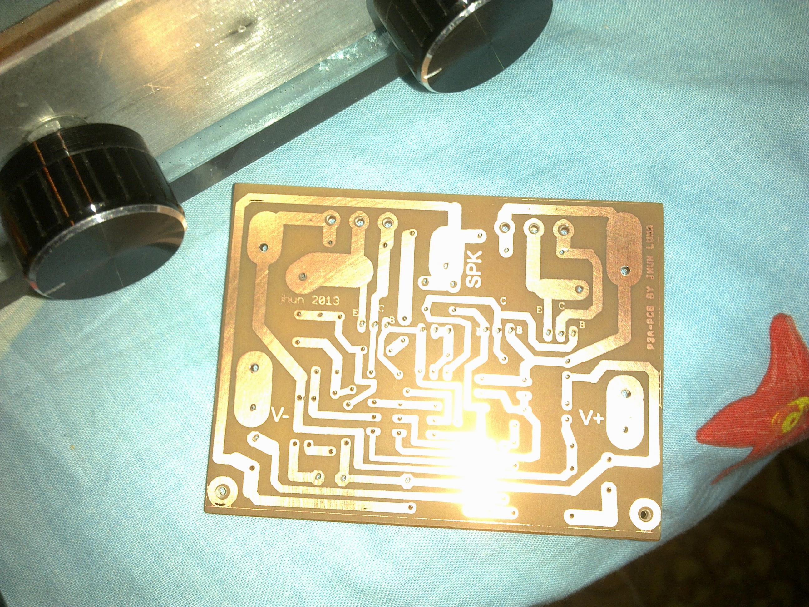

Sir heres my own pcb based on sir elliot P3A and circuit diagram by sir Davide Bucci working fine sir..
No heatsink for the driver transistors or thermal coupling for the bias transistor? That will be "interesting" under power, or is that just a part finished amplifier?
Hint: bias will be irregular and too slow in response, without enough thermal coupling to the driver(s).
Being right next to the output emitter resistors, they will have more affect on bias than the drivers. This is not a good layout for a CFP amplifier design. It may be possible to move the large resistors under the board and simply kink an aluminium strip heatsink to fit to the correct side of the righthand driver transistor (as in pic 3, above). This should solve the problem of what looks like reverse facing drivers.
Thermal coupling can be done by having a small bias transistor in close proximity, as you see on Rod Elliott's original PCB or a larger one fixed to the same heatsink as in AlexMMs layout. If you use TO126 transistors for all 3, as you have, it would be much better to couple them all to the same small heatsink, which could be a simple strip of 3mm aluminium, perhaps 15 mm wide.
My layout is bad, check the elco!
