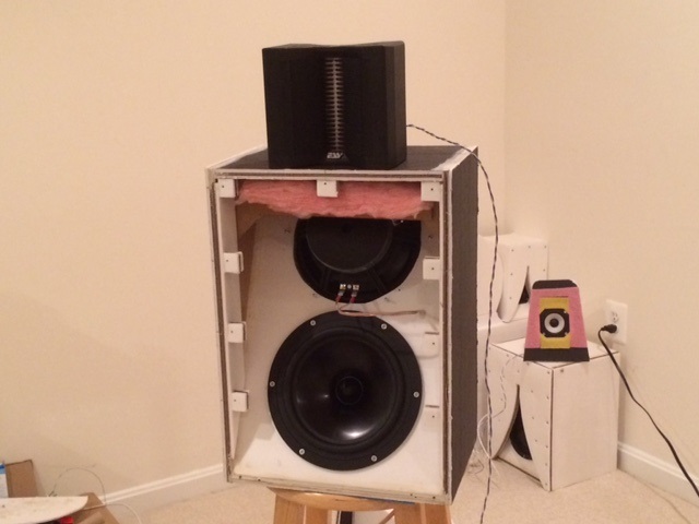

Well, the RS225-8's finally got here - they are beautiful drivers. Superb build quality, and what's more - some T/S parameters that are exceptional and hard to find even in other drivers at a higher price point. Nice cast frame, well made rubber surround, super hard anodized aluminum cone and phase plug. So I installed them into the KaZba and took the opportunity to widen the K-aperture and add ribs to its backside to strengthen it. There is no comparison between these and the cheap $10 drivers I previously had in here.
Here is a photo of the drivers installed inside with the AMT dipole tweeter on top, without the K-apertures:

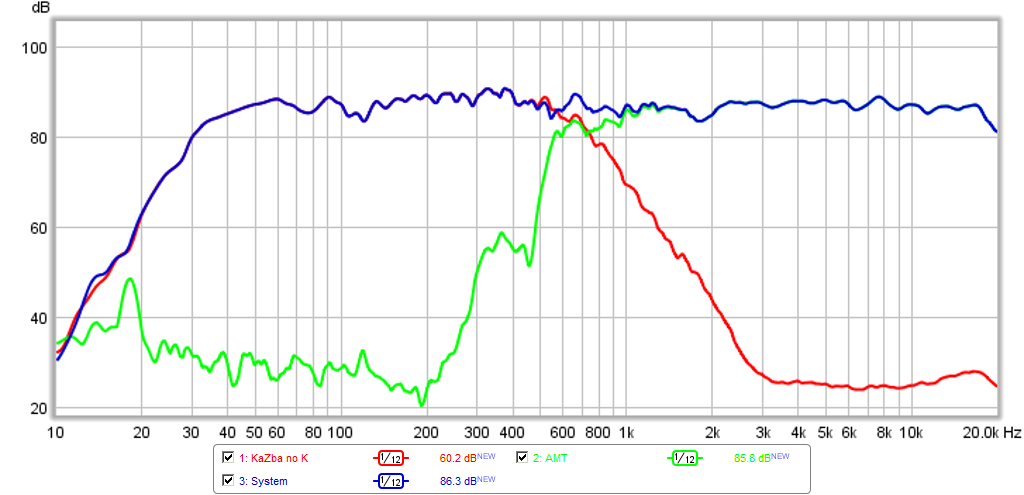

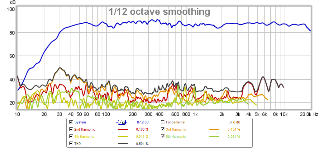

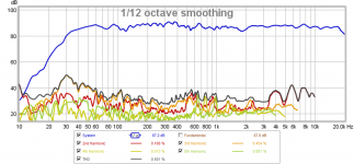

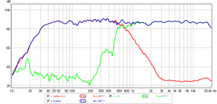

I established a baseline response sans K-aperture and here is what the XO response looks like with some minor EQ'ing, LR4 @ 700Hz:
This is the corresponding HD - which looks excellent for how wide the bandwidth is:

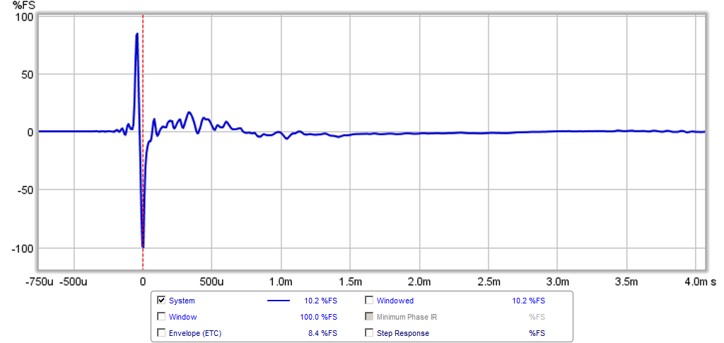

And this is the impulse response - exceptionally tight:

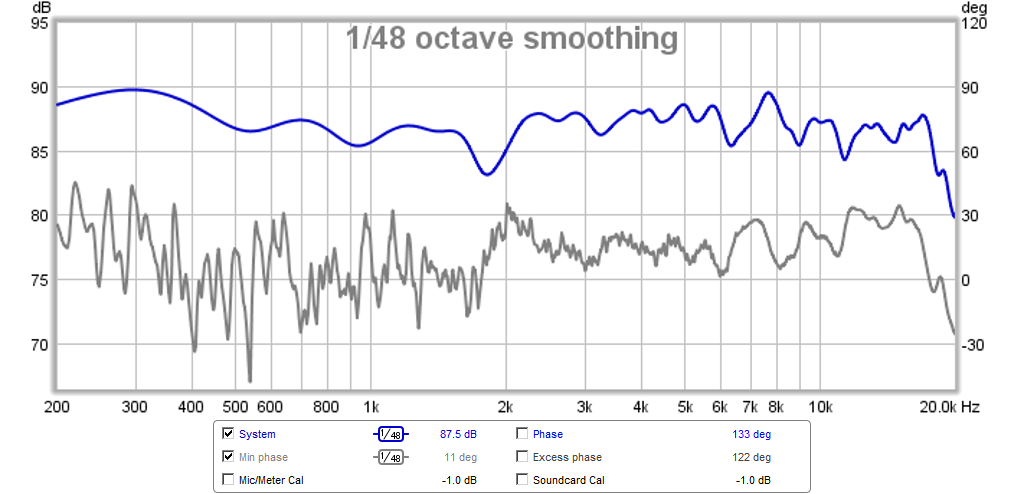

Here is a detail of the frequency response and minimum phase at 5dB/increment and 1/48th oct smoothing with 4ms gate window applied (measurements at 0.5m and 0.71 volts)):

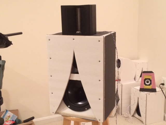

Ok, now we add the new K-apertures, and here a photo:

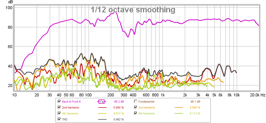

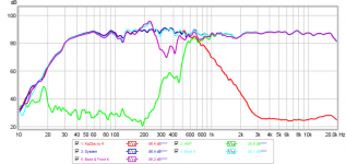

ANd this is what we get for frequency response as seen in the XO traces (magenta trace) - a bandpass peak appears at 250Hz and a dip appears near 350Hz, but the 700Hz XO region appears to be intact. The cyan trace is response with just the rear side K-aperture installed:
Here is the corresponding HD with both K-apertures - with an obvious increase in the harmonic distortion, I assume from the K-panel vibration:

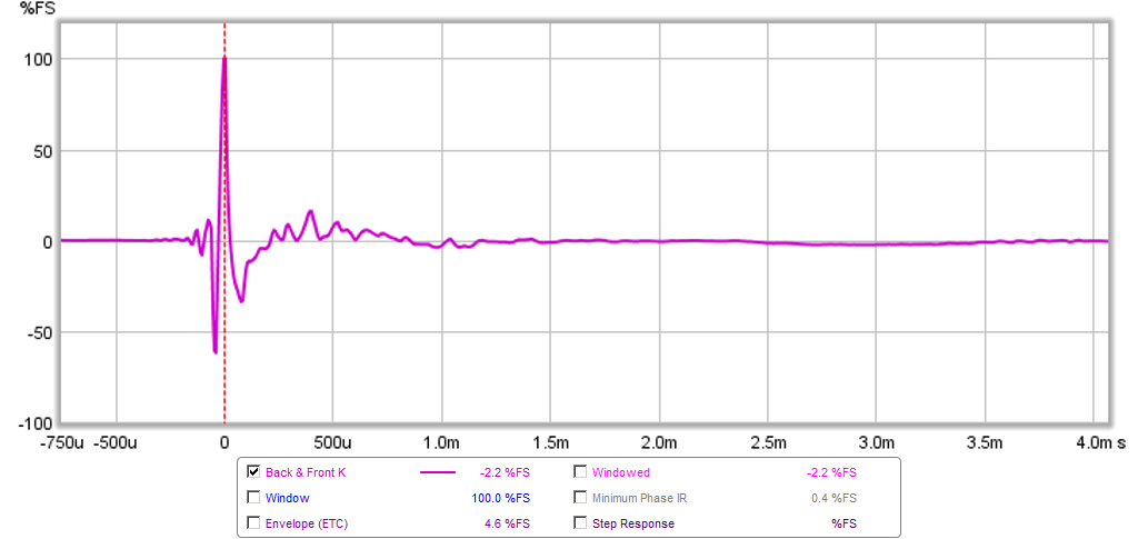

and here is the corresponding impulse response:
As is typical of K-apertures, there is a strong dip/peak in the mid-bass, the good news is that it now extends above the initial dip from widening the aperture so that I can cross higher up with the AMT (the original goal). Listening to it, I am not sure I can really hear the anomalous response from 250-350Hz - which sometimes happens due to room modes. The aperture however, made the presentation of the sound more uniform over a wider range of off-axis listening angles, it visually decreased the cone excursion on kick drums. The sound of percussive instruments seemed to be tighter and this can be seen on the IR's which have less overshoot.
