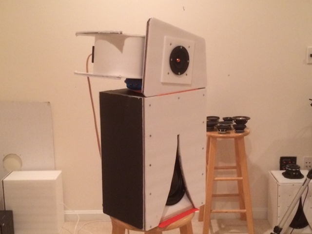

Here is a FAST using the Dayton Audio PS95-8 driver in a Nautaloss with trapezoid baffle. XO is 225Hz LR -24dB/oct.
474429d1427599240-rockin-kazba-dipole-k-aperture-z-baffle-dipole-kazba-8in-ps95-8-fast.png

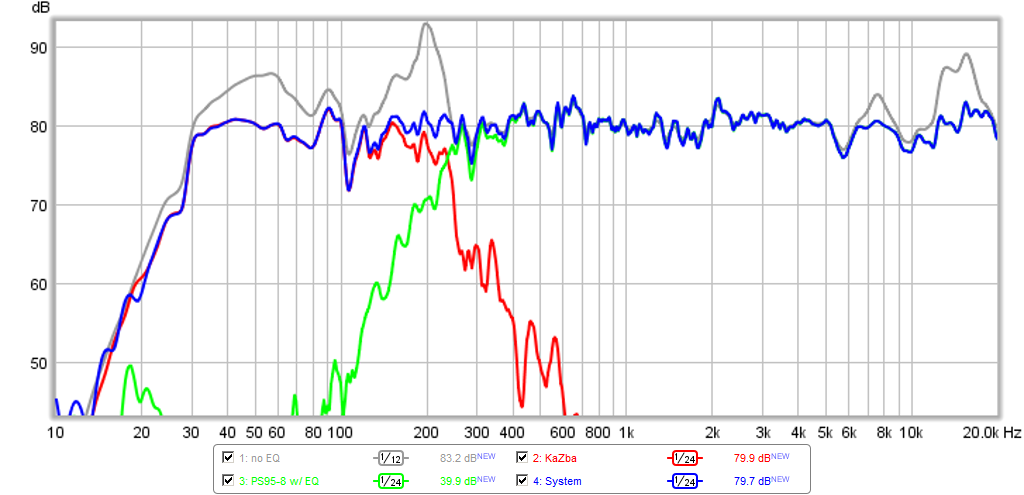

Freq response (grey is no EQ) and XO shape:
474430d1427599240-rockin-kazba-dipole-k-aperture-z-baffle-dipole-ps95-8-kazba-fast-xo.png

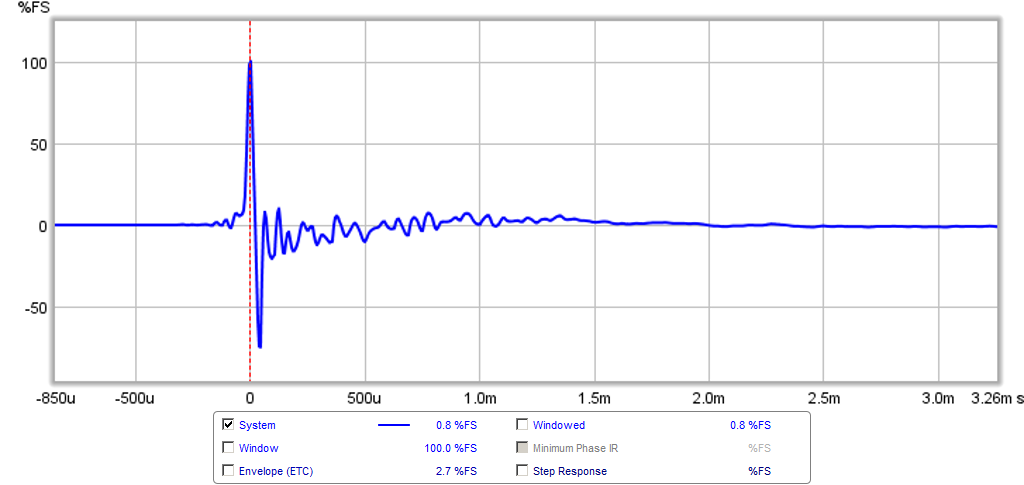

Impulse response:
474431d1427599240-rockin-kazba-dipole-k-aperture-z-baffle-dipole-ps95-8-kazba-fast-ir.png
It sounds very nice - the EQ helped to get rid of the sizzle/ringing.
