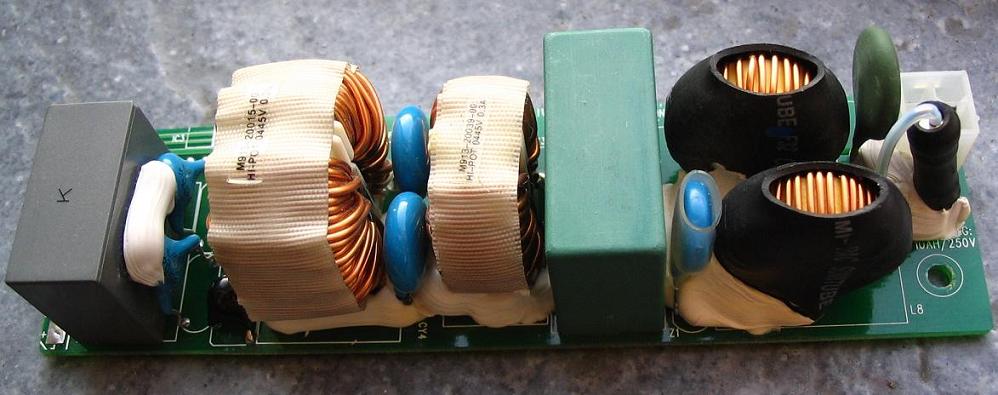

I have to see if a RF filter from a SUN server power supply is good as a main input filter and if will have some influence in better sound fingerprint. Any of you have experience with that? (thank you in advance for any input)

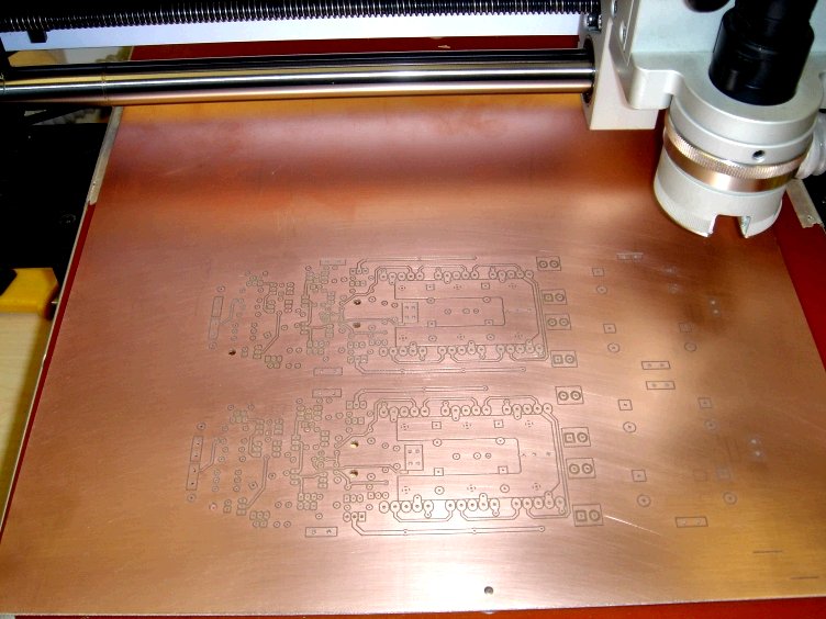

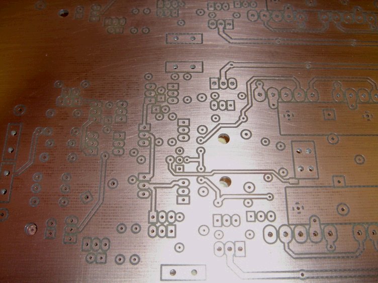

Hi Mihai
for the moment it is not grounded.
I have made 2 type of Symasyms , with and without ground plane, and frankly i don't ear any differrences and stability is good.
I wil try a channel first and submit it to torture first, i will need a good dummy load to really replace a speaker, and i will measure it with a real TFT analyser.
I'm confident, it will work.
I have just finished matching my 30 pairs of output transistors.....:D
input filter
hello mihai
i create an AC/transient and DC-Filter for a preamp including
slow turn on (not really for preamp). Result: no Transformer and line noise.With some small modifications it's prepared for power. The schematic and board is Eagle.
just open a bottle Weizenbier prost
regards Ralf
