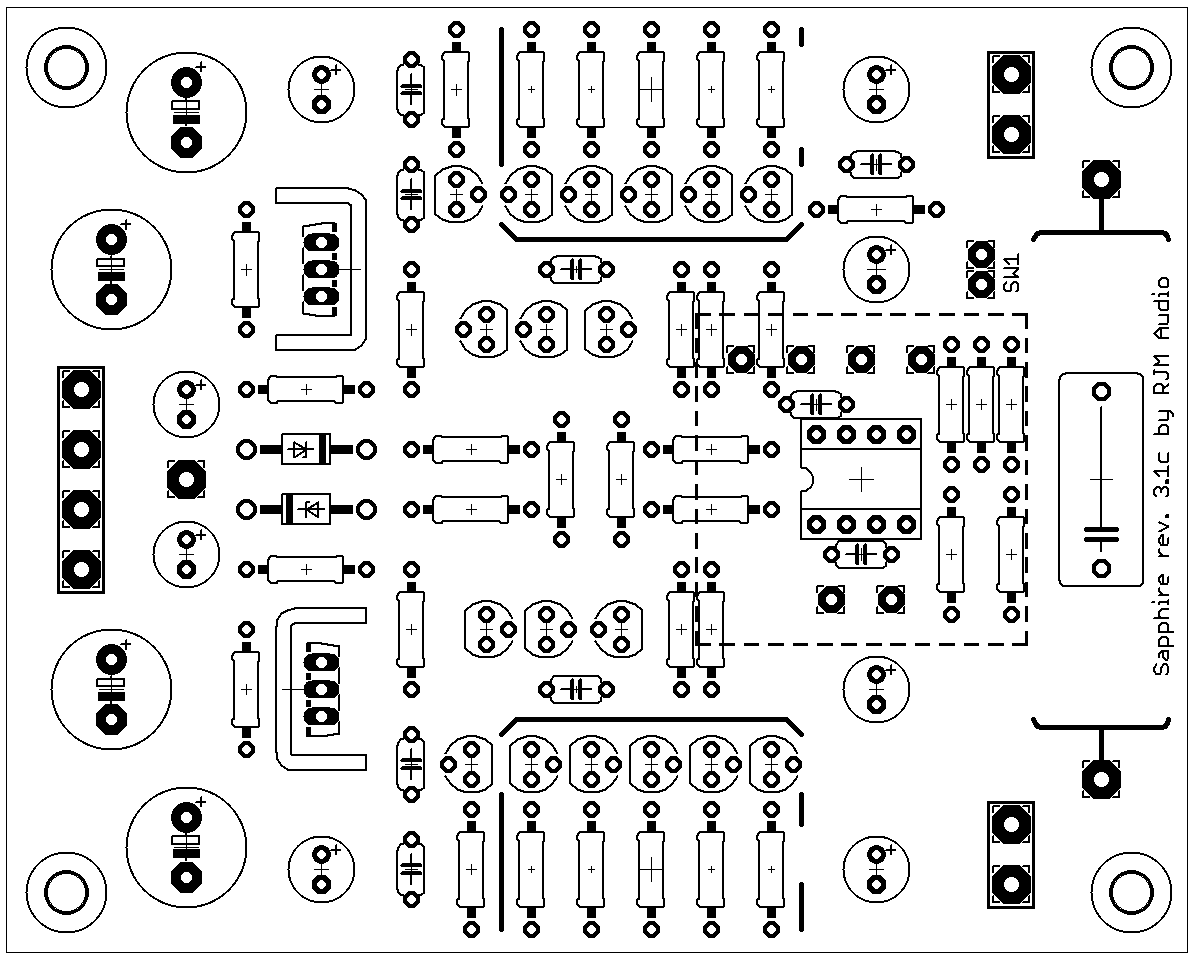

Sapphire 3.1c
2520 pins.

FWIW- I really didn't expect that the 2520 footprint addition would even be considered. I wouldn't expect you to stock the sockets. Rather, I'd guess/suggest providing a part number for them and the hole dimensions and withhold the 8-pin dip socket and two of the 0.1uF bypass caps from anyone that wanted a DOA version (or just ship the current kit with no changes).
On the other hand, if you are going to design/build your own FET opamp, the 2520 footprint and the 1"x1" form factor give you a starting block to work with. And the entire Sapphire 3 board wouldn't have to be touched/built for each proto.
rjm
Joined 2004

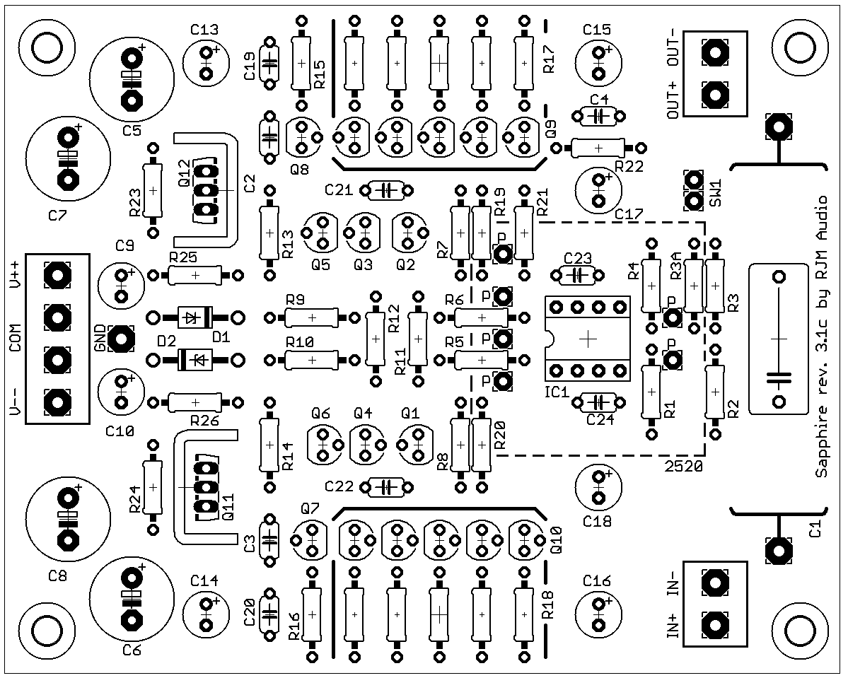

I added the package dimensions (1.1"x1.1")on the silkscreen to give you an idea of the size and position. The pads for the package are there, not labelled at the moment.
Verified the proof of concept.
Is the result basically what you had in mind?
To be honest, 1.1" is a tad small for a prototype board. The ability to try some of these DOA modules though does interest me.

To wrap it up, the layout looks fine! Given that Sparkos can provide what I'm looking for in an opamp, I'm fine with the Sapphire 3 as is. If you go ahead with the 2520 layout, I'm in for boards and will happily purchase them, if you decide not to, that's fine as well, I'll just build the kit I have. :)

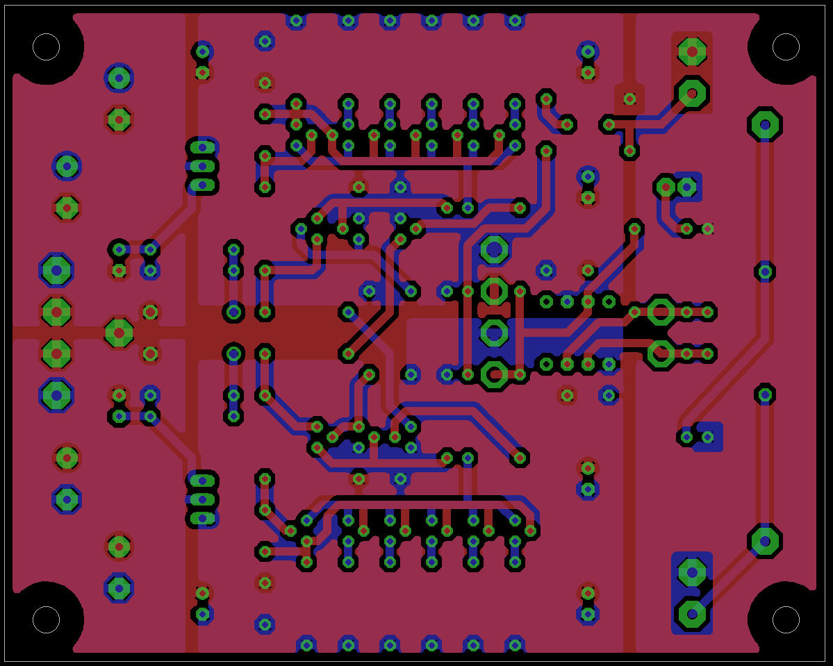

Sapphire 3.1m (Fab-ready, for final review.)
[Sapphire 3.1 is compatible with "2520" footprint discrete op amp modules.]
Custom wirepads to fit Mill-Max 344 pin receptacles.
Moved resistors near the IC to give better clearance around the pin receptacles.
Removed R27,R28 and C11,C12 from the schematic.
General nip-and-tuck for the traces.
Triple-checked 2520 outline and pin positions.

Hi Richard,
I was thinking about another improvement that could be conisdered later on.
As we know not all Pre-Amps have a good phone amp, while the Diamond buffer in your amp is quite interesting.
So the thought is to make an optional switchable input to the Diamond buffer on the amp board, so that
1. It can be feeded from headphone amp
2. It could be feeded from a pre-amp
Allowing to build in this headphone amp in a pre amp unit, as a result you can get a good pre amp with great headphone amp functionality.
if the switch functionality is not used, the headphone amp can be directly connected to the Diamond buffer.
Do you think this is an interesting area to explore ?

Thanks for your comment.
So you want a switch to bypass the volume control and voltage amplifier parts the Sapphire? Is that right?
I am thinking of offering the buffer circuit of the Sapphire as a standalone board, possibly with voltage regulation but most likely without. Would that be of any interest? You could add it more conveniently to existing equipment like preamps, or mix or match power supplies and voltage amplification as you like. It could be set up as a line buffer or headphone driver, depending on the configuration.
Trying to put in a jumper/switch between the op amp and buffer is doable, but I'm not sure enough people would be interested to warrant the additional complication that everyone who didn't want to use the feature would now have to wire a shorting jumper.
