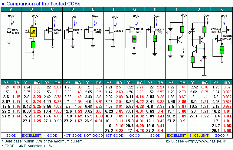

If I were you, I would lose those fancy LM317 current sources. I've found LM317s used in that way to be hiss factories (even though the LT versions are probably quieter than 317s from the usual vendors). Depletion-mode mosfets are much quieter, and will be better current sources over a wider frequency range. If you don't go too crazy with the current, you could possibly use a TO-92 device like the Supertex DN2530N3.

With regards to the current sources, I picked the lm317 as a convenient option (or as I read Juma recently say "to save on shoes") as I have a heap of them here and it was an easy and lazy solution. There's a thread here on diy audio containing an image comparing a variety of different current source/sinks and this solution was amongst the best in terms of accuracy.
I hadn't considered the noisiness of them though.
Depletion mode fet's aren't something I have in the parts box, but I'm sure I can come up with a slightly more complex solution easily enough using whats on hand. I'll be a pretty rough point to point effort initially anyway...

edit - added pic of current sources and their effectiveness. I'll probably use (I) now...

Somewhere on Diyaudio there a link to a study of current source circuits that include Ixys and Supertex depletion mode parts. They are quite good by themselves, and even better cascoded. The tester looked at capacitance and output impedance vs. frequency. If you can't get the depletion mode parts, a bipolar-mosfet ring-of-two source could be a contender.
Here's Gary Pimm's examination of several current sources, including depletion mosfets (they fare pretty well). Stray capacitance considerations for this application are relaxed comapred to Pimm's intended purpose (plate loads for vaccuum tubes), as there is no appreciable voltage swing across the current source when driving a folded cascode. However, the current source must be reasonably quiet, as any noise will be dumped straight down through the cascode transistor into the gain resistor.
Pimm CCS URL: CCS performance measurments

And here's a follow up from Jung where he specifically apologises for not addressing the hiss in the lm317 current source and specifically states that they're not suitable for user in a line stage. http://www.waltjung.org/PDFs/Sources_101_Letter_Revisit_0409.pdf
Interesting, I did not search he had revisited the 317 issue. I remember I had built that hybrid CCS and when I tried it as anode load in a line preamp it was hissing. I might actually still have that module somewhere in a parts box.
