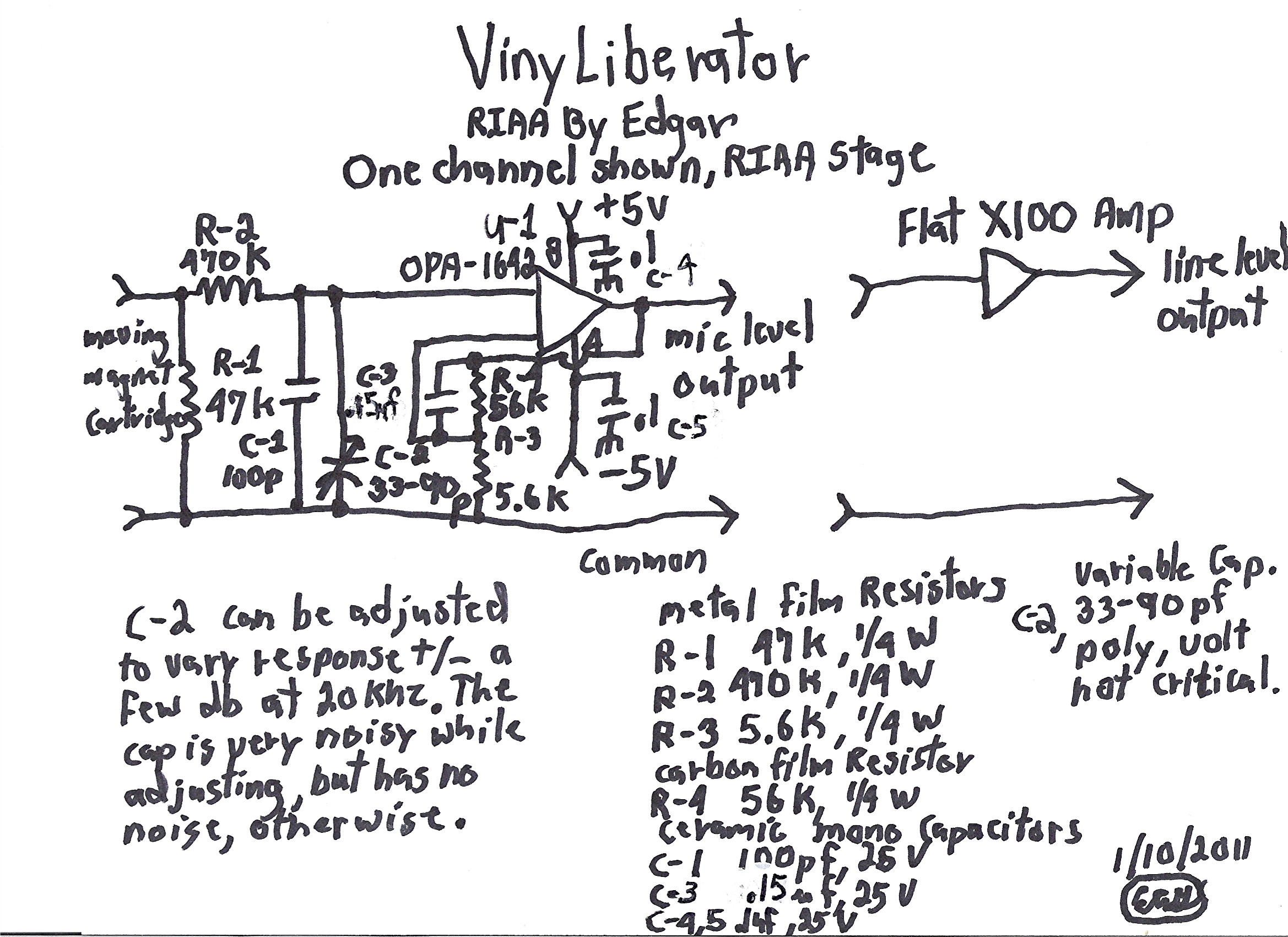

You ain't lived 'till you wired an OPA1462AID to an 8p DIP socket to adapt it to plug into an 8p DIP socket! Changing U-1 from TL072 to OPA1462AID and changing R-1,2,3 from carbon film to metal film seems to have pushed the noise floor down a few more db. It's hard to read the output noise on the scope because I have about 10mv p/p of ps switching/amp noise and I can only see it for a second or two by unplugging the ps and reading the noise while the filter capacitors hold. My best guess is 5mv p/p noise and most of it should be below 1khz, against a peak output level of 2v p/p.

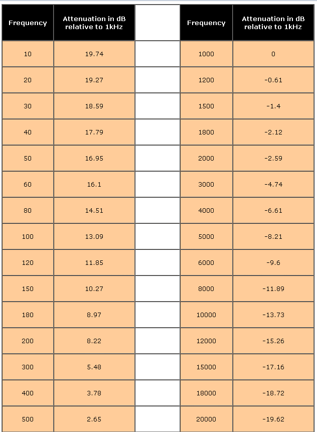

RIAA for my reference

Happy New Year and many blessings Joachim, Jurgen, and Forum Guys. The Turntable/DIY Pre-Amp bug has bitten me and I'll be grooving for years to come, as those old vinyl records just sound so good!
Good Dog!!!
Woo-hooooo!!!, even with an oversize soldering iron tip, the Brown Dog SO-to-DIP-8 Adapter made easy work of adapting National Semiconductor's high performance OPA-1642 Audio OPAmp to fit in my VinyLiberator board! With metal-film resistors in noise-critical areas, component values adjusted, and switching PS shielded, I get proper RIAA with C-2 about mid-way open and have 2.5mv p-p noise voltage, referenced to 2v p-p output level. That ratio would probably be better if my scope had been LPF at 20khz and rejected traces of PS switching noise and above-band opamp noise. Sound is nice and I'll do a You Tube soon!
