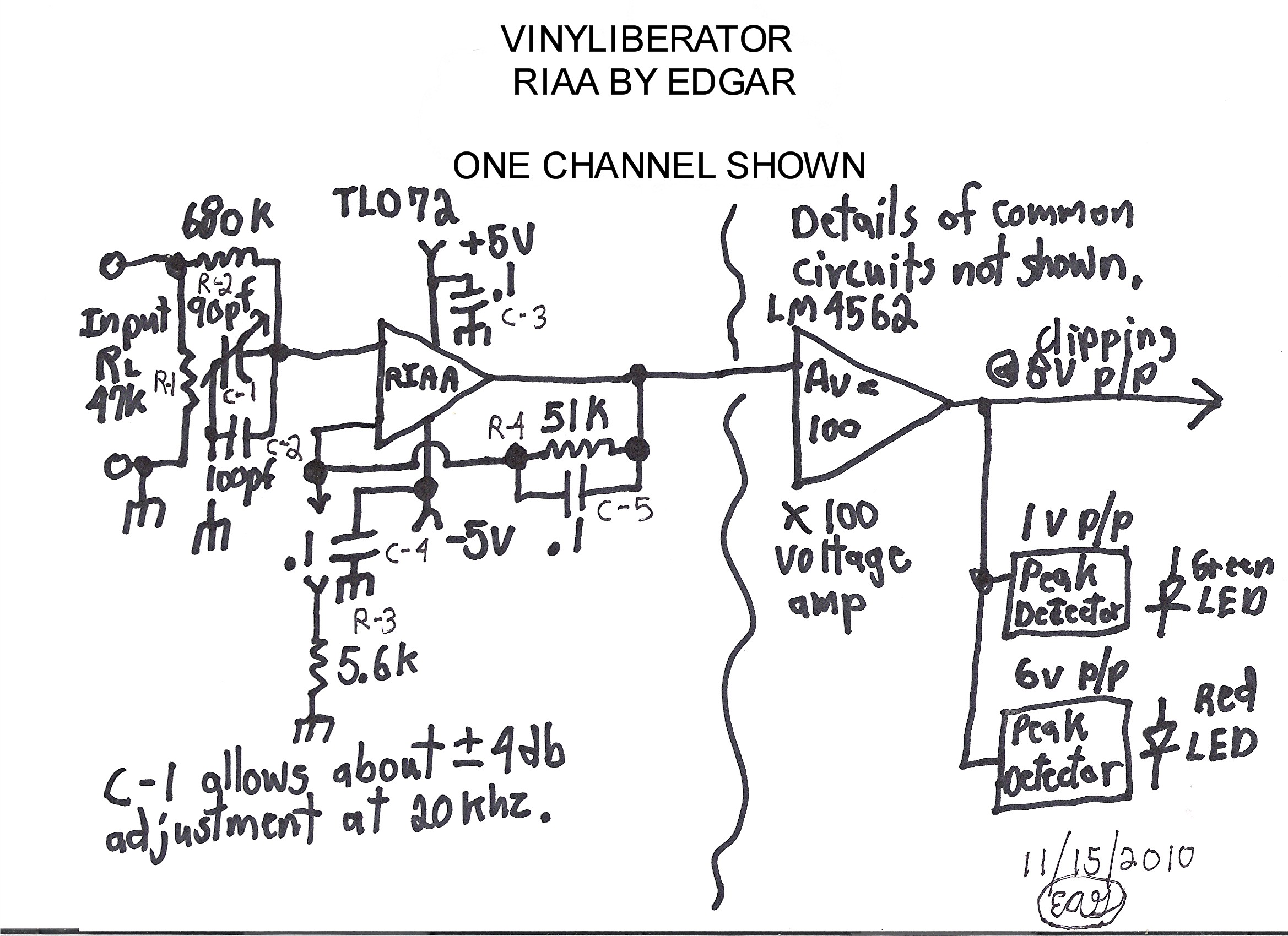

Hi Guys, I've been running a much quieter version of my VinyLiberator preamp for about a month, now. I'm feeding U-1 directly from the cartridge and load resistor. The passive HF roll-off network is now after U-1, filtering U-1's noise by the RIAA HF roll-off characteristic, and having far less Johnson noise, as the resistor is now only 5.6 K (100K pot, across for HF trim). The capacitor to ground is .02uf and the pot sets resistance for correct RIAA HF roll-off. It sounds a good 20db quieter. Switching supply noise keeps me from being able to accurately evaluate noise performance. I'll post schematics and do a world-wide You Tube eventually. I do want FAR Circuits to run me some blank boards, so I'm looking to design a simple, low cost version of my preamp and have FAR run me some blank boards late summer or early fall. Thanks Guys!
Attached: Rough, Working Schematic, cleaned up a bit

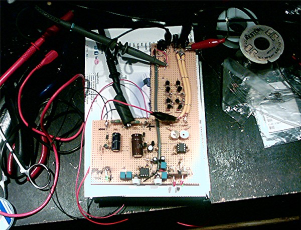

VinyLiberator Blue Collar Economy Edition
Hi Guys, here's a shot of my new edition of the VinyLiberator Pre-Amp. It's a simplified, low-cost version, that has no level indicators, and has adequate low-noise performance while using a pair of economical TL072's for amplification. That rascal is designed to drop into an old Westell modem case, so it looks cute and sharp, when fully assembled. You Tube video should on in a couple weeks or so.
