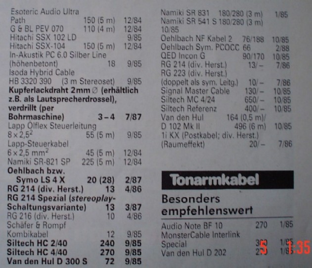

audiotux said:RG 214 is a good cable for both cinch (Interconnect) and Speaker -Cable !
Make that bi-cabled RG214 for speakercable.
Shield from one cable together with the core of the second one.
audiotux said:yes that was the stereoplay-version ,
2 RG214 - Cables the inner lead is + and the shield -
on both sides cross the - than you have a low R and
a low inductance - Cable !
There's still capacitance.
Unfortunately, very low inductance means high capacitance.

In those years the German Stereoplay magazine started their own cable tests including a comparison with industrial off the rail cable.
I went to visit a DIY audio shop in Essen, Germany, in 1987 to have a chance of listening to the stuff i had been reading about in the magazines. Each and everyone of the audio stores in Germany had the Tiden Bara Gar test track the Stereoplay magazine used, song by Therese Juel, Opus 3.
In Düsseldorf, also Germany, i managed to buy 80 feet of RG214.
Brought it home, took me 3 months to get the right kind of connectors that fit the wires, soldered them on the dual cables, and put woven sleeves around each pair.
Looked like a fancy cable, felt like one, and cost me $125 for a 20 feet set. Which was like 1/4th of my total monthly student allowance then.
In some 20 months from now i will have been using that same set of cables for 20 years, that is a little over $6 write-off for each year.
I've never occupied myself with cable stuff again, talking about coaxials now merely for sentimental reasons.
The ones occupying themselves over and over again with cable issues must have a masochist urge, imo.
Nevertheless, as the Double Dutch guy i am, the price for RG214 at the cable store Audiotux posted is so cheap, i am convinced i need a new set of bi-cabled RG214 shortly.
