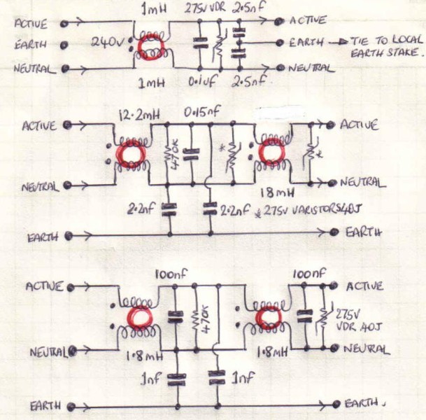

The culprits
We are discussing the "culprits". Let's look at what they do to the mains.
CFL- it's SMPS usually is a resonate circuit at 40-300khz. To keep costs down .. little or no RFI filtering is employed. One big hit on google for RFI issues associated with these "ecoidiot" devices. Compact Fluorescent Lamp
PC's - big bloated 600-1KW SMPS with dubious filtering. Some are better , like my Antec 600 watter ... a good multistage common mode filter on the AC. Still even this HQ one's "garbage" can be seen at the power strip with a CRO - (below 1)
Ackadia's power protection section
Cable ground / signal - RFI riding upon shield from cable tv coax? - Electronics | DSLReports Forums Yuk..
Turn on a good AM radio around any of these "culprits" and listen to the "music"
To fix this , since I am going to make a 2 oz. PCB revision to my soft start anyways , why not integrate a killer RFI filter as well ? another good artical -
Audio Noise and AC Systems . I have plenty of "real estate" to use on my PCB , so (below 2) is doable and better than most OEM's.

Don't forget the RFI coming from the circuit components also such as switching DC-DC converters - about 80KHz in this case:
So lets do it , I have scoped the output of the typical line filter (the first one in my picture with the 3 drawings above) and it reduces the "garbage" by a huge margin.
Since this is DIY , why not build the 2 stage filter ? (drawings 2/3 above). Should not cost much , maybe 10$.

Way better than most OEM or SMPS. Used on critical equipment (medical/military).
The filter in that paper would never get approved for medical. 9.4nF from line to earth? Anyone want to calculate the earth leakage... Geddoutahere
Well , submit one that would (schematic please). PS , that one is still better than the standard OEM (I simulated all of them with LT)
