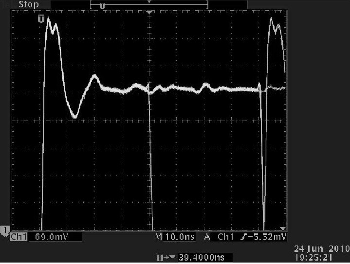

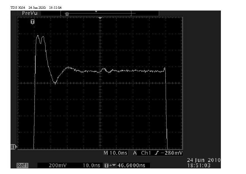

So we could see that reflections are easily detectable even in a more or less reasonably configured setup.
And these reflections are much attenuated, with respect to the signal itself, by an inserted attenuator.
Previously it was not possible for You, now it does not matter, because of the timing.
You want something much more obvious? Just change the cable. In this small world of ours, we all are using the same digital cables, aren't we?
I really would have expected from you to realize that if reflections are there, then their position will depend on the setup!!
The setup otherways is the same like before, in every aspect. I have adjusted the generator to respect the bit timing of a 192 khz spdif signal.
That smaller perturbation BEFORE the main reflection is the secondary reflection from the previous edge!
Second trace is with attenuator.
Last word: padding is an age old engineering trick, look up phase noise documentation from Nist, where they were aiming for really low jitter measurements.

I notice anyway, that you have deliberately chosen not to show the low level trace (i.e, it's off-screen), which makes it impossible to tell what vertical amplification you are applying to get these traces to look the way they do.
This is cheating. It only serves to weaken your case.
Even taking the bottom of the screen as the low level of the trace these little twitches will wash right past a PLL. It will ignore them. They are insufficient to be mistaken for data transitions, even though you have chosen to create a mismatch specifically to exaggerate them. It is extremely unlikely they will be as pronounced in normal operating conditions.
Jitter is specifically the movement of rising and falling data or clock edges around their mean position.
If the reflections were impacting on the positions of the rising and falling edges then there might be some merit to your argument, but your traces clearly show the spacing between the rising and falling edges to be unaffected, and the edges themselves to be clean and pronounced. Although obviously this is only the spacing, it is a good indicator that the repetition rate is unaffected, and it is difficult to see how the positions of the rising and falling edges could in fact be affected by reflections on the line.

In the first graph I have shown the full amplitude. Then I said I'm showing again the same with high resolution. Now I said I'm repeating the same setup, which means in my vocabulary, that it is the SAME, full amplitude included.
Could You please show me where is it that I am cheating? Or is it You who is not reading?
The timing: You said it does not have an influence on the edges. It's in your right to conclude as You wish. It will not change the real nature of the things. Now I had shown just another cable, and it strongly changed the timing. Now shall I get up and search the third cable which will just bump even the main reflection right on the bit timing edge? And we are not talking about the secondary and other reflections. And about the fact that bit timing is a function of the transmission speed, and the data content? So how can You be so sure of what falls where?

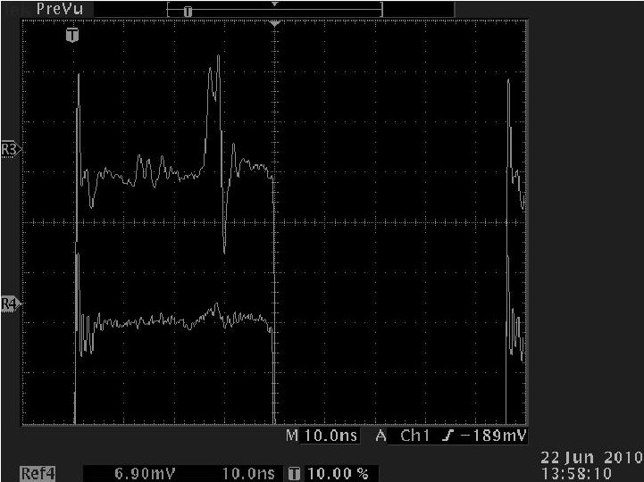

OK, post a before and after attenuation screenshot showing the reduction in jitter (i.e. reflections coincident with the rising or falling edges), rather than just some 'wriggles' in the high level of some pulses...
Oh, and an explanation of how you can tell when reflections ARE coincident with rising or falling edges (preferably using a multimeter).

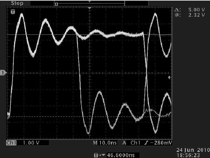

By the way, this what it looks like a Hiface driver connected directly (with a BNC "I" )
to the scope input. A USB extension cable is used for the laptop.
But be careful! The second shot is what it looks like when this "no SPDIF cable" is not terminated well..
By the way, look at the edges, and tell me that they are a strait line.
Exactly this is what happens with the smaller "wriggles" in the previous shots, only much harder to show, because of the proportions.
Ciao, George
P.S.: Compare this "nice" direct shot to the cable+attenuator one.
The small "wriggle' which is left in the middle in both shots, is not a reflection, a perturbation on the driver output.
So I did it, the first shot shows the reflection in the line "coincident with the falling edge", the next shot, with attenuator applied shows this reflection decreased.
That strange thing,
because both seem to show an overlaid falling edge about halfway along the pulse
is exactly what you asked for, the overlaid falling edge of a bit transition, you know, the mid cell level transition representing a logical "1" in the bi-phase mark II encoding.
When there is a zero, the cell does not change status, and the DPO screen shot (Digital Phosphor Oscilloscope, look it up) does show the overlay of all these states.
Anyway, these shots clearly demonstrate that in this line the transitions sometimes clearly happen right in the middle of the perturbation caused by the reflection.
The other shots were not for You. I hope that the people who might be interested in them, will somehow get it.
