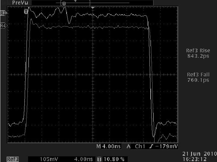

to all those clever theorists
Ok.
Here it is the difference before / after the insertion of an attenuator into a deliberately "wrongly" terminated 75ohm transmission line.
the setup is:
Upper trace
generator - 75ohm line - BNC tee (real 75ohm) - 75ohm termination.
The BNC tee goes into the 1Mohm input of my scope.
Lower trace
generator - 75ohm line - 10dB 75ohm attenuator-BNC tee - 75ohm termination
As you see, the only diffeence is the attenuator. The traces are normalized, so as to see the same percentage of the reflections.
I did not put up here the Hiface driver, because:
-I do not intend to discuss about it's output waveform
-I've put it on Diyhifi.org, please go and see.
The driver used is a 250MHz Hp pulse generator. The rise & fall times, ~700psec are limited by the scope.
The Hiface is only slightly worse, 1.8nsec rise time.
Last but maybe most important note: I show this setup & graphs again and again, because EXACTLY THIS IS the difference what your dac sees on it's input.
Ciao, George

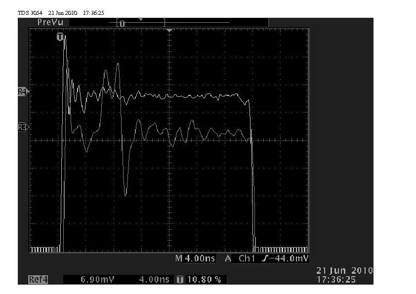

The same with hires
For those who would like to say, based on the previous shot, "who cares"...
Here it is the same setup, same shot, but with high (amplitude) resolution.
Again, normalized. (The shot with no att. was done with 20mV/div, the shot with att. inserted was done, as shown, with 6.9mV/div)
Important: the traces are swapped now,
Upper trace: attenuator inserted
Lower trace: no att.
Ciao, George

Hmm, the rising and falling edges look excellent to me on both traces. I see no reason to believe that either one will perform any better with respect to jitter. The small amount of noise on the first trace is insignificant; it can not and will not affect the Hi/Lo transition in the receiver.
