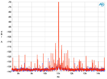

My laptop with either the Chinese USB->spdif straight in or the modified Hiface USB->spdif with both attenuators, run into DCX2496 digital input. DCX analog output run to M-Audio PCI card in my lab computer for FFT. No jitter sidebands seen from any of the sources. 64k data points, 96k sample rate.
I'd expect to see an FFT noisefloor of around -143dBFS for a 16 Bit Signal with 64K FFT bins.
Care to explain why we see something that around 20dB worse than what is needed to not degrade 16 Bit Audio Signals with equipment that is, how did you say, "impeccable"?
I would suggest again to all those reading the thread, compare the measurements taken by JA in stereophile, I believe he uses 16K FFT bins on the AP2, which would produce a FFT noisefloor at -137dBFS and which can be seen quite closely matching the theoretical limits in the FFT Plots here:
Stereophile: Lindemann & Stello USB-S/PDIF converters
And what's the deal with that huge (for a competently designed solid state device) HD?
It should be noted that no-one considers the Musical Fidelity X-24K DAC used in these tests at stereophile is not generally considered impeccable (actually, I consider it a bit a p.o.s. and it's over 10 Years old), it uses a PCM1716 DAC, which has a much worse objective performance than the Chip's Behringer uses in the DCX. Yet it shows much lower noise and distortion than this supposedly "impeccable" setup.
In fact, if a J-Test had been performed and not a simple HD measurement the majority of the jitter sidebands shown in JA's measurements in stereophile would have been hidden below the noisefloor.
More-so, given the "cheap chinese USB converter" uses a device from the PCM290X which produces huge amounts of jitter (which is well documented) that even the CS8420 ASRC (whose ability to suppress jitter is also well documented) cannot properly clean up it begs the question where this jitter has disappeared to in these measurements, because it should be visible even with this poor noisefloor and just an HD test.
I had expected the measured result to be bad, knowing what do about the "test" gear involved, but there is no reason it should be as appalling as what is shown and I feel it demands an explanation. Just looking at the posted result I cannot but feel "it smells very fishy".
You would, why? I've never gotten that with a home brew 16 bit measurement. More like -130dB real world. And I tend to use 32K bins just for speed anyway. Of course I don't own multi-kilodollar AP gear, either. And I see about 5-6dB difference in noise floor from a DCX with active and passive outputs.
Do you think that jitter would not show up with a -120dB noise floor?
Do you mean harmonic distortion? Is it that bad? H5, H7, H9 are higher than they should be, but it's a cheap 3 opamp circuit with an electrolytic coupling cap. Part of that "Behringer sound."
...even the CS8420 ASRC (whose ability to suppress jitter is also well documented)
So are you saying the DCX suppress jitter? Isn't that a good thing? Not for this test, of course - but if you mean that the DCX in not valid for a jitter test because it suppresses it, why not say so? That would be very important to the test.
