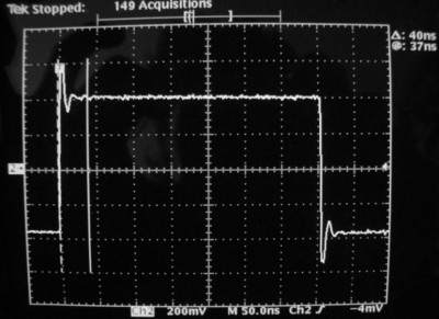

Dear Sy,
I have just seen Your scope shots. Something is not right here. I think You should go ahead and try until You reach at least the same results what I have done and Jkeny's friend has done. Because the Hiface driver does not have any ringing and other problems, it's superbly clean with respect to a lot of other drivers. I mean, apart from the initial - and only - overshoot. Which is not ringing, it's an overshoot.
(that is, I could go deeper and show "structures" in the signal but not at this level.)
By the way, I think to see in your scope shot a lot of reflections.. or ringing caused by your scope probe.
The order is: Jkeny's friend then mine then Yours.
I'm not attacking You, but now we are talking about simple and hard facts, this is the entry level, if we can not get a common starting point here then we will not get anywhere.
Ciao, George

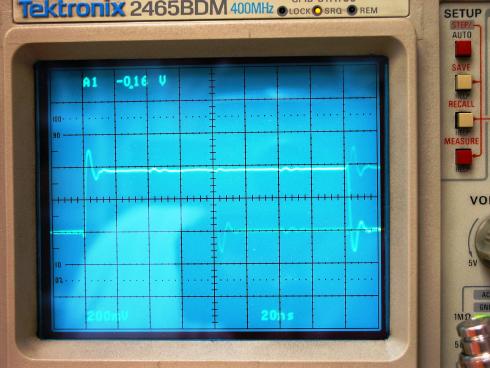

George, did you see the traces for the Chinese unit? Same probe, same setup except with RCA. If I were to guess, it's the transformers in the Hiface. I think John may have also mentioned the same thing.
Just for review, please repost your scope traces for the Hiface (not the HP) without attenuators with a 75 ohm (or so) line and a 75 ohm (or so) termination. Thanks!

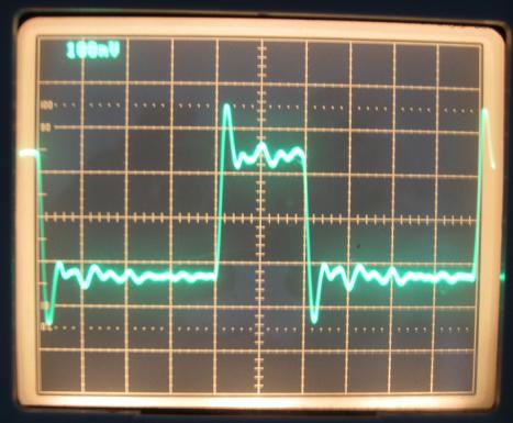

Dear Sy,
I have already posted that in this thread, here:
http://www.diyaudio.com/forums/digi...ttenuators-jitter-reducers-8.html#post2226135
The first shot is a hiface > 75ohm line > 75ohm (or so..) termination, without attenuator.
Or so means that the config in detail is: HIface > 75ohm line > 75ohm bnc bias tee - 75ohm termination, good quality. The scope input is 1Mohm, as should be.
The application of the BNC tee is the factor which upsets (only a bit) the termination, so that it's not perfect low return loss any more.
If it would be, then there would not be anything to measure - if at least one end of the transmission line absorbs the signal perfectly, then there is no chain of repeated reflections created. This is what never happens in a real life SPDIF application.

Sy,
Very good that You brought it up:
The difference is that Your cheap Chinese transmitter is having a rise time at about 6nsec. That is ~58MHz equivalent bandwith.
The hiface driver is having 1.5 nsec rise time in reality. (measured by me on 6GHz, 3,5GHz, 2GHz analog bandwith scopes)
Pardon, the most recently tested unit had less than 1nsec rise time. The older one is 1.5nsec.
At this speed (1.5nsec > ~250MHZ, 1nsec >350MHz ) your test setup has to be much more refined so as not to cause reflections. This is the difference what You see.
