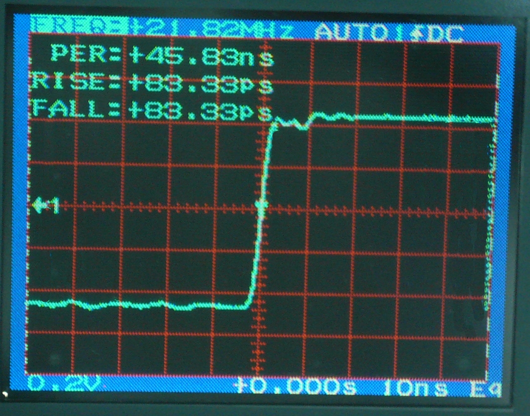

The SPDIF output trafo used is a 2:1 Murata 78604/1C
It's worth showing them here too as I believe they clearly show the effect attenuators have on the waveform:
Without Attenuators first
With Attenuators:
And from Joseph K:
Stock Hiface without attenuators:
Stock Hiface with attenuators:
By gosh. This is BAD. Sure, there is even worse, but that is such a bad result, no wonder the (near) stock Musilands often sounds better! It may have wrong impedances and levels and a noisy output, but it is not that bad.
Here, strictly for fun, a tube driven, transformer coupled SPDIF output from me, at 48KHz Btw. Before anyone asks, this is not the Lampizator design, not even remotely.
This is driven directly of the FPGA Pin on a modified Musiland PCB and it includes 2m of Gotham Cable 75 Ohm Coax and Canare RCA Sockets and Plugs (the so-called 75 Ohm variety) on both ends. The termination on the receiving socket using a pair of 0805 SMD 150 Resistors, to minimise inductance, scope probe correctly calibrated and set to 1:10...
So, if you wire your DAC's input well and correctly, this is what the receiver would see, or at least as close as we can make it...
Using a terminated RCA Plug directly on the system output looks much better, but is of course meaningless.
The Zoom level shows around 1/3rd of one square "wavelet", so this a much closer up view of the leading edge than most of the shots we see posted on-line, just in case anyone needs any references for scale.
Ciao T

Thorsten, I've investigated both the Musiland & the Hiface & in stock form the Hiface easily beats the Musiland sonically - go figure. Obviously the above doesn't tell the full picture of the sound. I've modded the Musiland (detailed in this forum) & I would say that in modded form it comes up to about the sound of the stock Hiface.
So agreed the scope waveform does not look good but there's something else going on not shown! Of course all this can be improed & I have scope shots similar to what you show.
Remember those two ol' codgers that sat on the balcony of the Muppets show & criticised everything? :) Well here's Cartman & Snotgreen (some residue left after Jocko sneezed, I presume) - have a look at their comments & have a chuckle Probably none of our business............. "What do you think of it so far?" ; "Rubbish"
I think the "A beats B" depends heavily on the context. Both Hi-Face and Musiland have severely "faulty by design" SPDIF implementations. So which works better has to a degree at least to do with the rest of the system. And of course with the PC setup itself. For example, HiFace is limited to Kernel-Streaming, which may or may not have an impact (hard to predict)
I have both devices available. Once you fix the main issues in each there seems little to choose, except for Musiland offering ASIO.
With the SPDIF output as designed the HiFace actually needs an attenuator to comply with SPDIF standards.Several of the truely high erformance options for SPDIF receivers will seriously struggle with the original signals from both HiFace and Musiland.
The usual "App-Note" cirrus logic circuitry will barely lock on the Musiland's (which will generate rather high jitter) low signal levels, while the generic cirrus logic circuitry which is optimised for 5V PP AES/EBU levels will love the rather strong signal level from the HiFace.
On the other hand, sensible active SPDIF input circuitry (like I use) that deals with the low levels from a stock Musiland very well will saturate with the hi-face output and throw major wobbles, causing high jitter.
So making any such comparisons without stating the context is of very limited use.
Hence the pains I took to illustrate my test conditions. And again, please remember my measurements include the cable and the receiver side termination.
Ciao T

Your plot is impressive! You've used a tube OPS, different output transformer as well as some PS changes & other tricks?
Yes, quite a few mods. Powersupplies, clocks, etc.
I see you've used those Canare RCA sockets & plugs but how does one of these RCA sockets perform if being plugged into a non-Canare RCA socket - impedance issues?
To be honest, I have only compared Canare RCA to Canare BNC (Canare BNC does better, but it takes close comparison) and some generic locking RCA Plugs on Canare sockets with non 75Ohm cable (way bad).
But the Canare RCA stuff is not expensive and it is possible to upgrade everything from Source to DAC. Of course, Canare RCA's are not true 75R, but they seem non too bad in practice.
BTW, the way the FPGA Pin's are wired to the Output stage also has a major impact on waveform and thusly to a degree on jitter.
Ciao T
