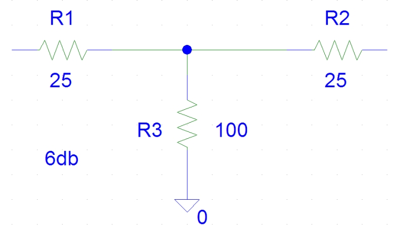

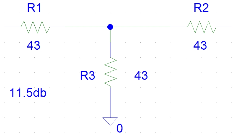

75 ohm Tpad
So I will try these 75 ohm T pads on both ends of the cable to hear what it sounds like.
Cost 30 cents
Sendler, remember this use of RF attenuators is only possible if your SPDIF signal can withstand some attenuation & your DAC can still lock to it without any problems. This works with the Hiface because of it's high output but has also worked on other devices - the Shigaclone, some soundcards, Teac VRDS-10 CDP, etc.

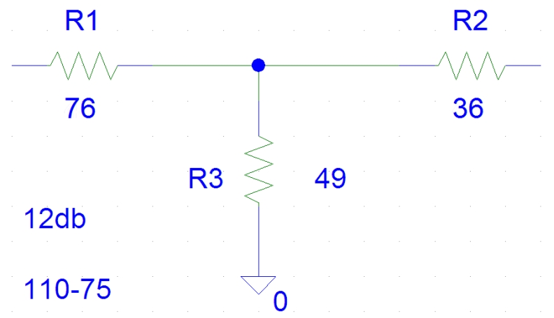

The worst that can happen is that I will lose lock or it will sound worse. At which point, I will have only wasted 30 cents worth of resistors. It may also improve my 110R to 75R XLR to RCA conversion from the AES/EBU output of my DEQ2496 to the RCA input of the Big Dac Board.
110-75 ohm converting cable with attenuators

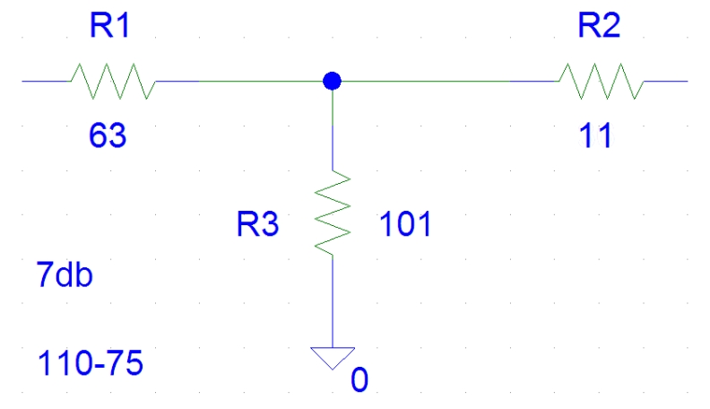

My new XLR to RCA converting digital cable with built in attenuators is playing. Neutrik silver XLR, Belden 1701a wire, Cardas rhodium RCA. Lock from the XLR digital out of my DEQ2496 into the Big Dac Board configured with DIR9001/ CS43122 running direct out seems to be no problem. 7db attenuation in the XLR input and 6db built into the RCA output gave me the resistor values shown below which I had on hand. Sonic comparisons with my old, otherwise identical cable to follow after some hours of break in tomorrow.

As you probably read, the way that the attenuators work in this situation seems to be by reducing the reflections caused by impedance mismatches encountered by the SPDIF signal along the signal path (this includes transmitter, outputs stage, connectors, cable, receiver, input stage, etc). The attenuator does a double attenuation of the reflections because they pass through the attenuator twice on the journey back to the DAC where they can cause jitter. So if you have 6dB attenuator the reflections will be reduced by 12dB. Even so it's probably beneficial to try to minimise impedance mismatches as much as possible & where practical.
You would probably need to measure the characteristic impedance of your RCA connectors & make one side of your T-pad match this impedance. This may be just theoretically optimal & the in the real world you may not hear any difference.

102 ohms cable
Sendler,
I just noticed that your RCA side impedance is 75ohm but RCA is NOT 75ohm (maybe 35- 50 ohm?) so you will have an impedance match between this & your RCA connector.
Many of us are stuck with RCAs so the attenuator values may need to be adjusted. Another issue is the 102R impedance of the Belden 1701a solid core in Teflon bonded pair wire that I am using. I use this as it has proven to sound better than any of my other digital cables including Apogee Wideye which is a really excellent ready made cable. Radio Shack Gold video is also surprisingly close for even less money. The Memorial digital cable with foamed coax and Canare RCAs sounds really bad despite the components being supposedly top shelf. I keep it around just to show people how much difference there can be between digital cables. It sounds very slow and opaque. Boring. Generic cat5 pairs don't sound that great either. I have also tried countless scraps of various video coax without good results and anyone using stranded coax for analog interconnects is missing out compared to the bonded pairs of 1701a. It is also interesting that a good spdif cable will still sound a little better than an optical connection from the same source and dac.
So I will stick with RCAs for now and also continue to use the Belden 1701a. I am happy with the sound of the attenuation values for now but might hope to make it even better by tweaking the values to get the best balance of performance from my non 75R components.

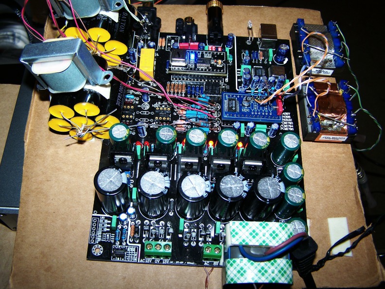

Big Dac Board
the real world is not a physics lab & certain compromises/best fit solutions have to be found. If you have these T-pads on the ends of your Belden cable would it be worth changing the T-pad impedance facing into the cable to 102R?
That makes sense to set the cable side to 102R since I have T pads on both ends of the cable. I will also have to try 50R on any side that is connecting to an RCA. I am intrigued enough by this concept to make some tiny circuit boards to hold surface mount resistors which I will be able to change out easily.
What DAC are you using?
I have two Big Dac Boards that I can run in identical configurations so the last interesting test would be to change the terminating resistor for the RCA on the dac board to 50R to hear if that sounds any different to the 75R that is there now.
