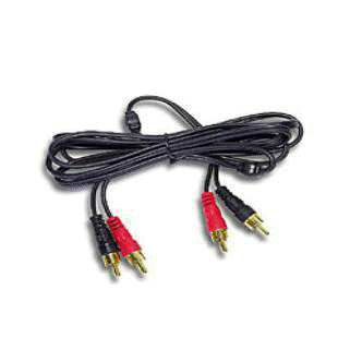

I have Rega Planar 2 and RB250. (Denon DL110 cart)
Is there DIN-plug inside pivot/tone arm? Can I change ext cabling just with 5-pin DIN -> 2xRCA-cable? Or is wiring unbroken from cart to rca-plugs?
I' using additional extension RCA-cable with my Planar RCA-cable so that it reaches to my RIAA (RIAA is Creek phono card inside Creek amplifier, so I can not move RIAA). I would like to get rid of extension cable, it certainly would not do good for sound? :(
Is it possible to re-wire internal wire of RB250 or should I just cut original cable underneath to plinth and solder better cable in right length and better plugs. If there's not DIN plug?
What would be good cable? Cardas has AWG33 tonearm cable for ext re-wire. LINK
Would ordinary Tasker C850/C208 etc be good if I change just external cable by cutting original cable?
So for so many questions! :bigeyes:
-Ali
Hi, inside the base of the arm the tonearm wires and the external interconnect are soldered to contacts on the inside of the black plastic plug that fits in the base.
If you undo the M3 screw in the bottom of the base then it is possible to pull the plug out just enough to get to the solder contacts. You can then unsolder the plug to change the wiring. If you just cut the interconnect wires coming out of the base you introduce yet another solder joint.
