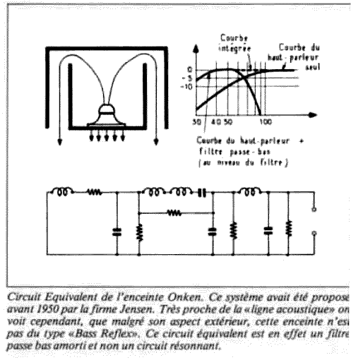

Oh well, it will just make them even more 'colorful'/damped/TL like in nature as whoever made the drawing below erroneously believed.

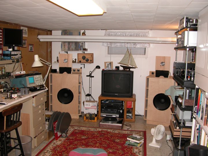

Yes, unreservedly.. I'm using the Iconic version of the late 515 as I have mentioned, and I am pretty happy with the end result after 4 yrs of continuous use. Think I said this all before..
Please PM me with an email addy and I will send you the relevant spreadsheet as I mentioned in an earlier post. My design is similar but not identical to the published design.
On the mids I have JBL 2440 drivers on 2311 horns with 2308 diffusers - in my room this provides the best compromise in directivity and very good transient response. (I listened to Smith horns, tractrix and exponentials as well) On the top I have JBL 2402, and also tried the 2405.
Thanks, Kevin. Which spreadsheet are you referring to? I intend to use one of the GPA 515s. The original Onken has an Svent that is equal to Sd and uses a slot length greater than 35cm. How is yours different?
John
Previous post where I mentioned my modified version of the debien spreadsheet. Note that the measured performance turned out to be somewhat better than predicted by the spreadsheet so it could be that the original design is a bit more on the forgiving side than it might appear. The original Jensen Ultraflex article if you do not have it may be useful. Reprints are cheaply available on eBay and IIRC I believe there is a least one copy on the web.
The GPA 515 I believe is virtually identical to the Iconic 165-8 so my numbers might be of interest to you.
My slots are several cm shorter than 35cm which is supposed to help ever so slightly with the combing issues. Slots area is just under 86%. My boxes are pretty large with a combined box and vent volume ~ 11.4 cu ft.
