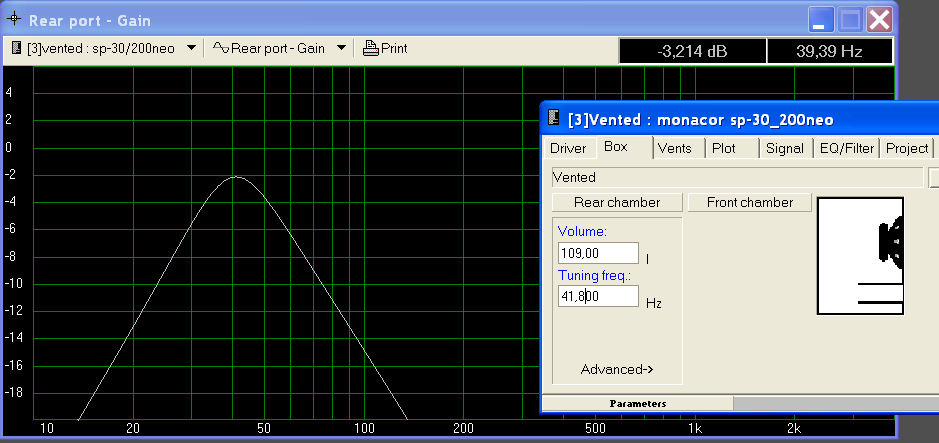

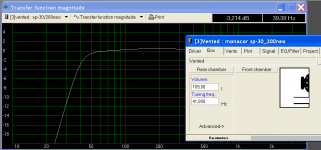

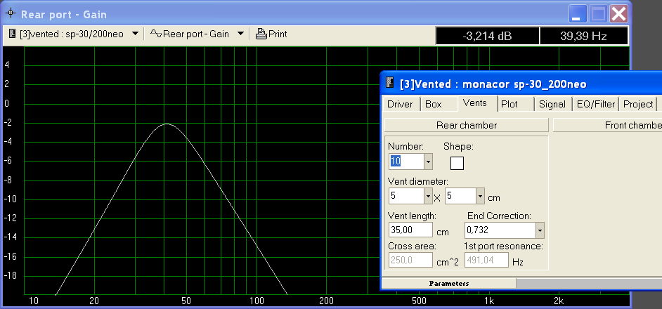

Calculated as above.

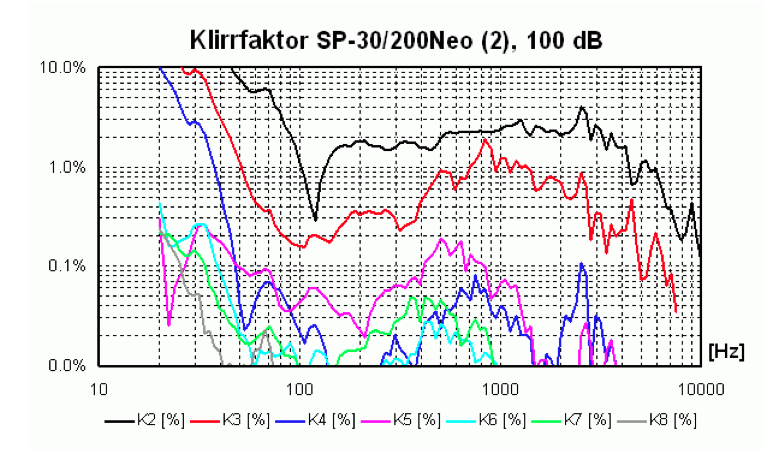

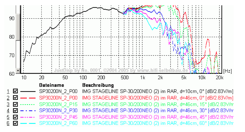

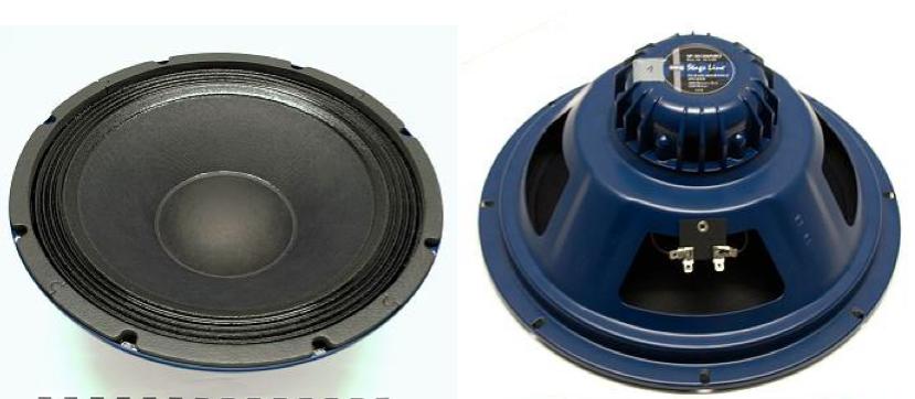

109liters -3dB 30Hz 96-97dB 1wmtr IMG-stageline(monacor) sp30-200neo wil make a great compact high efficient BR-enclosure. I calculated as above only with 35cm port length I have 50% Sd so not the 85% Sd as recomended for a real onken but this one comes close. It will make a great BR this 12" realy gows low and only 110liters= 3,85 cuft.
See the top-level low THD, plot at 100dB 1mtr. K3 <1% at 100dB between 50-700Hz! X-max 2mm perfect driver for low and medium power tube amps.
MONACOR INTERNATIONAL : Product Detail Page
I say this neodium-driver is a bargain for the DIY who want to save big money and get the best available quality.
