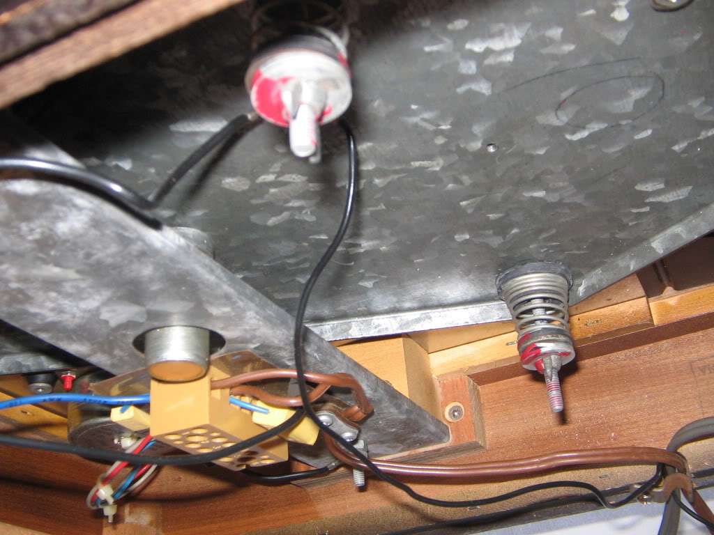

I hope that I will be able to bolt everything together tomorrow. But... I have question about how suspension spring washers should be assembled. In my RD11S there are two washers between lower suspension grommet and adjusting nut. One washer is flat and other one do have some tilt on upper surface. Situation is quite visible in picture I am enclosing. I suppose that idea is to force springs to lean some direction.
My question is now: Should I adjust spring washers to create pulling force against tension created motor drive belt? Or... do washers serve some other purpose.

Try it the Linn way and have only the plain washers. Linn suggested spit as lubricant on the upper rubber part. Carefully rotate the spring to centre it. Any torsion will cause it to unwind in a day or so. Many claimed LP12 went of tune after a few months. They do if set up by many shops. Mine is 1989 and has been tweaked once. It took 4 hours to build up when new. 1 1/2 hours was considered how long it should take. Linn said 15 minutes if knowing how. Nonsense. The whole LP12 has to come apart and everything checked. 90% of the time all the original parts could be used. I would say the LP 12 as supplied was a pre tested kit.
Place the longest spring near the motor. The most round to the front ( being round is almost a defect !! ). The spring with most offset to the arm base. By carefully trying with belt fitted a perfect vertical bounce can be found with minimal gyration. This has the better possibilities sound wise. That is it favours the vertical information. It should also aid rotational problems. When the arm cable is fitted the movement should not change dramatically. The arm cable can stop mild gyration. The worst being the bounce stops quickly. Linn found very good quality nuts that are square. I suspect ones could be made with a bolt and file. Or a small tube spacer that is square. Make sure the bolts are vertical. The top plate should be slightly looser than people might imagine as it is part of the suspension. Linn did that by having very small battons ( about 1/4 inch , 6 mm ) . Linn asked the bolts on the top plate be only sensibly tight to ensure the top plate works. Said by them in the 1980's to be 25 % of the suspension. The LP12 top plate was slightly concave. We had a tool to set the bolts to allow both things.
I have set up the RD80's with the intended parts. It is quick and easy. I suspect the Linn way is better.
Looking at your photo I would be tempted to build a Linn type chassis brace and plinth brace. Look at any LP12 photo. On the mid period LP12 the brace was epoxy glued. This is very simple and works. Also for simplicity an aluminium 2 x 1 inch L section brace is easiest to source and make. Use a low strength glue at first if wanting to be certain it's what you want. PVA might be OK. I suspect 1/2 inch plywood would be better. I have never tried it so can't say.

Basically there is not too much to do if the spring rates are correct. You just level TT chassis and sub chassis. You should also make sure that not too much vertical tension is created when springs are adjusted, so sub chassis does float correctly and bounce is as straight up and down as possible.
I found answer to my question about cam washers in Ariston RD11s manual. Ariston asked to centralize armboard in aperture by adjusting cam washers. This means that that springs are also centered in the bushings, if manufacturing tolerances are good enough. Which seems to be the case as this produced nice up and down bounce as you recommended. Whole sub chassis adjustment took about 1 hour to make. I created some tension in the springs as armboard has moved slightly in the cutout, but this has not degraded bounce anyway. I will readjust cam washers when I will remove bottom cover for reinforcing.

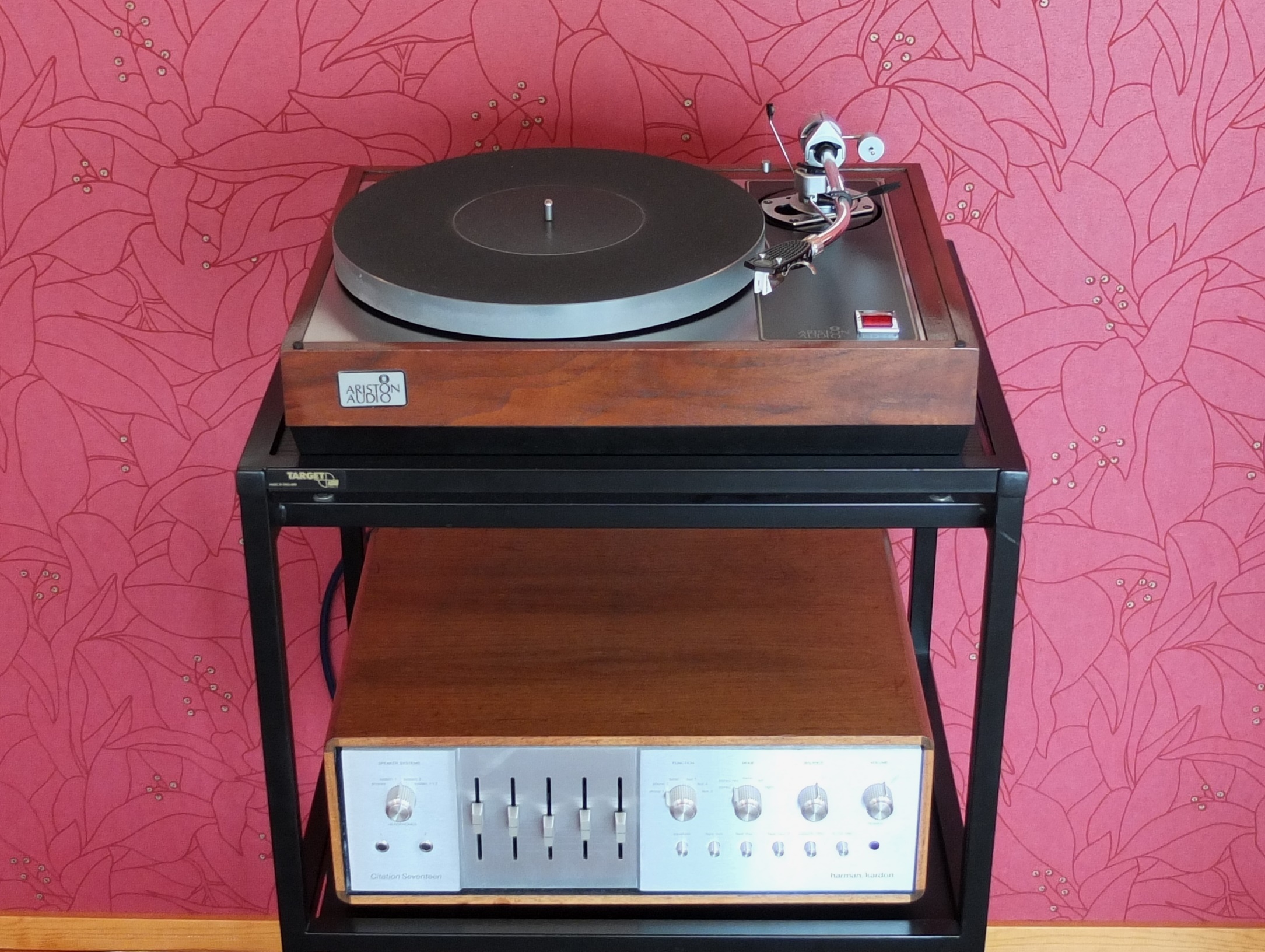

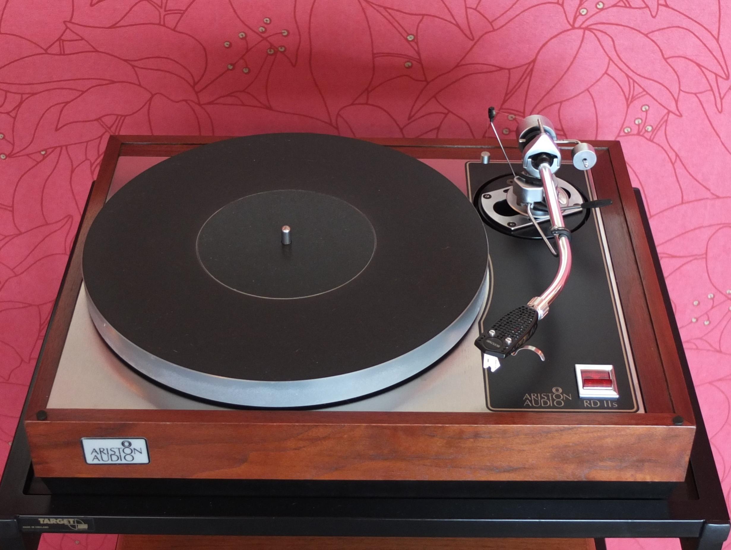

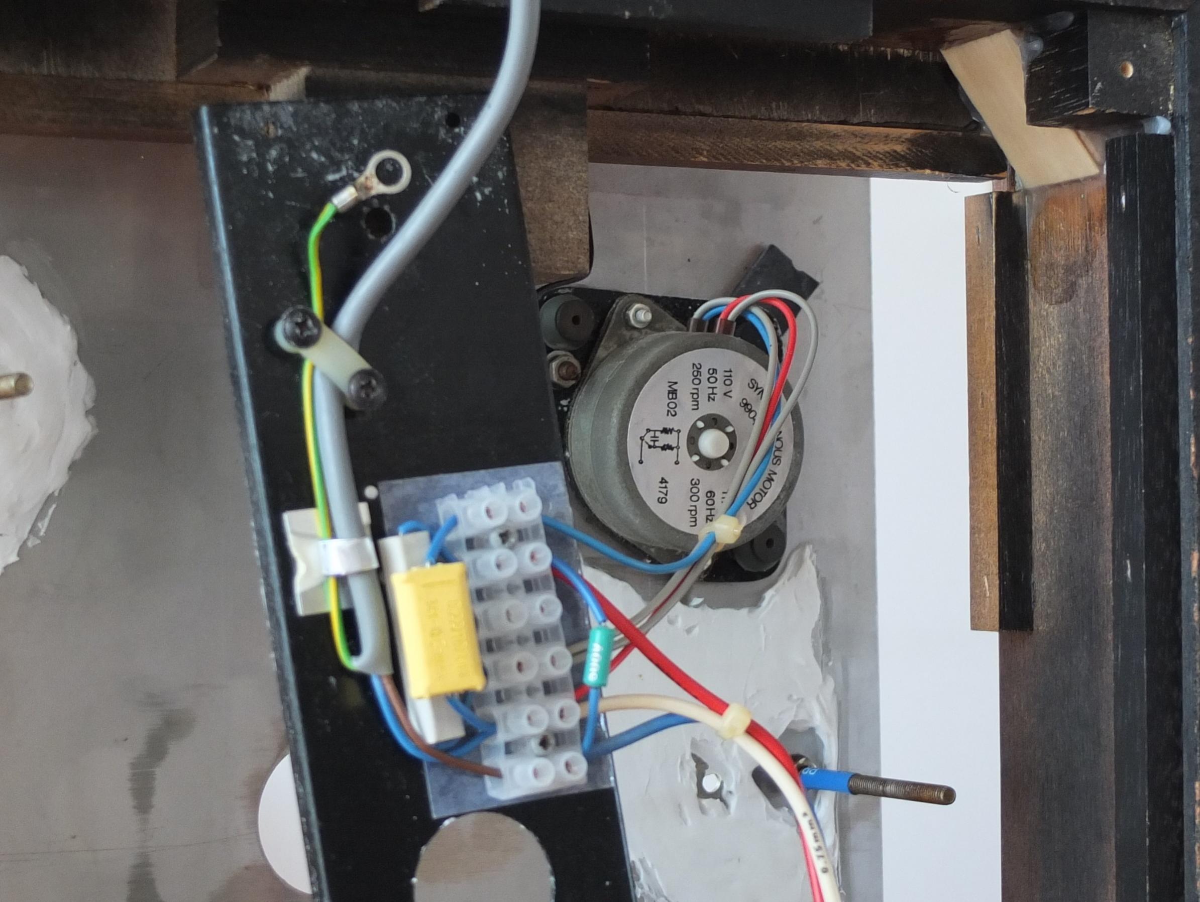

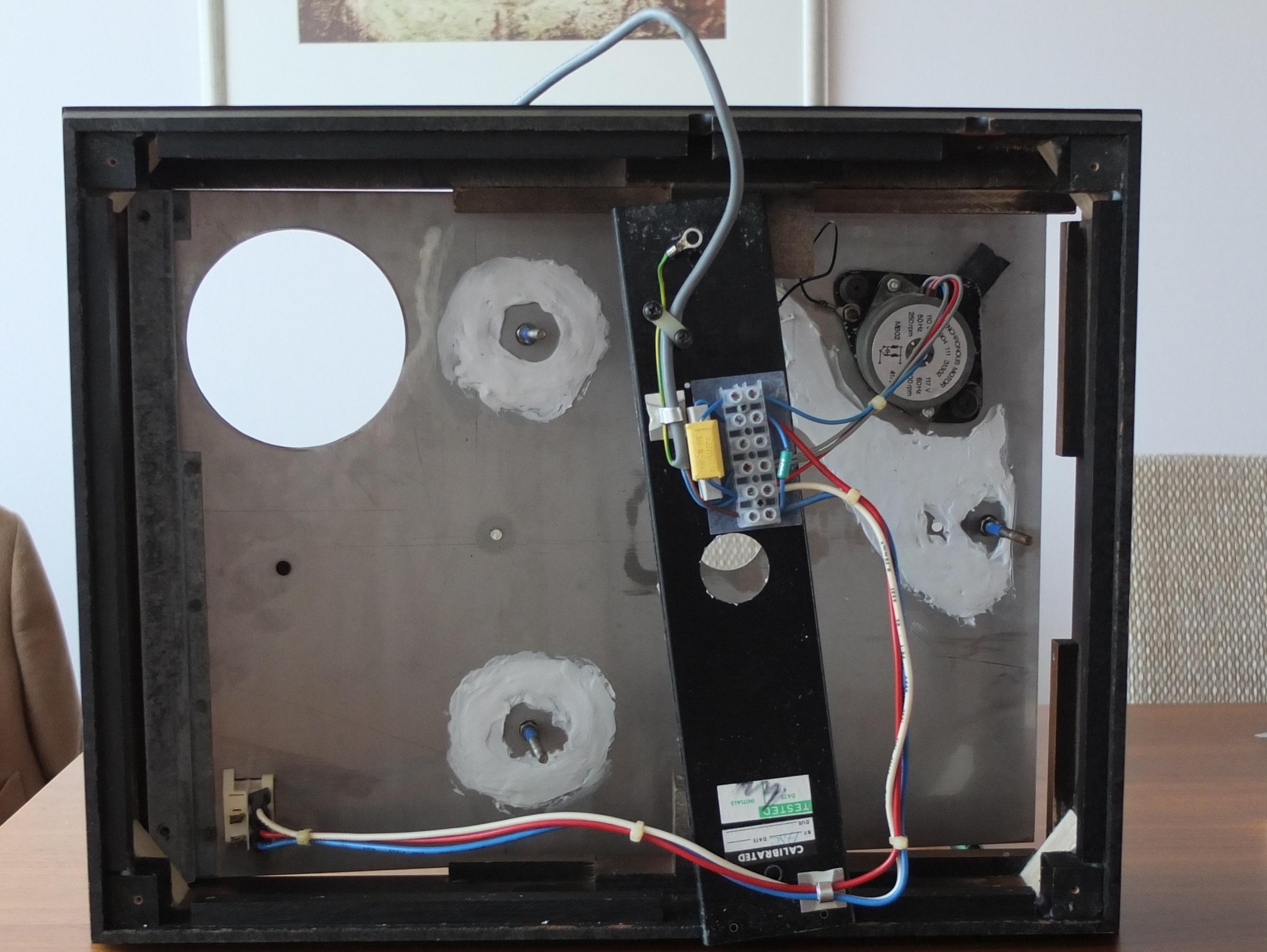

Ariston RD11s rebuild
I promised to send pics about rebuild earlier.
From 1st and 2nd pic you can see that I covered upper portion of mounting bolts with heat shrink tubing to ease suspension movement when disturbed. Also smallish corner blocks have been added to reinforce old plinth. I covered area around spring mounts and motor with acrylic putty to dampen resonance. There is also layer of putty behind chassis brace. I used acrylic putty as it is less messy and easier to remove than other materials. Motor does have 1979 date code so deck has most likely been made in 1979 or 1980. Does anyone know if RD11 was made same time as RD11s as there is RD11 sticker on chassis top plate?
From two last pics you can see that plinth, that looks to be veneered with rosewood, is now quite clean looking. I used mixture of boiled linseed oil and pine turpentine along with steel wool to rub plinth clean. Veneer now looks old, but it is fairly clean. Build quality of deck is rather good. Only sign of BL like build of this timeline is Ariston Audio logo, that is slanting slightly to the left.
