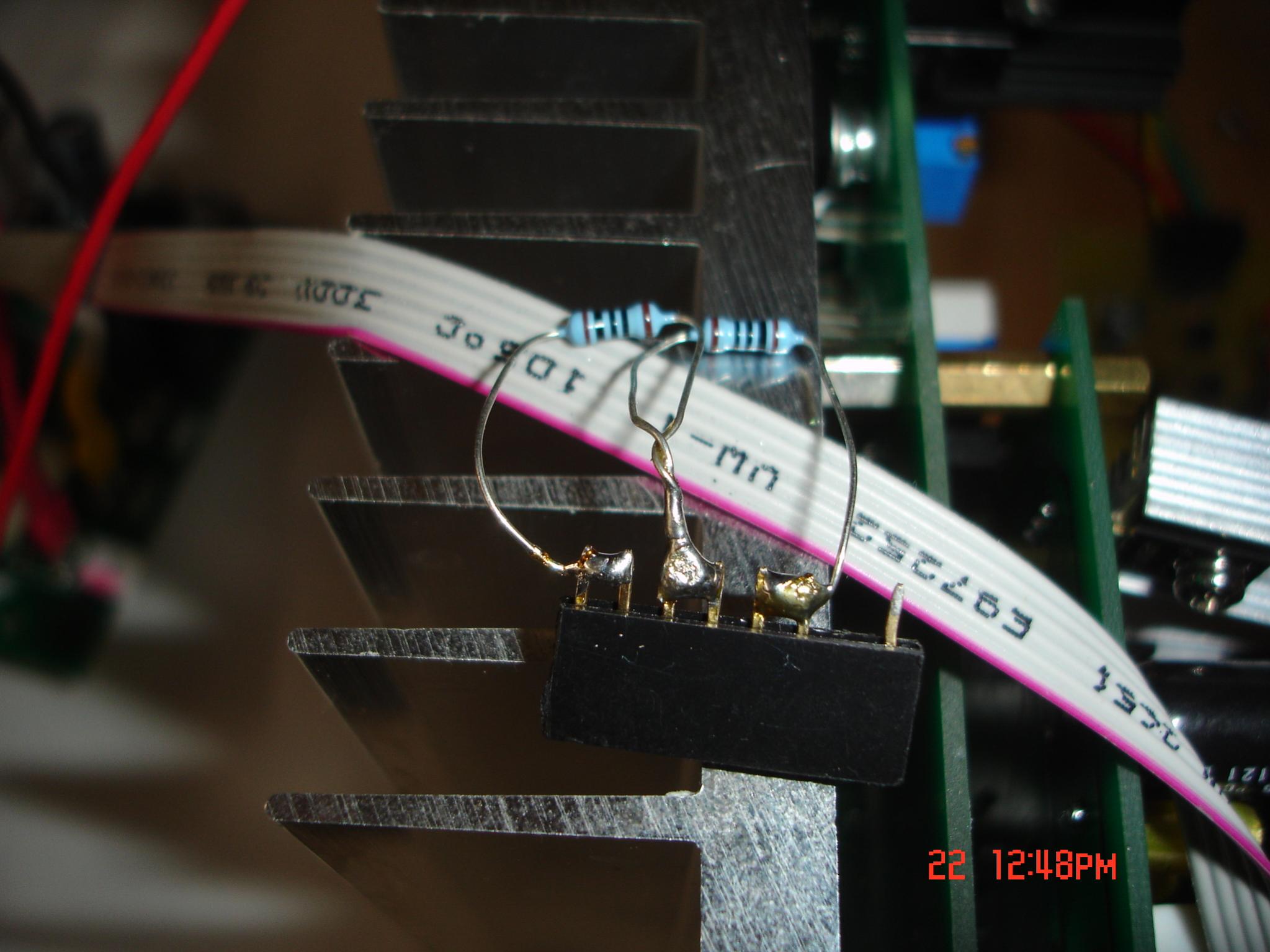

I guess I will wait to see if you come up with new ops boards. One question, to test the ips boards, can I just short all the pins together?
Hi Terry,
Yes, no problem - you can short PD+, ND- and NFB together and treat this node as a front-end's output.
