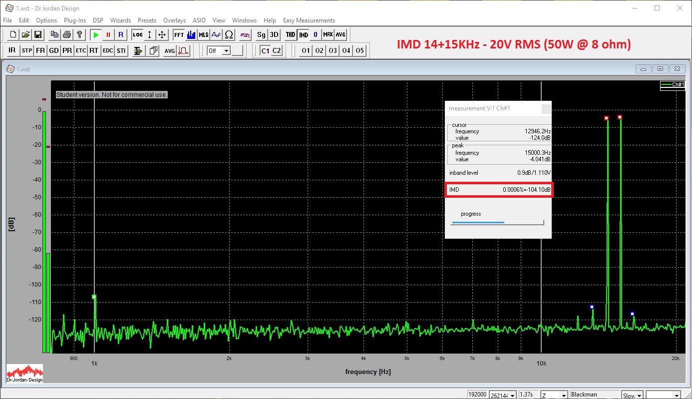

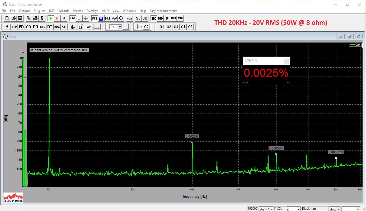

This is the Indermodulation distortion test.Could someone please explain pics #3 and #4? Where do these spikes at 300 Hz and 8 kHz in #3, and those between 10 and 20 kHz in #4 result from? Thank you!
Best regards!
We drive the amplifier with a two tone signal,one tone is a 250Hz signal and the other is 8Khz signal.Anything between two basic tones are <<generated>>into the amplifier and that is we call indermodulation distortion.
The same for other two frecuencyes 13Khz and 14Khz.
I hope that is a simple explanation.

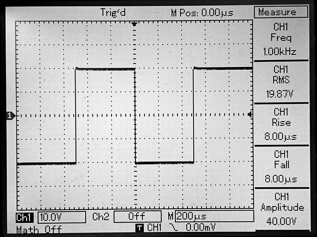

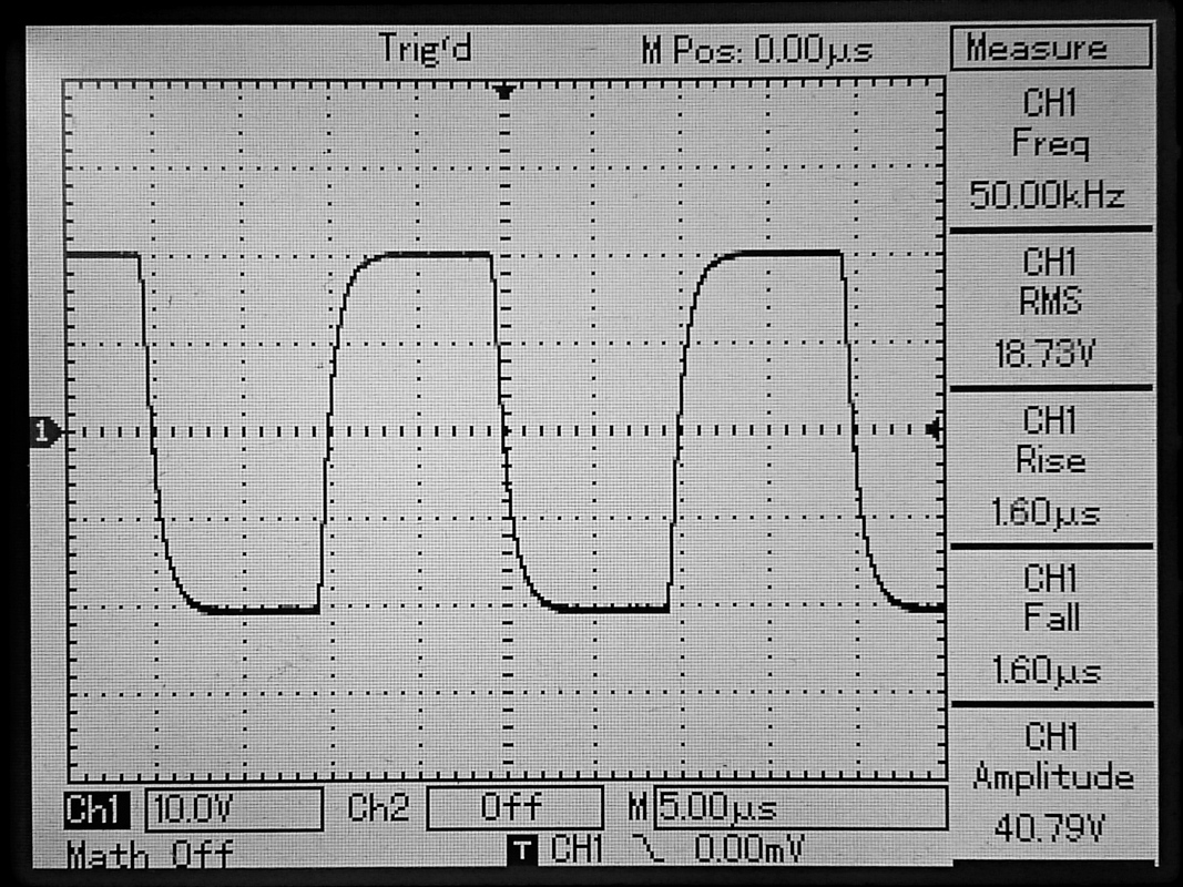

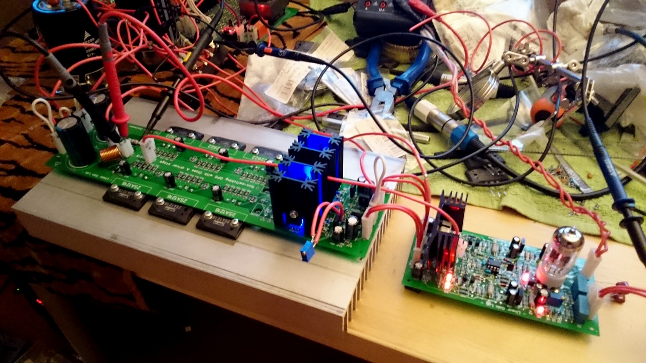

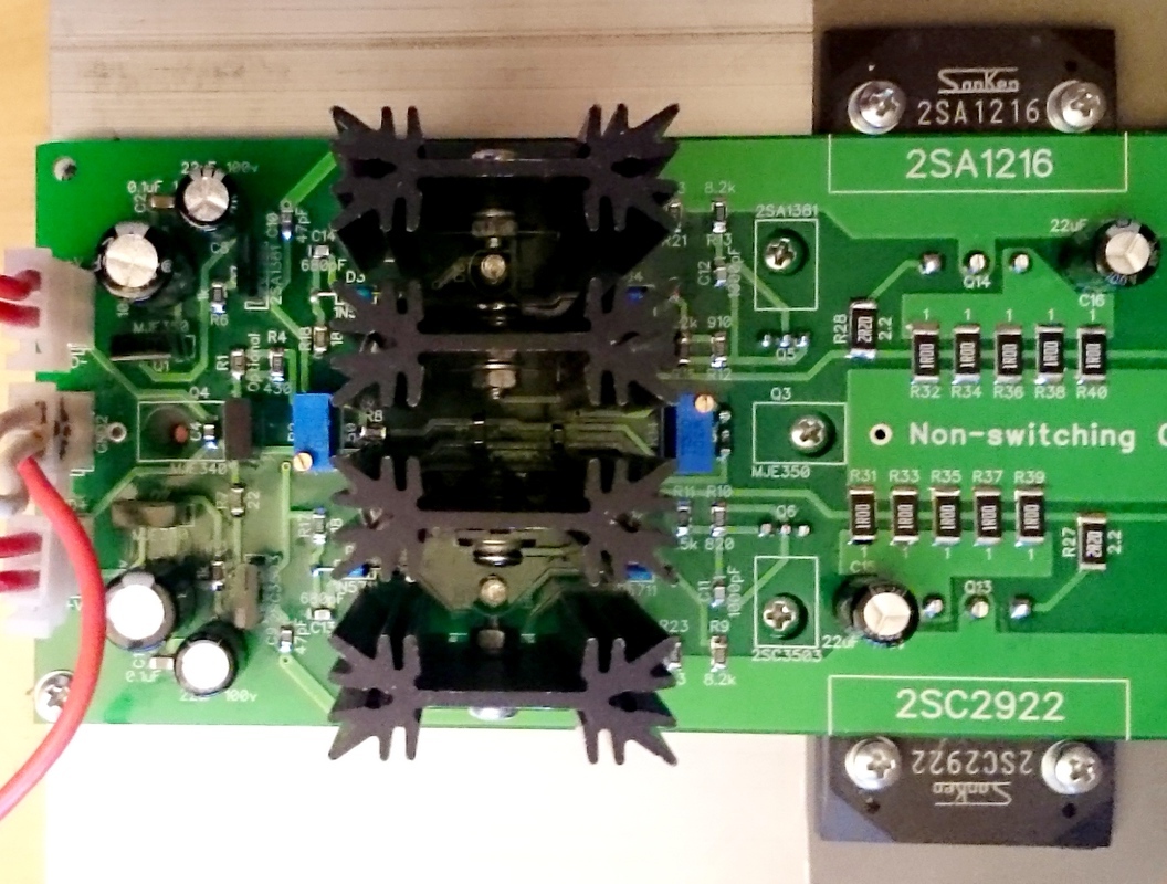

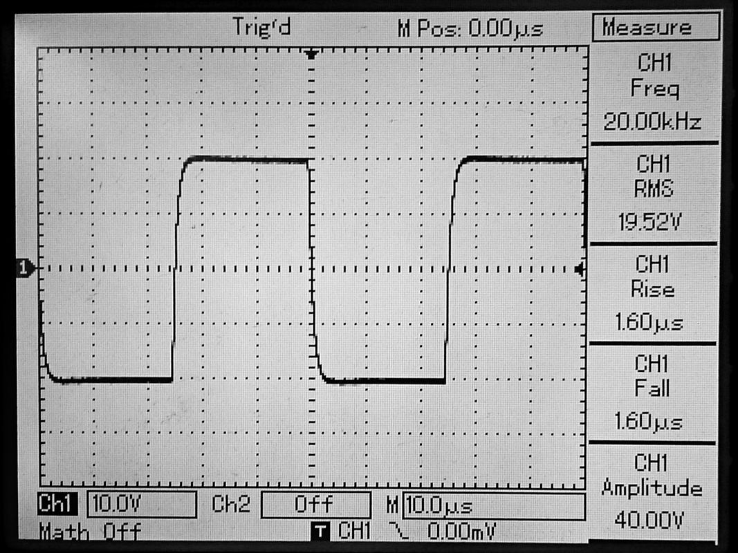

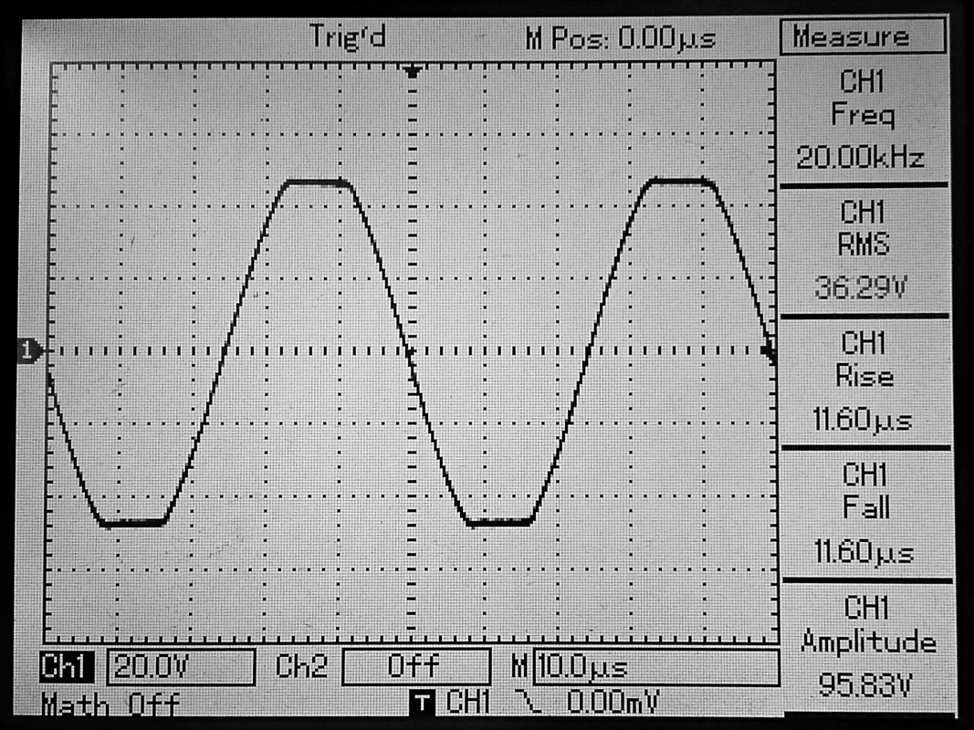

December 2016. My measurements of the early prototype - the same schematic, but the layout is a TH version of Tubsumo IPS board + NS-OPS early layout. +/-52V rails.
Some differences with the pictures above are most likely caused by the different measurement system setup - I used Lynx L22 card at that time as a hardware.
IMD spectrum is especially nice - 2-nd order component [f2-f1] dominates (green dot on the left), 3-rd order components [f1-(f2-f1)] and [f2+(f2-f1)] are negligible (blue dots on the right).
Clipping at 20KHz is very similar to the one Thimios showed.

Valery,your soundcard is a Top choice and amplifier really is a very low distortion circuit.
My measurements are just what i can measure using an Esi Julia PCI.

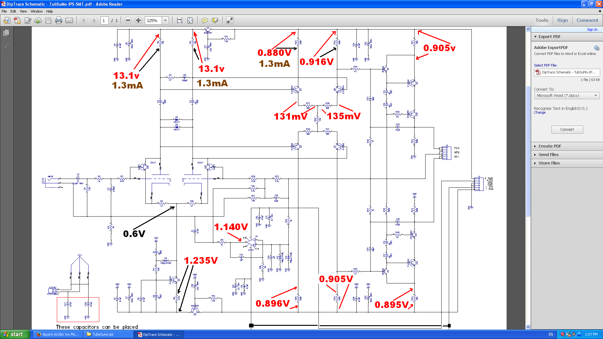

What do these FET'S in parallel with the triodes do? Do they effectively short them out? Perhaps this TubSuMo would even work without the 12AU7?
Best regards!
These boards are designed to be tube, fet or bjt input. You just install what you prefer to run.
Best regards!
They are either / or. We've got the placeholders for those jFETs on the board for those builders who'd like to use them instead of using the triodes - that's why we also have them in the schematic.
Although, my preference - the triodes (I have tested the jFET and BJT options as well).
I was slower than Jeff, heh-heh
P.S. For using jFETs, degeneration resistors' value needs to be increased, for bjt option - to be increased even more.
Ok, thanks, now I see. you had to provide them in your schematics, so that the PCB router acts correctly.
