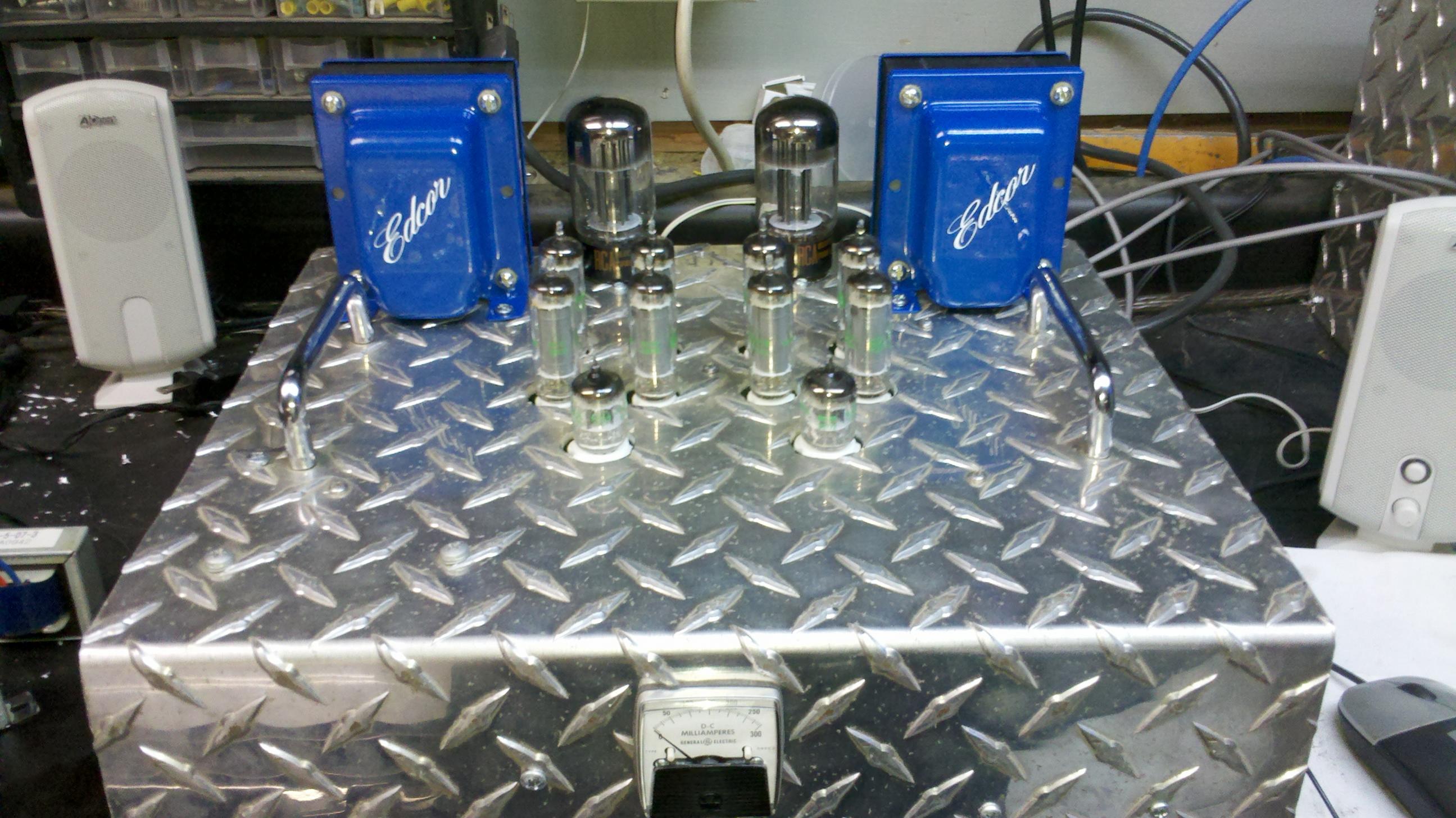

Can you pls refer me where to buy those?Here is the design I am shooting for and the progress so far (K16LS).
Mods completed:
- 220uF (450V), 220uF (250V), 100uF (250V) capacitors
- 6 Sonicap .22 uF (400V)
- 2 Silver Mica 33pF
Using lead free Cardas Tri Eutectic solder.

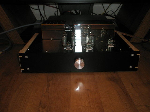

a few photos of my k-16ls build:
the only thing i'm not really satisfied with are the mid-tones, which sound somewhat murky on all the speakers i've tried. i'll have to see if there are any mods to improve them.

That is an awesome case, did you make it yourself?
thanks .
i had the top part milled at schaeffer-ag.de. everything else i made myself (from some cheap wooden fence posts bought at the local hardware store ).
