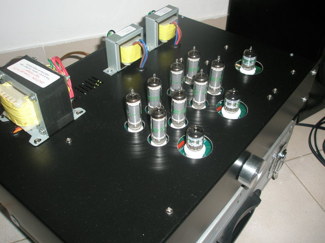

Hey Matt,
Loving the look of your amp. Especially the big chunky volume control.
How did you make the cover for the Power Transformer?
I was thinkinng of doing something similar but wasn't sure if I could take the Transformer apart without damaging it. I don't know what yours was like but mine is covered in thread lock/glue.
As the input power leads point down and the output points up its a bit of a pain trying to get the leads through the chassis.
For the Output Transformers I took the case apart and turned them upside-down.

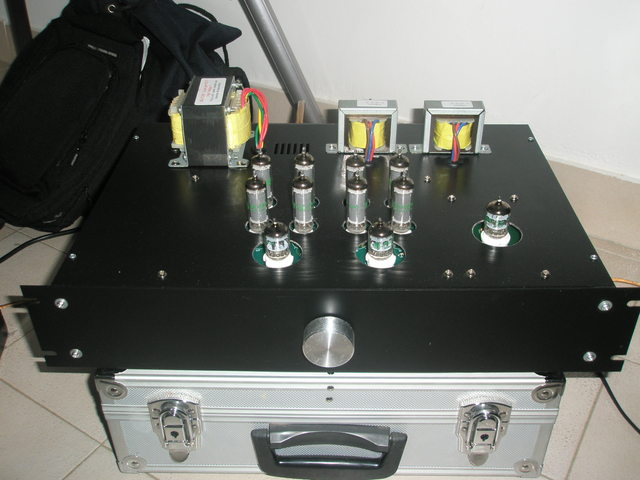

For the covers I started with some automotive steel (18 or 20 gauge, I can't remember they were just some scrap bits I found) and punched holes in the one side, used some math to calculate how much metal I would need between there and the other set of holes. Then I cut the metal to the height I wanted and punched the opposite side's holes. I bent the ends with the holes to a 90 degree angle. Then I took the 2" aluminum rod piece I made the knobs from and hand-bent the steel over it. After I had a nice semicircle I just took the long screws out of the transformer and put the plate on. For the other side a round plate wouldn't work so I had to bend it and beat it with a hammer a bit and squeeze it with a vice until it was the right shape. I replaced the bolts from the transformer with basically identical ones and bolted it together. I taped off the tops and the wires and painted the whole thing.

I extended all transformer wires except for the two output transformers Green and Black wires. They were just long enough to reach my board with the required slack. The rest I soldered high gauge wire to and heatshrunk to fill the distance. I have noticed much less noise than when using the supplied wooden plank, I think it may have to do with my EMI filtered power connector or the transformer frames being grounded by the chassis.
That being said, I connected the ground wire from the 3 pin to the chassis on the inside of the case. The EMI filter housing on the power plug grounds it to the chassis anyway but I figured I should connect the wire just to be safe.

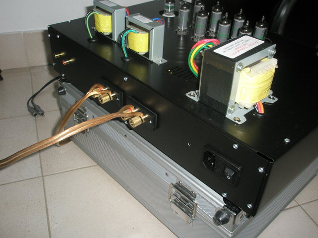

fenpark15 said:After building, troubleshooting (thanks to those who helped) and burning in of the new s-5 16 Wpc stereo amplifier kit, I want to share my thoughts for anyone who may be interested. The kit is straightforward and easy to build and comes with pretty good instructions. I decided I wanted to hear its sound mostly stock before I upgraded poly film capacitors or anything like that. The modifications I did make include:
-metal chassis
-3 prong power supply grounded to the chassis with toggle switch
-AC cooling fan
-Bigger filter caps (220 uF, 220 uF, 100 uF instead of 220, 100, 22)
-270K bleeder resistors on filter caps
-bypassed capacitors on RCA inputs with wire
-Gold-plated chassis mount RCAs and binding posts

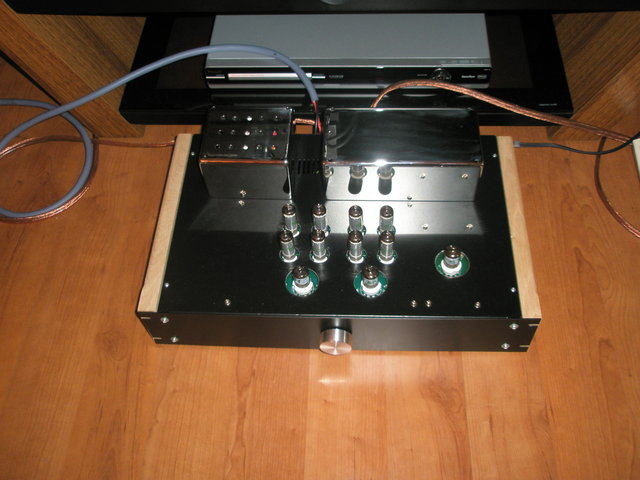

Here is the design I am shooting for and the progress so far (K16LS).
Mods completed:
- 220uF (450V), 220uF (250V), 100uF (250V) capacitors
- 6 Sonicap .22 uF (400V)
- 2 Silver Mica 33pF
Using lead free Cardas Tri Eutectic solder.
Upcoming mods:
- Stepped Attenuator - DACT imitation from eBay
- Source Selector Switch - 3 Input
- Rotary power on/off witch
- Tube Panel meters from Fair Radio
Contemplating mods:
- Power indicator led (needs DC supply, don't know how to do that yet)
- Lit up panel meter's (need DC supply too)

First time connected to the mains and everything was working fine. A bit of hum and noise but 70% off sorted with proper grounding. No smoke no bang...
Sound is very clear but not really warm. Missing bass, and mid range sounds to strong.
A bit disappointed to be honest. So now, need action to be taken to try to rectifier that.

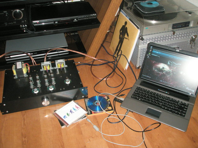

Take some time today and connected laptop to k16.
Huge noise to sorted first by disconnecting laptop from mains. After that almost complete silence.
So back to business. Used winamp with equalizer preset on techno.
Must tell you result was perfect. Clear and soft sound. So far best results without messing around with tools.
Speakers I using are mission 773. See pictures:
