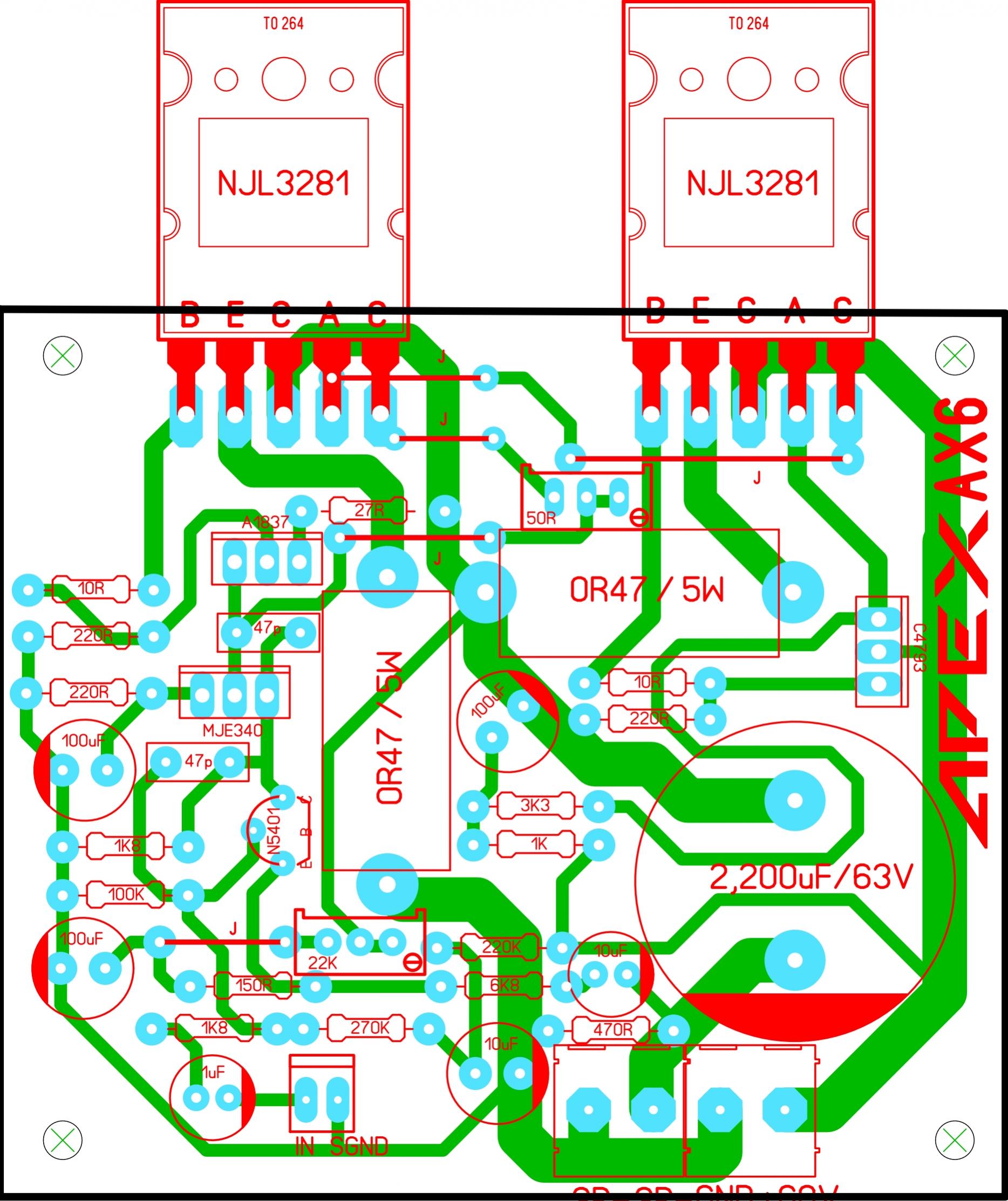

Hi Guys,
I thought it might be interesting to build this with ThermalTrax transistors and utilize the built in diodes. Here is a layout for that. Please look it over and see what you think.

Some minor power loss with .68 ohm resistors, fractions of decibel since the ear hears logrithmically. .33 Increases risk of thermal runaway. Since base board doesn't have temp sense diodes on the heat sink, probably .33 ohm not a good idea. The thermal trak variant above post 683 a good idea with very expensive parts.
I have thermal sense diodes mounted above the TO3 transistors on a remote heat sink, since the on board TO3 of base layout are located for wimpy degC/Watt rated heat sinks. Thousands of hours on my AX6 with .51 ohm emitter resistors with no problem, but I have fans on the heat sink.

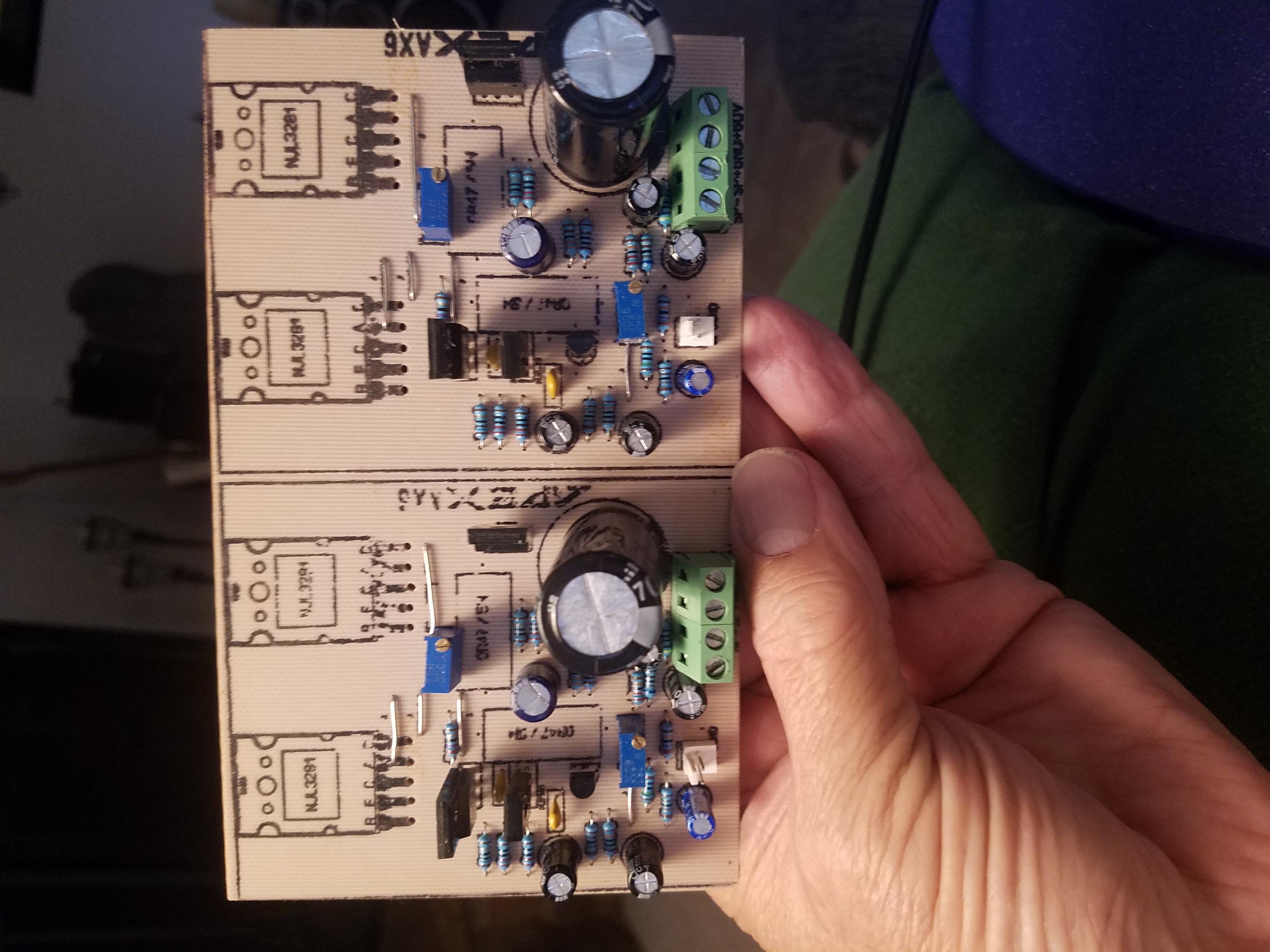

I got it figured out. I had some 1R/2W resistors so I just hooked them up in parallel. It is all populated but I will wait until tomorrow to begin the testing. I will have to work up a PSU. I have several PSU panels that I should be able to just ignore the center tap and use the + and - outputs. I have a 22-0-22VAC transformer that should net me about +60V-0VDC output. All I had for output caps was 4700uF/50V so I don't want to push it too hard.

50 volt output caps are fine for 60 volt rail. They will see 30-ish volts of DC. Could be up to 60 if the output heads for the rail due to a fault, but a 50 volt cap will take that for a while if there is no ripple current to speak of. 35 volt cap might be iffy of you count on it for speaker DC protection.

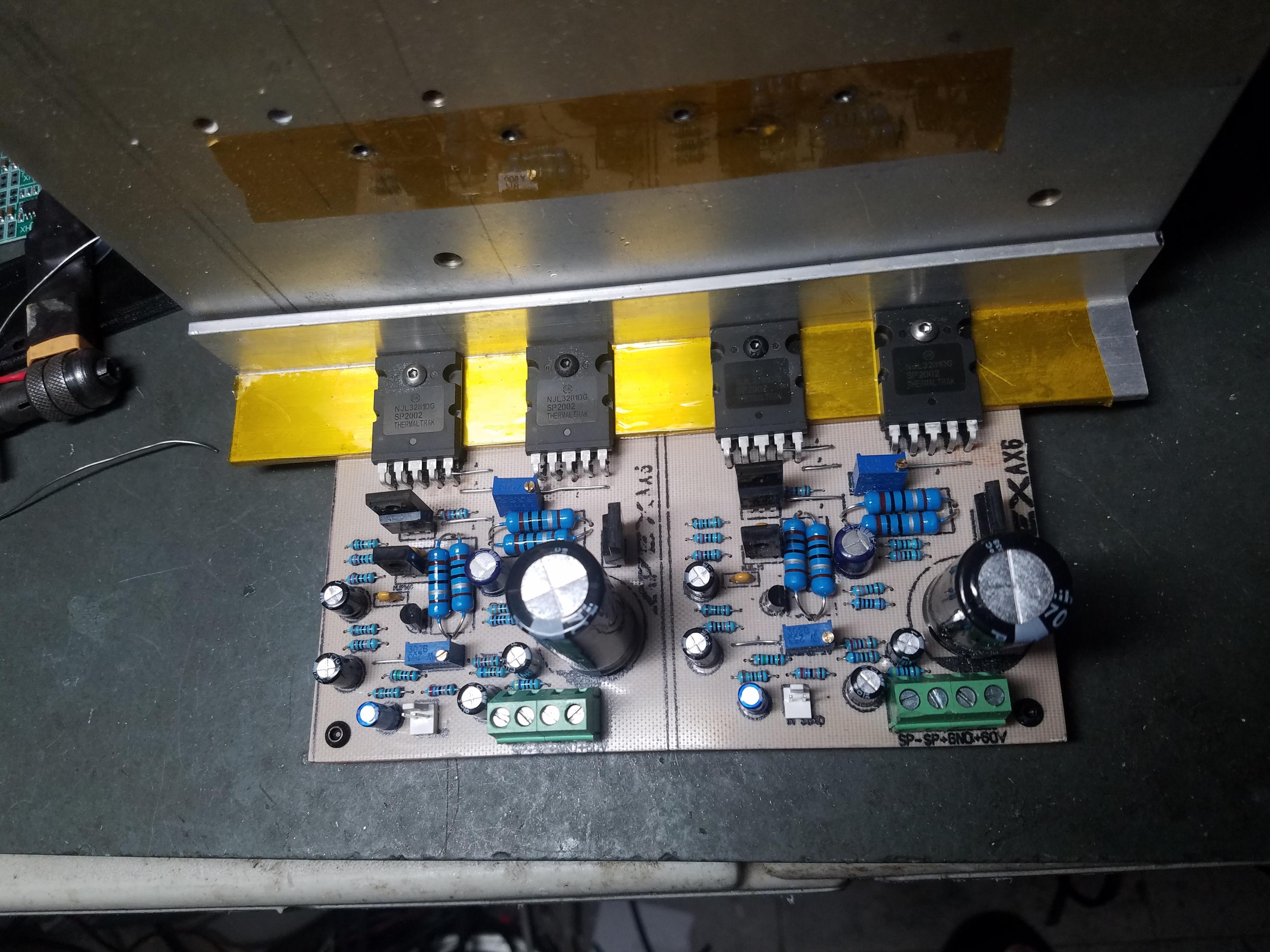

Ok I got it on the bench. Testing at +50-0VDC. It will play a sine wave but I can't get the bias to come up at all. It is pure class B right now. Even with the pot adjusted to 0R it still has no bias. I'm not sure if the voltage drop across the two diodes in the Thermal tracks are too much compared to the 4148s. anyone have a thought about that? I didn't try shorting one of them maybe I'll should give that a try.
I've had to use 2 diodes series a schottky to get bias up. Pot parallel one of the diodes. Diodes were salvage rectifiers, generic 600-700 mv test voltage. 1n4148 tend to run more 750 mv. I'm using white box (NTE) mj15003 OT.
You can parallel the extra diode with a pot. If the wiper opens up due to old age, bias goes to zero, no damage.
BTW I like the look of your thermo trak build. Nice transfer of heat to a substantial heat sink with angle. I envisioned the original build with those individual Avid TO3 heat sinks with the 2 cm x 1 mm fins all around.
Oposite, bias is maximum with pot adjust to 50R, and will rise with voltage on diodes... If there is no bias with 50R pot use 100R pot.
I got one board working. I have it set to 160mA. The trimmer is set to 113R. Outputs are just warm and it sounds better there. The bass is a little flabby but that may be because I'm feeding it with my phone. Tomorrow I will get the other board sorted and then feed it with a CD player. I put it on the scope. Sine waves look fine but not square waves but again, that is using a wave generator app from my phone.
No wonder. To get any bias at all, the voltage across the bias diode string has to exceed three Vbe's in this quasi complementary design (both drivers' plus the upper power device's Vbe).

Hey Guys,
I got it working. It needs 200R trimmers in the bias to get it to work. I think they are set and about 120R right now. That gives me 70mV across the pair of 1R resistors in parallel or about 140mA of bias. The outputs run just a little warm. I am running it on +63V-0V. Seems very happy there. Forget what I said about the bass being flabby. It sounds really nice and warm. Cool little amp.
