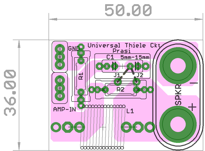

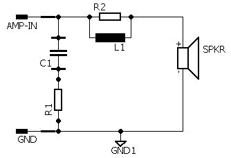

Zobel was actually an after thought , pcb was almost done by then. so incorporated whatever packages i could fit. If one wants to retain the amp by building a case, then one could add the thiele ckt (zobel + inductor) at the speaker terminal, as I very much doubt there will be ver 2 pcb.;)
I have a very good design posted somewhere, here it is again. J1 is default.
regards
Prasi

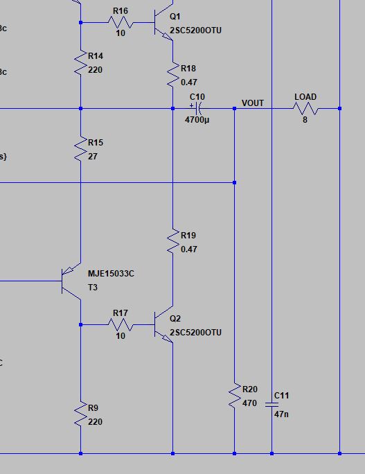

With quasi output stage, used here, you can never have ideal bias because upper driver/output pair (Darlington) requires different bias from the lower pair (Sziklai). It requires separate bias circuits for upper and lower pair. In the old times it was usual to set higher bias that suits upper pair. It's irrelevant weather you will use 10mA or 50mA because for optimum bias upper pair requires 200mA and lower 10mA.

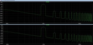

I wonder if these issues could be solved by the following mods:
- Swap R19 from Q2's emitter to it's collector lead.
- Tie R15 to Q2's collector, make it 100R and connect a Baxandall diode in parallel with it.
Best regards!
Hi Kay,
Wondering if you can please elaborate on this one?
I am putting your suggestions into the sim to see what happens but not sure of the connections for this part..
Would you be kind enough to annotate the attached screenshot?
Thanks!!

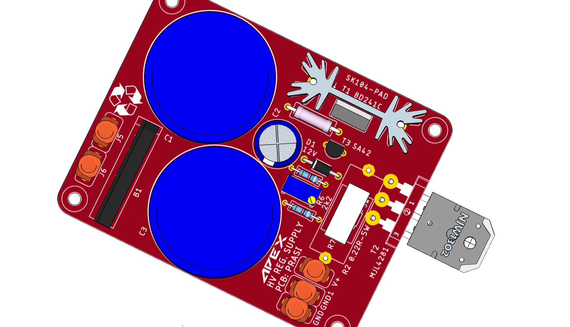

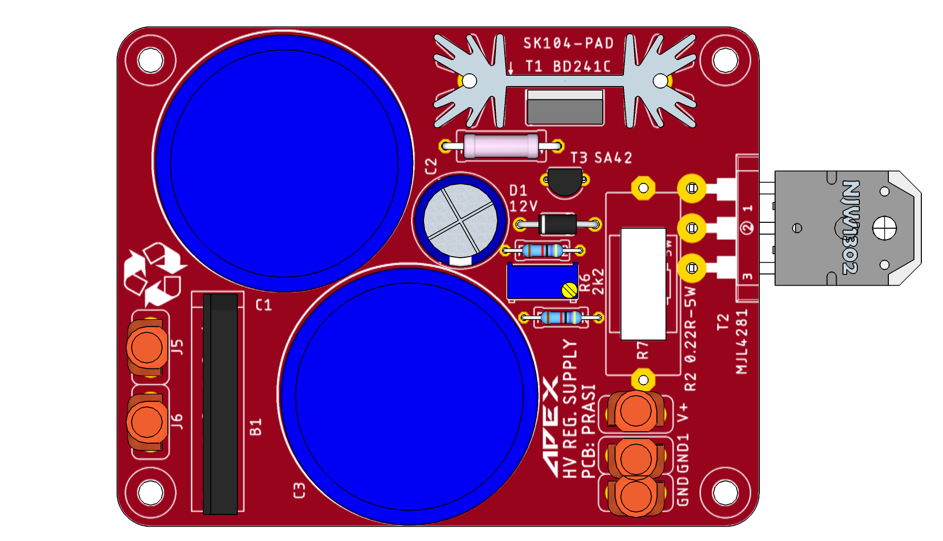

Hi all, can I ask what PSU setups your using?
Prasi, would this Retro Amp 50W Single Supply be something you might consider doing?
It would be great to have a high voltage adjustable regulated supply for this and other amps. Maybe this has already been done.
:D something along these traces?
regards
Prasi
Best regards!
Kay,
Of course that Baxandall diode solves this problem and shows how great engineer he was! I did not want to complicate things with such info when the PCB is already done but implementing this mod would make this amp even better.
Of course! Make R15 100 ohms, disconnect it's upper leg from the output bus and connect it to Q2's collector (downside of R19). Then get a 1N4004 (or something like that) in parallel with this resistor, cathode to T3's emitter.
I'm curious of your sim results!

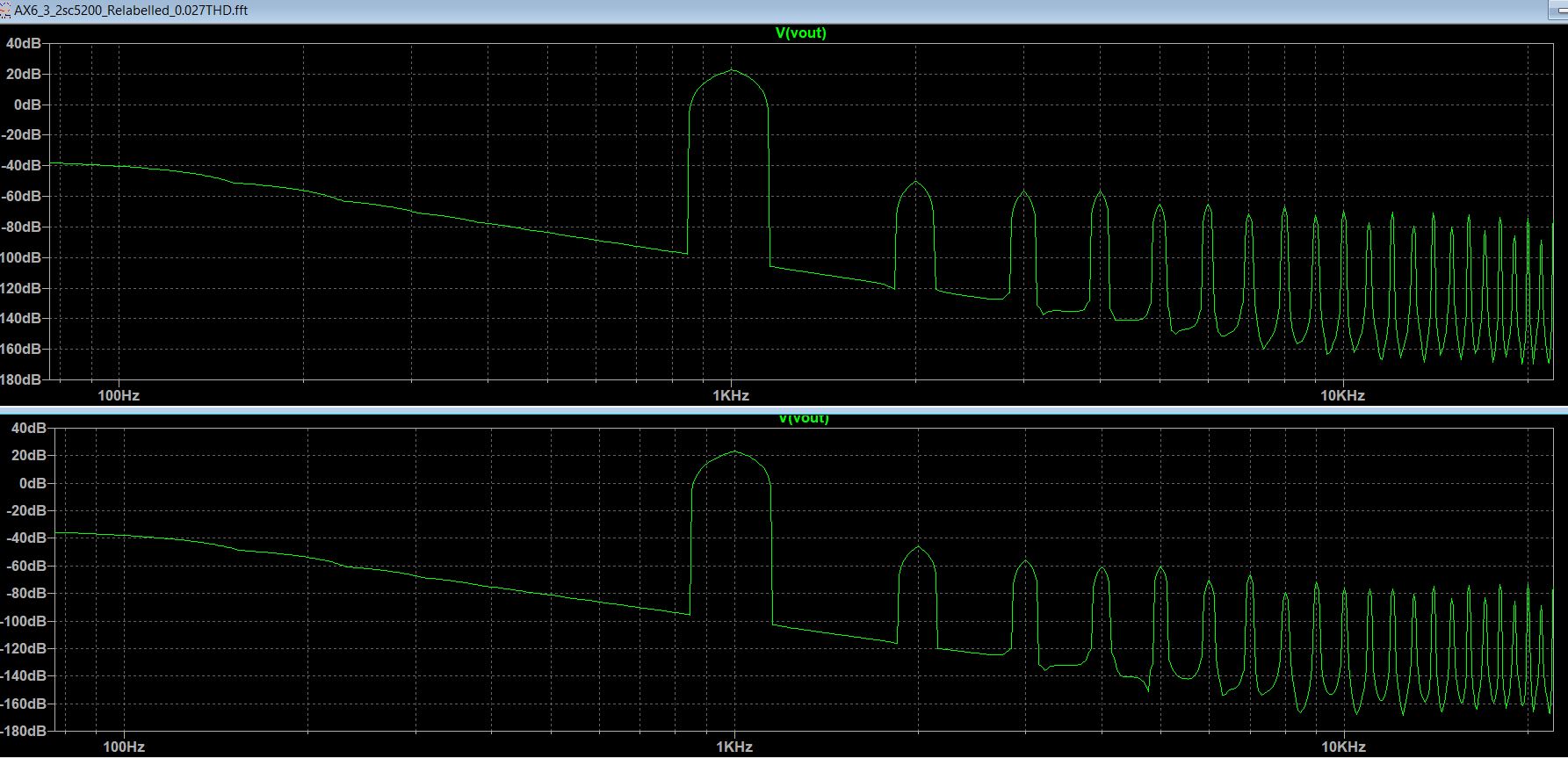

Here we go, screenshot of the FFT and sim file to play with.
Top window is for comparison - this version uses 2SC5200 outputs, has 15K in R5 for voltage centering and 3k6 in R6 to reduce gain to around 25. The comparison THD is 0.027, the modded version is 0.0364.
There is a bit of spikiness to the FFT with the mods but I don't know enough about spice yet to know if it is a good or bad thing :)

Thanks for that Simulation, avtech23!
If I get it right, I'd tend to say the following:
- The modification as suggested by me does little or nothing.
- If we look closer, even order harmonics are decreased, odd harmonics are increased a tiny bit each.
So I tend to recall my suggestion ;-).
