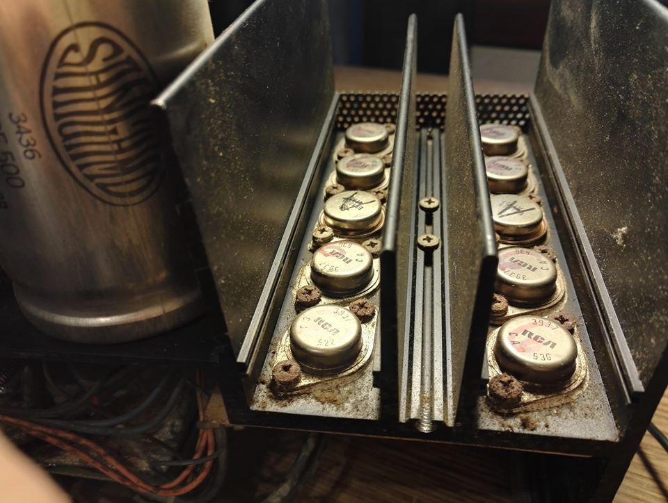

Finally I found one Amcron (Crown) DC300A too, which I have been looking for a long time.
This one is all original. Marked RCA outputs, Sangamd filtering caps etc.. a little bit rusty transformer.
Well I had to test it without opening up (a bit of cleaning done before that), just to see how it does (knowing it is very risky!).
One channel working like a charm, other one distorted.
Checked bias, which was missing in faulty channel. Soon I realized there was defective biasing transistor MPSA93 (no connection beetween B-E).
Well, I didnt find exact same type so I took 2N5401 which seems to be "close enough". This transistor has to be high voltage type.
Bias problem was solved and it is spot on (according to service manual).
After that, I just fine tuned DC offset and put speakers + input source. Wow, everything was working! Filtering caps seems to be just fine, it plays many seconds after mains switched off.
Sound quality wise, I cant find nothing to blame. Lows, mids and higs no problems, no harshness at all (except with Alpair 10.3's which has harsh treble anyway). And I have dozens and dozens of different kinds of amplifiers.
Very good bass control I have to say. Amazingly good work back then when this amp was designed! Well done. This amp does exactly what it was supposed to do without any flaws I can say, provided it is in fully working condition. No hissing, no hum at all.
Surely I will change all the electrolytics, zeners etc.. just in case.

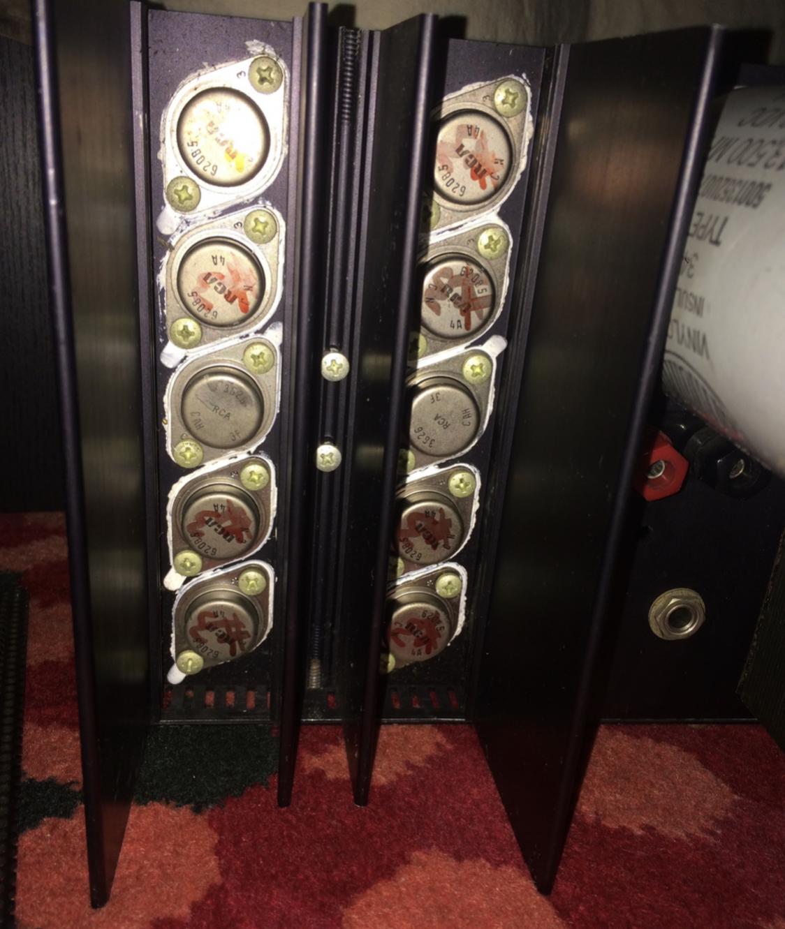

Hi all,
I've already opened a thread but unfortunetely I could not get any answers.
Let's see if someone here can help me
I'm refurbishing my CROWN DC300A and I need to replace the output and driver transistors.
In my crown I have the following (as in the attached picture Crown_transistors.jpg):
- Outputs : RCA 62085
- Drivers : RCA 3626
I've been searching around the forum and I've seen people using MJ21194 for the outputs.
However for the drivers, I did not come to a conclusion which ones would be the best.
I know some people used MJ15024 for the drivers, but while the amp will work, distortion and oscillation will be the end result.
Can someone help me?
And since I'm doing this overhaul what other critical components would you recommend to replace?
Thanks in advance

DC300A is designed to produce DC on output. If you have a diesel motor and want to control rpm by hydraulic demand, it is just the device to move the throttle actuator. If you have speakers, this is the wrong thing. As posters previously noted, if the silver migration doesn't get you, oxidation of the zero pot will. they will mysteriously & suddenly produce large DC voltage on output.
This was the amp to have about 1973 for big stage shows. By 1980 the Peavey Cs800 was out, also with 5 pairs output transistors. I was cruising those on ebay this week and those are still going for $2-400. Worth it IMHO, great schematics on line, semiconductor cross table, everything. Worth repairing.CS800 will only go DC out if you have toasted an output transistor. I just upgraded a CS800s with new AC mains caps. As bands have sluffed CS800 rev A,B,C, X, off for class D trash because of the 70 lb weight, your local repair shop might have one they are using as a doorstop. Make him an offer. X & S suffix have a DC detect & disconnect relay internally. A,B,C have a DC detect crowbar triac.
My speakers cost $600, and now that the burglar got them, the next ones might cost $1200. No DC producing amps for me. I don't have an electro-control diesel engine to use one.
About the drivers. Drivers need to be faster than output transistors. In the PV-1.3k Peavey used MJ15020-21 as drivers. Ft 20 mhz. They don't make those anymore. They do make plastic MJL1302-3281. 30 mhz.
