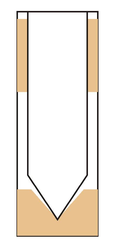

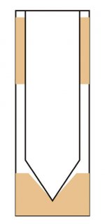

Would this be a good idea for TD-124 bearing? We can discard the bottom bush so we will have less surface area (less noise). And replace it with precision conical bush which holds conical shaft.

The original using the single ball relies of the cup hole being in the middle.
If this is in the middle then the ball rotates on the contact point.
That is virtually noiseless, i.e. no rumble.
But we know that rumble is never zero, so that confirms that the hole is not central or there is another rumble mechanism.
The pointed cone is nearly impossible to make concentric.
That is virtually guaranteed to trace out a small circle as the shaft rotates.
This would be equivalent to an off centre hole for the left diagram.
I consider this version to have far more rumble.
And will have the other rumble mechanism as well.
The ball version can be rejuvinated by replacing the ball or moving the ball onto a new contact point. I'm not sure how you arrange that?
A worn spindle&cone is scrap.

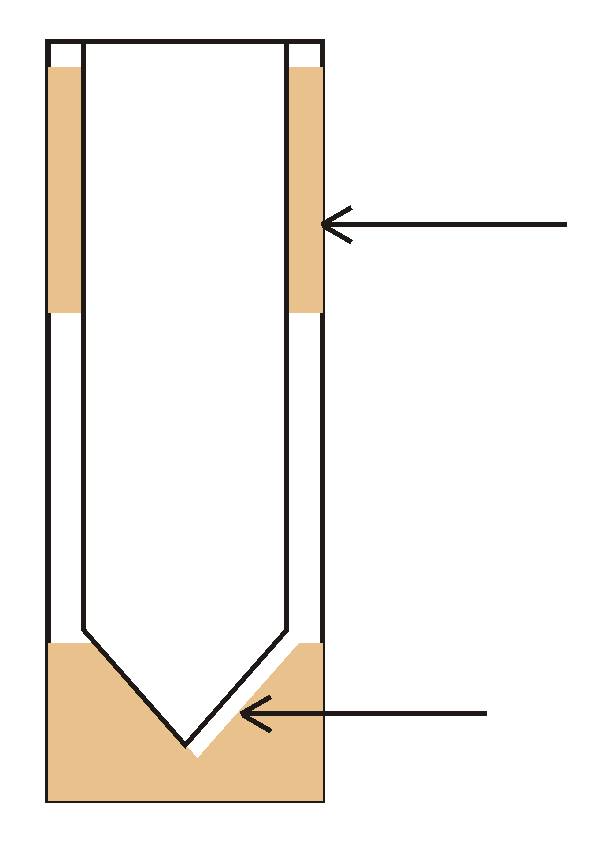

OK. Don't know why a precision conical shape can not be made. But if shaft is perfectly center and perpendicular. the conical shape would self align. Will it not ?The pointed cone is nearly impossible to make concentric.
Even if one considers it to be little off center as shown in the picture (exaggerated) the movement at gap at the bottom will be restricted by that particular side of the bush.
