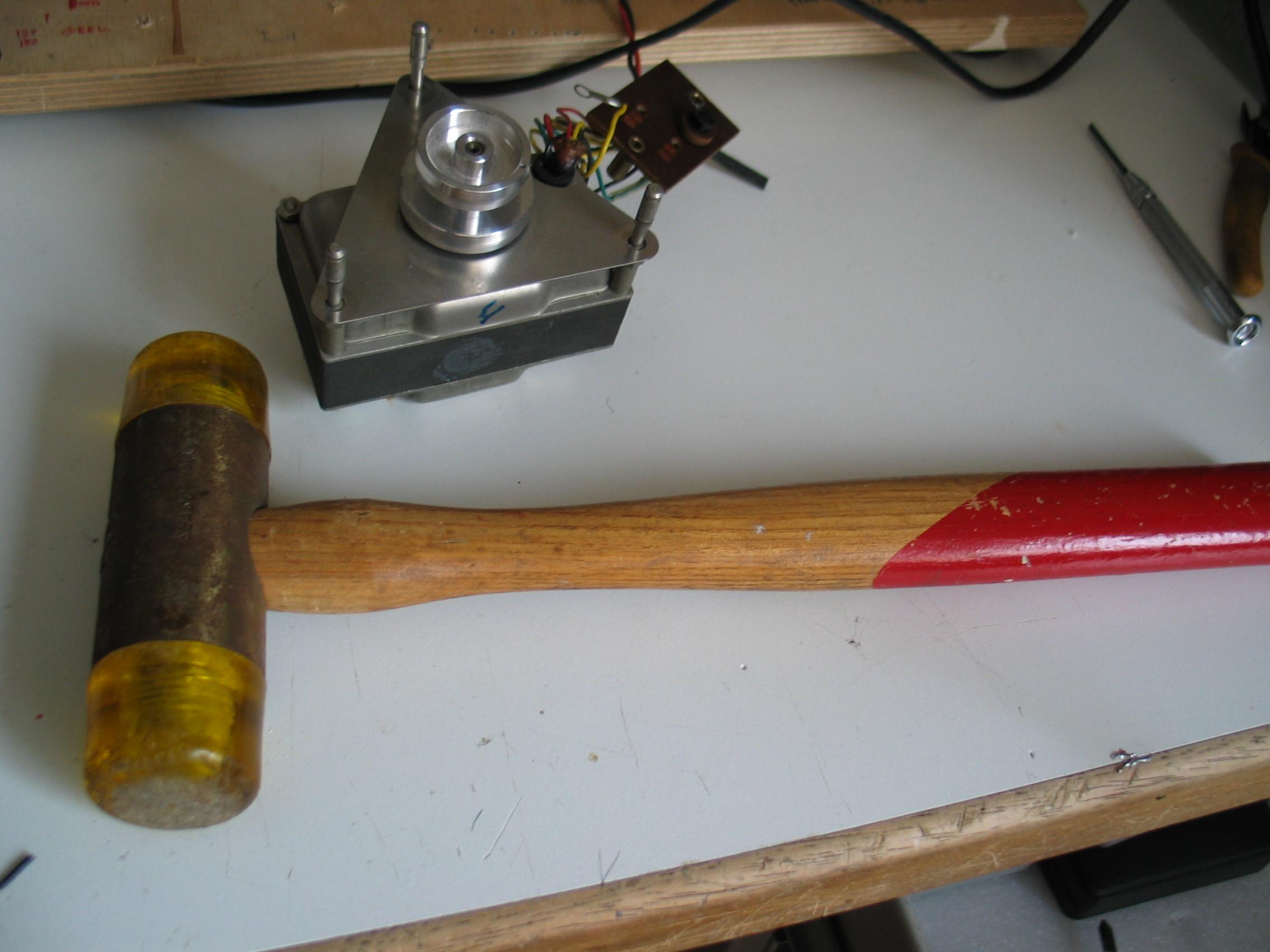

This is just the motor attached to the chassis. The pulley isn't attached. Would this make a difference?
Shouldnt, does the motors armature spin by hand easily ?
Are the 4 motor screws snug ? Have you loostening the motors screws and slightly shifting the motor case halfs ?

I've let it run for a half hour and then tweaked the halves. Pretty quiet now though I haven't snugged up the bolts. Not sure if the heat has expanded the bushings or what. I think it was Steve who mentioned the motor should spin for quite awhile after turning off; mine stops after 5 seconds. Should I call it good for now?

I would let it run for a while, see if it remains quiet. your going for as silent as possible.

Did you clean the bushings? Soaking the felts is not really enough in my experience. Usually I remove and bake the bushings to drive out the old goo, and then I put them in hot 20 wt oil and allow them to cool down to room temperature. The kit is a fairly good investment as get you a tight set of new bushings, a ball, the felts, and the hardware required to reinstall the bearing assemblies.

No, I haven't. Before coughing up the cash, do you know the drill size and hardware specs for the rivets?

A runout time from 5 sec.indicate worn bearings after revision it should be 15-20 sec.min !
My own motors turn about 25-30 sec. after shut off.

Couldn't this also be related to misaligned bushings?

No best is to replace bushings ,pivotplate,vilts, and ball and polish the rotorshaft
For aligned the bushings I use the special tool on the picture !
My tool of choice too. You will be glad you did the rebuild.
