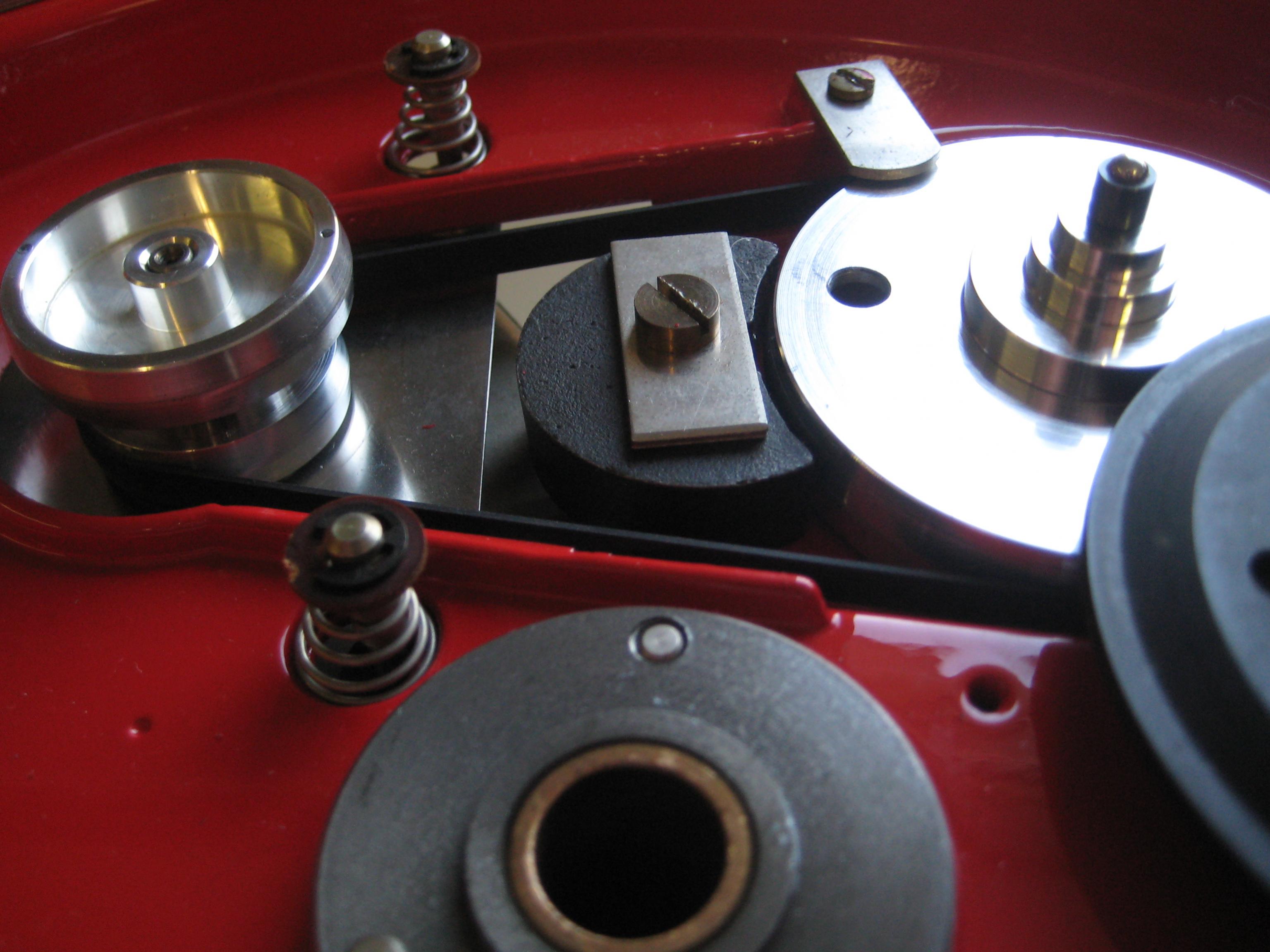

I fill to just above the top of the bottom oilite bushing, this seems to avoid oil slicks on the chassis until the next time you pull the spindle. I like to run the spindle wet, and ideally right up to the upper bushing. As you know overfilling results in oil everywhere you don't want it to be.. lol
I should note that I have aftermarket endcaps on both of my tables and used RTV blue on both sides of a new paper gasket in order avoid blow outs when inserting the spindle into the oil. Some of the oil flows in the space between the spindle and bushing and some through the bushing itself.

I have generally had to run mine with the magnet about 1mm from the step pulley on both tables, changing to 30wt oil in one so far seems to have allowed me to both open up the distance to about 3mm and not set the brake for near maximum drag.
I am going to do the other one shortly. Note that this seems to be a win on several levels as the much noisier basket case 124 while not silent, is much quieter and this seems to have improved its reproduction quality without adversely affecting the energetic presentation I like about these tables.

Mine are all good, either new European made oilite or the original low hour bushings in my 124/II.. The bushings sold here in the US don't seem right to me - too loose in the bore and too much clearance spindle to bushing.
There's been a lot of discussion about how much oil to put in the housing. When I disassembled my TD-124/II originally there was oil in the housing to near the top of the bottom bushing. Knowing the owner it is extremely unlikely that she ever touched or did anything to the table. It was essentially an extremely low hours time capsule - even the Stanton cartridge on it which was newly installed around 1970 was still ok. (My understanding is this table was purchased around 1968 along with a very high end early Japanese solid state stereo receiver - which was also absolutely mint and in perfect working order.)
I've tried running with minimal oil in the housing, but prefer running it filled to just the top of the first bushing more or less as I originally found it.

The Oilite sleeve bushings I've been buying (McMaster-Carr) tend to have correct operating clearances. Over the past 5 years I've purchased something like 10 bushing sleeves from McMaster-Carr. I measure these before installation using Mahr gages for the Id and outside micrometers for the OD.
I've observed it typical that there will be .001" of press between the housing bore and the sleeve OD. But these bushings press in with moderate pressure due to the very soft material properties. I've also observed that the sleeve ID will shrink .001" once properly installed into the housing. And this results in a useful operating clearance.
I suspect that McMaster is sourcing these bushings from Oilite in the UK. But can't prove it. And it may be that the quality of their supply might vary from one batch purchase to the next.
One thing that may be scary about trying the McMaster sleeves is that their table of tolerances for these shows a rather large amount of tolerance. More tolerance than is proper for this application. However, in practice, I've seen that my samples have been held to very close tolerances to nominal (wanted) sizes. (.001" press on the sleeve OD and .001" extra clearance on the ID, which takes up after installation.) The samples I have had here all check within A few tenths (+/- .0003") of each other.
