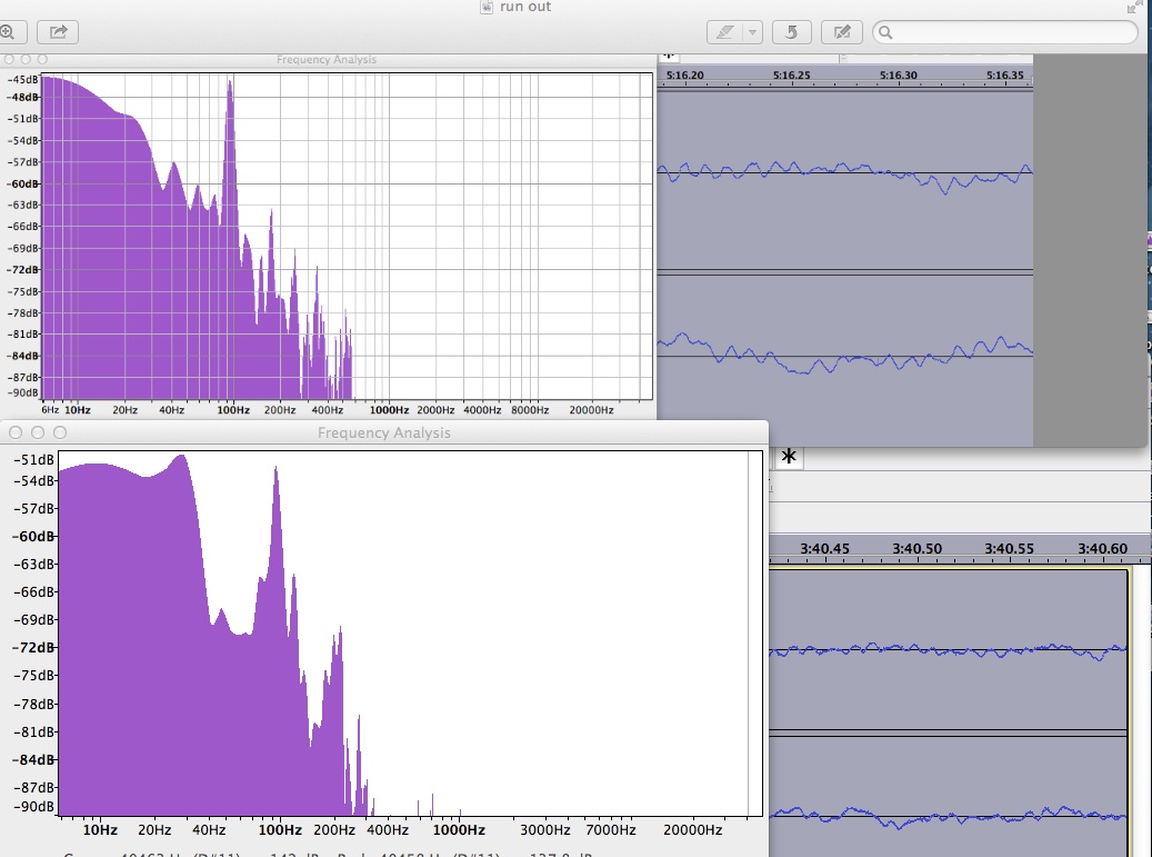

Idler bushing replacement - Before/After charts
In the first pic, the top waveform and spectrograph were taken a few weeks ago, prior to yesterday's replacement of the idler wheel bushing. The bottom was taken this morning. Both represent a small segment of the runout, side 1, John Coltrane Quartet - Ballads. Rumble filter on the pre-amp was engaged (hopefully one day that won't be necessary, but it's how I've been grabbing charts so need to stay consistent for now).

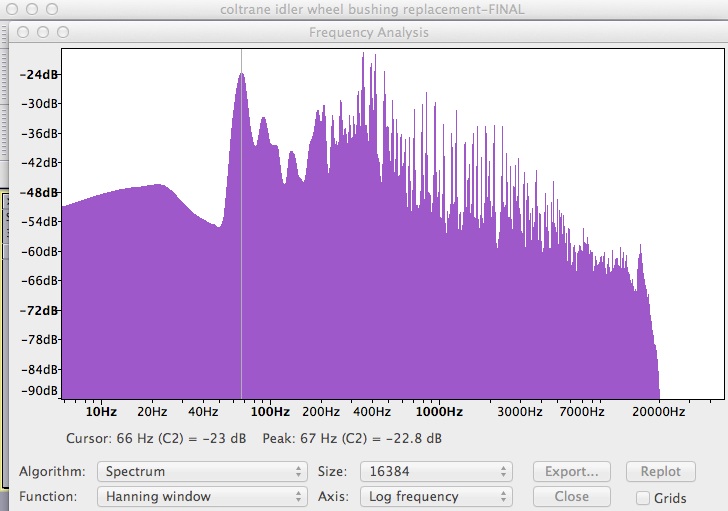

For reference, the second pic shows a sample of track 2, also taken this morning.
I'm not happy with the new idler bushing, though it clearly is making an improvement on the low end. It will be getting replaced soon as the new one arrives. I'm also aware that the stepped pulley bushings are sloppy, so those will get swapped out at the same time. Once I've made those changes, I'll pull another set of charts.
