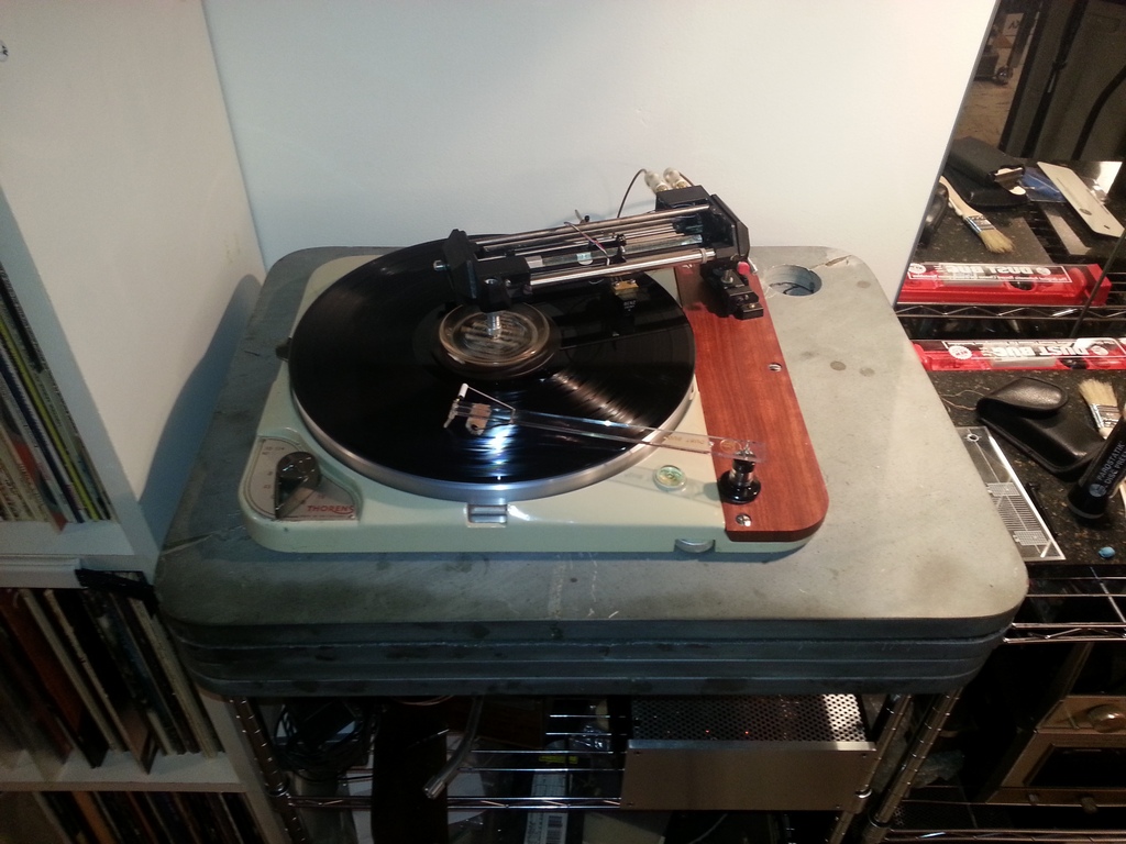

Today I installed one of Mirko's extended main bearings on the MKII.
No measurements to share, I'm not sure I could make meaningful measurements relating to the differences I am pretty sure I hear between a well fettled OEM bearing and spindle with a modified aftermarket end cap and the extended bearing.
This bearing and spindle is about twice the length of the stock assembly and was I believe built to somewhat tighter tolerances than the stock bearing. The upper bushing is substantially longer, but I can't tell how much longer.
It's all very nicely machined and finished.
Drag is substantially higher which means that I was able to back off the eddy current brake to the extent that it no longer generates any significant noise.
The bearing is very quiet, probably a few dB better than the OEM in tip top shape.
I can't put my finger on it, and unexpectedly this bearing seems to result in a pretty substantial improvement in sound quality - it just seems more focused, more detailed, bass is tighter and better controlled than before. Imaging is positively impacted as well.
I was not expecting to hear anything at all and I apologize for the subjective comments as I have nothing objective to pin them on.. I can only conjecture that the longer bearing contact area couples the platter to the chassis better, and the tighter tolerances result in less modulation by the platter precessing about the center of rotation. Perhaps the bearing noise spectrum is different/reduced amplitude. I don't have any method currently for determining this.

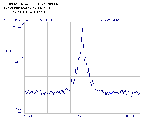

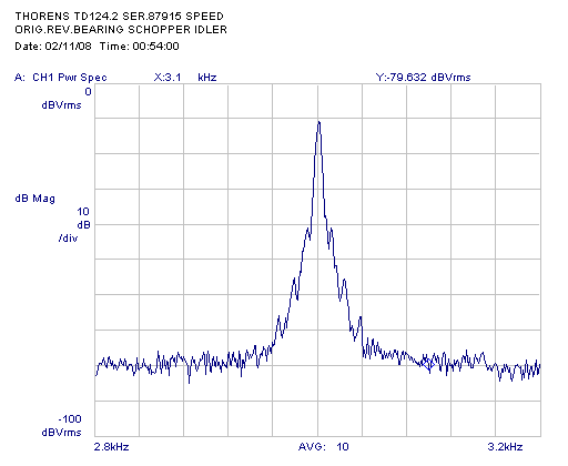

Here are three speed FFT measurements done on the same turntable after revision .
First with original bearing
After revision old bearing with new sinterbushing better speed stability sharp peak.
New Schopper Bearing , very good speed stability almost perfect peak .
I think that is the Mirko bearing that STS sources from him.
Kevin, does yours have the heavy duty end cap as well?
Yes indeed, and unlike most of the aftermarket end caps you don't have to remove it to install or remove the bearing assembly.
Hi Kevin,
Just curious . . .I see that you mentioned using a linear tracking arm and was wondering what you were using. I remember that you were using a Schick/SPU combo at an earlier point. I have been intrigued by the TransFi Terminator arm, but haven't moved on it yet. Thanks.-Robert
Hi Robert,
I have two Souther Linear Trackers, both are heavily modified; one is a very well used Tri-Quartz which was the last and fanciest iteration IIRC before Clear Audio bought Souther, the other is a NIB SLA-3 which is very similar but lacks some of the improvements of the TQ. These arms are ancient (30 years old) and now fairly rare although they do show up from time to time. Mine were made right here in Massachusetts. I make my own wands and counter weights and try to match mass within reason to the needs of my modern cartridge. There are pictures elsewhere in this thread, and I created a thread dedicated to them although not au currant with the most recent mods I've done to these arms.
