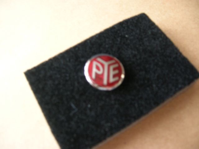

I must show you this I just acquired it..its about the size of a 5p with mounting screw..
Regards
M. Gregg
