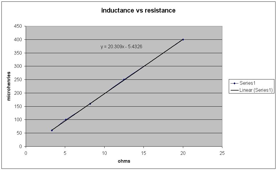

Finally put the software in to convert.
Here's the plot of inductance vs resistance.
John

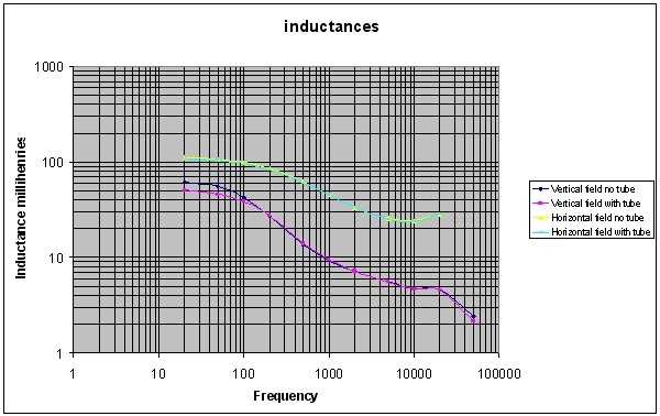

Strangely enough, nobody within that discussion answered the op's question accurately. The question was.."why at two different frequencies, did the inductor measure differently, hf inductance being 21 times less than the 1Khz measurement."
The inductance being measured will certainly go down with frequency. That is because of the eddy currents within the core. In addition, the parasitics will begin to play more of a role as the core reacts differently at the higher freuencies.
I encounter this problem all the time at work. While the magnets are destined for use at DC (with some low level capability at 100 hz), it is not possible to measure the DC inductance. So I have to run a plot, and extrapolate to dc.
With room temp magnets, the iron dominates, even if it's laminations. With superconducting magnets, a copper support tube or aluminum heatsheild will cause the inductance at 100 hz to measure low. Eddies.
Here's a typical room temp magnet; note the drop in inductance as frequency goes up, and the laminations are less than 1mm in thickness. The magenta and blue graph will of course, merge as frequency goes further down, I just didn't have a meter capable of below 20 hz operation. But the effect of the inclusion of the metal with it's eddies is clear.
Cheers, John
ps..oh, btw. the horiz field is a different magnetic path, so does not have as much iron within the flux path..that is why it does not drop it's inductance quite as much as the vertical. It also doesn't see the same cross section of the "tube" I put in it's way as the vertical, so the horiz inductance doesn't change as much as the vertical one. The vertical flux is normal to the aluminum beam tube, horizontal is tangential.
